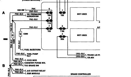

LJWSPOON
Engine Mechanical problem
1989 Buick Lesabre 6 cyl Two Wheel Drive Automatic
I have replaced spark plugs, wires, starter, and ignition kit and it only turns over.

INTERNETMECHANIC
  • 700 POSTS
Have a helper crank it, while you visually check for spark at the plugs. Spark everywhere, use a gage and check fuel pressure. Any applicable trouble codes?
When you say, ignition kit, your not talking about some aftermarket thing? If so, I can't help you.

LJWSPOON
I BOUGHT THE IGNITION PACK WITH THE 4 WIRE HOOK UP AT THE BOTTOM, BUT NO I STILL GOT NO SPARK, AND I OPENED THE GAS CAP AND PUT MY EAR TO IT WHILE HE TURNED THE IGNITION AND DID NOT HEAR ANYTHING.

INTERNETMECHANIC
  • 700 POSTS
There may be some fuses in the area of lower middle of dash. Use a voltage tester, see if fuses are ok, and that fuse circuits are hot. As you can see fuses 6& 7 supply primary voltage to ignition module--fuel injector/s-- fuel pump relay. Those circuits go hot when you turn on the key, if no voltage may have to check feed to and from ignition switch.
https://images.2carpros.com/forum/automotive_pictures/512072_lesabre_relay_center_1.jpg
