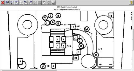

Someone suggested changing the crank sensor.
What do you think? Where can i find that on the car?
Thanks
Aug 26, 2009 at 3:27 PM
  • 75,992 POSTS
Its on right side of engine block behind AC compressor see item E below
https://images.2carpros.com/forum/automotive_pictures/12900_cps_22.jpg
