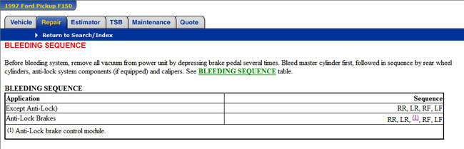

When you say you left it open and pumped the brakes. Does that mean you left the bleeder open and pumped the brakes? If so, you were pulling air back in. You need to hold the pedal break it loose and then tighten it, then pump them up.

Hey Kenny, yeah but actually when I was pumping the brakes the tube was into brake fluid, so didn't think it could suck air if in the fluid. I actually had a friend stop by and just bleed it the old normal way with two people, got everything bled even the RABS valve. But still not much brake pedal and basically when you start it, still goes to the floor. Went to the rear brake shoes and making sure that they`re adjusted okay, but still kind of at a loss. Did adjust rear shoes out some more, bot doesn't seem to really be working much better.

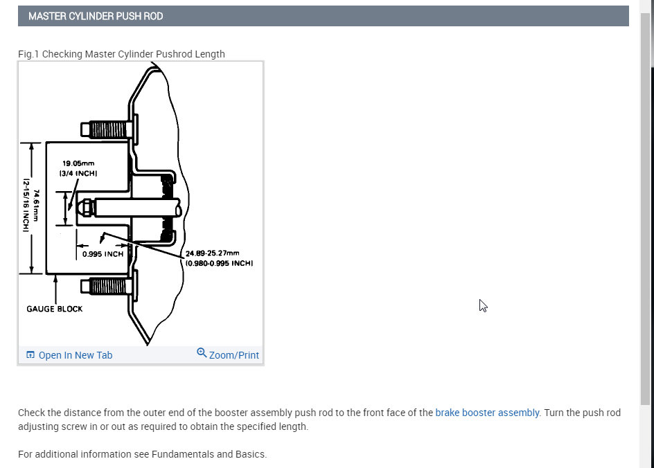

Okay. Today friend stopped by and finished adjusting the rear brakes. Have a little pedal, he mentioned to adjust the brake rod that goes into the master cylinder to get more pedal. What is your thought on that? before I do it.

This is possible but I have never had to do that. I attached the process and is worth a try.

Okay, I'll give it a try. Just wasn't sure if I should try it or if I could make things worse. Keep you posted and if this doesn't do anything I'll get my bolts and start that process.

Well Kenny, I tried adjusting it out a little and basically it may have made the brake pedal a little harder while it's off. But when you start it still goes to the floor. Just trying to figure out what needs the truck to run, to work? Don`t know if there is anything electronic? Or if the booster not working? I guess I`ll need to get to the hardware store for those bolts and basically start from there.

Yeah. Unfortunately that is the next step. The fact that the pedal is hard with the truck off and goes to the floor shows the booster is working. Basically the booster is just there to assist you in pushing the pedal. It makes it easier.
