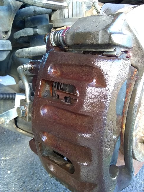

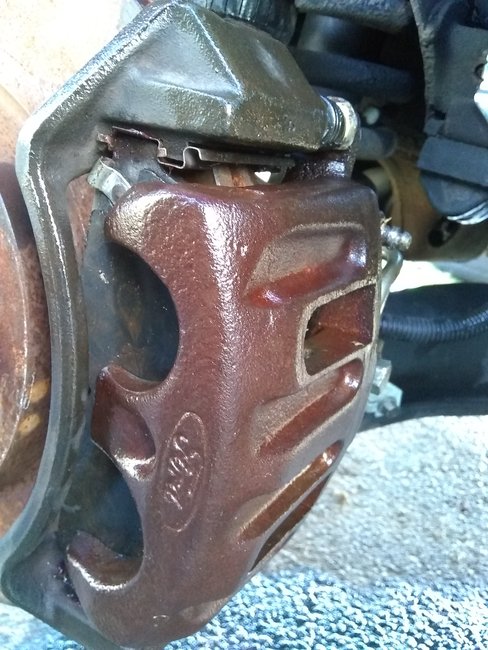

Okay the driverside front brake has got a lot of drag on it. Just turning it by hand was kindve hard.
Mar 10, 2021 at 3:22 AM
(Merged)
Welcome back Chad,
Open the bleeder on the caliper when the drag is on it and let me know if the drag goes away.

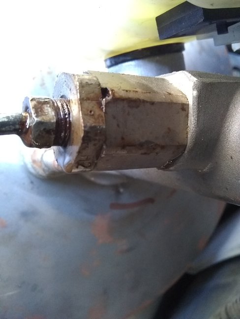

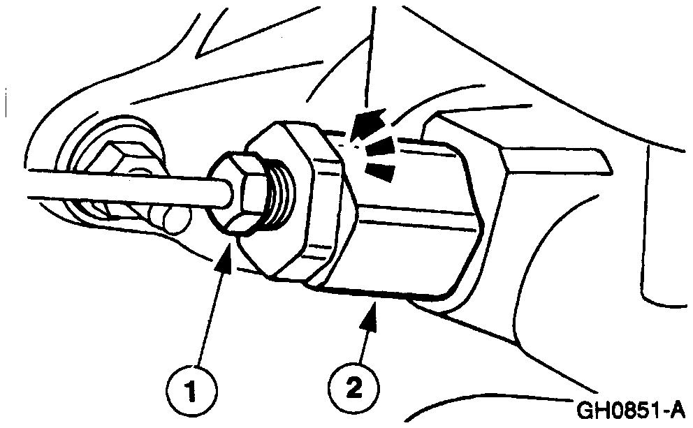

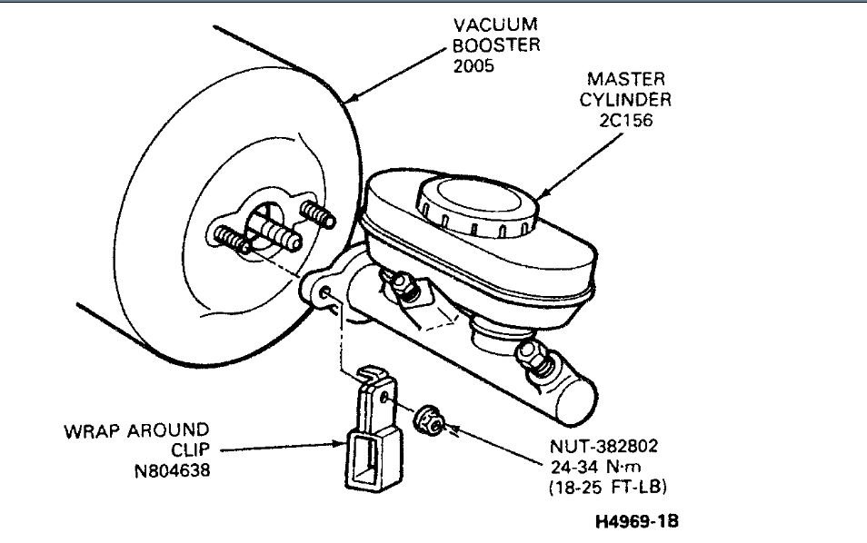

On the the push rod adjustment diagram which is the 1 and which is the 2?
(Merged)
Hi:
In the picture, number 2 is the push rod (brake booster side) and number 1 is the distance. Is that what you needed?
Let me know,
Let me know,
(Merged)
So 1 is the 24mm and the 25mm is 2?

Never mind that last question. maybe I screwed it all the way back in bled the brakes when I got to to rear driver's side I kept pumping with hose and bottle and a lot of air came out. I don't know if it was getting empty in the reservoir. But I filled it back up. And kept pumping so I move on to the next brake no air bubble came out the drivers front and no air came out .

And the drivers side brake is almost perfect, I can turn the rotor without using all my strength it is little tighter than the passenger side but not by much.

Replaced front brake pads, after which the pedal had extreme slack and had to pump to stop. Bled brakes to no avail. so I was going to bleed again but bleeder valve (driver side) wouldn't budge. Went to drive back home to attempt further to loosen it and low and behold I had no brakes at all. I have checked booster, master cylinder, brake lines, proportion valve, ABS module and all seem in fine working order. I bled the brakes again from passenger side and then tried the driver side to realize I'm getting no fluid to driver side. so again checked lines by blowing through both ways with air hose. Still no fluid and no pedal at all.
Mar 10, 2021 at 3:29 AM
(Merged)
Good afternoon,
The pressure comes from the master cylinder. Most likely you need that and the caliper that you cannot bleed.

How did you test it? You have no pressure to a couple of wheels.
(Merged)
depress brake pedal holds good let off a little pedal goes to floor.
(Merged)
That's the classic symptom of a failing master cylinder. You're still holding pressure on it, but you're modulating that pressure.

Basically just got the truck, had a leaking rear wheel cylinder. So I replaced both rear wheel cylinders, brake lines, brake shoes, then replaced both front axle bearings, front pads, and both calipers. I have bled the system several times, because I kept thinking I did not get all the air out. When I have pumped the brakes and bled them it would get to be a nice firm brake pedal. Now here`s the problem, when I start the truck and apply not much pressure the brake goes to the floor and won`t come back until I pull it up. So at a loss, don`t want to keep replacing things, like booster, or master cylinder, and even found out that the truck has RABS (rear ABS).
Mar 10, 2021 at 3:30 AM
(Merged)
This could be a number of things but it sounds like you replaced the common ones. Here is a guide that goes through this issue:
https://www.2carpros.com/articles/brake-pedal-goes-to-the-floor
This is one of two things. First you either still have air in the lines or there is a leak. If you have no leak outside the system then we can still have an internal leak allowing the pressure to bleed off rather then being applied to the brakes.
If you have not replaced the master cylinder then this would be the most likely cause. I would take the lines off the master cylinder and cap the outlets and then press the brake pedal. If the pedal still goes to the floor then the master cylinder has a leak internally. If not, then the master cylinder is fine and we have an issue is further down in the system.

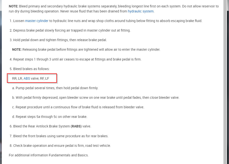

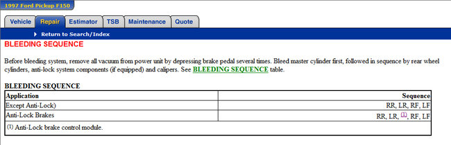

Thank you, do you need to bleed the ABS hydraulic unit? Oh, and I have checked for leaks any where in the system and nothing is apparent.
(Merged)
You only need to bleed the hydraulic unit if it is replaced. Once it is bled it is okay so this is most likely not the issue.
If you have no external leaks, I would go after the master cylinder. If you find it is the issue, just make sure you bench bleed it so that you don't damage it when trying to bleed it on the vehicle.

No. I don't believe you do. I am not sure what you saw on the internet but once the ABS is bled it doesn't need to be done again. If you can post a link to that video, I will take a look and see what they were saying.

it`s on YouTube, (how to bleed brakes with RABS ( Ford ABS ). When I was checking to see if there was another way to bleed brakes. Now when I bleed the brakes, start passenger rear, driver rear, passenger front then do I bleed ABS valve ? then driver front?
