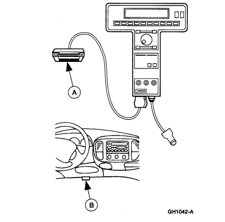

Good afternoon.
This sounds like you still have air in the system.
https://www.2carpros.com/articles/brake-pedal-goes-to-the-floor
I posted the procedure below but the key is you need a scan tool that can perform the automated ABS bleed procedure. It sounds like you have in the lines and conventional bleeding will not work until you open the ABS valves. That is what the scan tool does to get rid of the air.
https://www.2carpros.com/articles/how-to-bleed-or-flush-a-car-brake-system
NOTE: This procedure only needs to be performed if the 4 wheel anti-lock brake (4WABS) hydraulic control unit (HCU) has been replaced.
NOTE: One conventional pressure bleed cycle consists of advancing the brake pedal to its extended position, opening the wheel cylinder bleeder screw, allowing fluid to be released into the waste container, closing the wheel cylinder bleeder screw and releasing the brake pedal to its full upright position.
NOTE: When any part of the hydraulic system has been disconnected for repair or replacement, air may get into the system arid cause spongy brake pedal action. This requires the bleeding of the hydraulic system after it has been properly connected. The hydraulic system can be bled manually or with pressure bleeding equipment Brake Bleeder.
NOTE: Performing the New Generation Star tester (NGS) program routine drives entrapped air from the otherwise inaccessible lower section of the 4WABS valve into the upper sections (accessible by bleeding the brakes). Subsequent bleedings remove the air from the system.
NOTE: Add recommended brake fluid as necessary throughout the procedure.
Wheel Cylinder Bleeder Screw
1. Connect a clear waste line to the RH rear wheel cylinder bleeder screw and the other end in a container partially filled with recommended brake fluid.
2. With the RH rear wheel cylinder bleeder screw open, cycle the brake pedal until no more air is seen in the waste line.
Wheel Cylinder Bleeder Screws Torque Specifications
3. Close the RH rear wheel cylinder bleeder screw and disconnect the waste line.
4. Repeat steps 1, 2, and 3 for the LH rear wheel cylinder bleeder screw, RH front disc brake caliper bleeder screw, and the LH front disc brake caliper breeder screw.

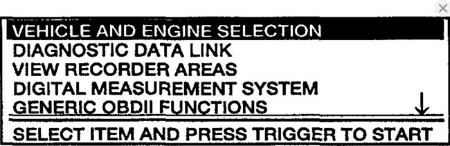

Connect Cable Adapter
5. Connect the (A) NGS DCL cable adapter into the (B) vehicle data link connector (DLC).

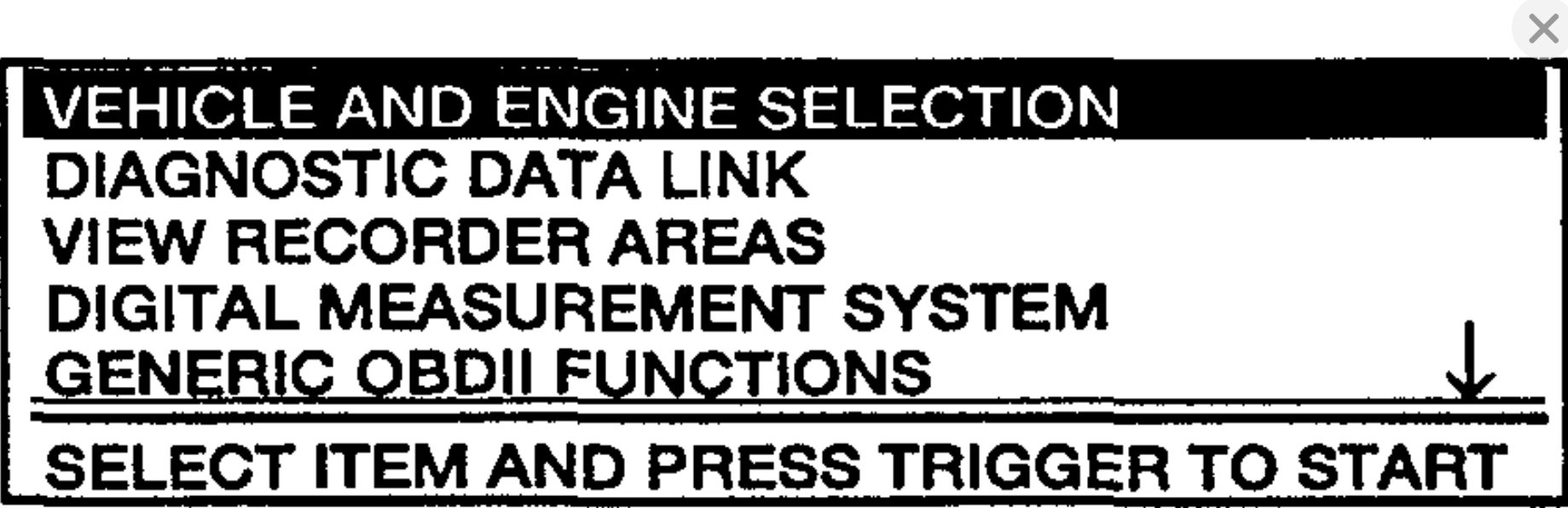

Vehicle And Engine Selection
6. Select VEHICLE AND ENGINE SELECTION and press trigger to start the NGS.

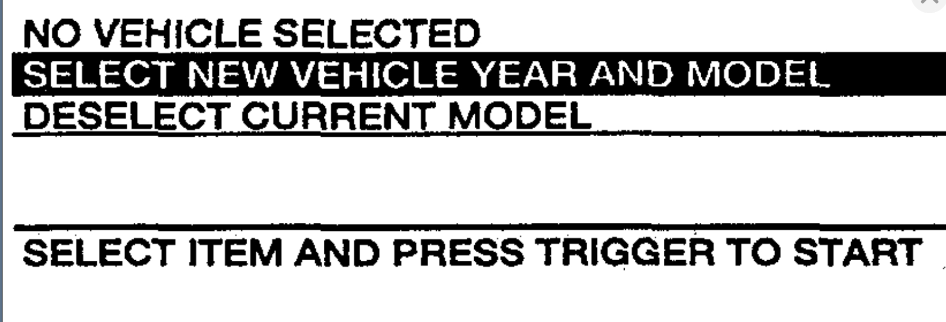

Select New Vehicle Year And Model
7. Select SELECT NEW VEHICLE YEAR AND MODEL and press trigger to start the NGS.
Vehicle Year Selection
8. Select the appropriate vehicle year application and press trigger to start the NGS.

Select Diagnostic Data Link
11.Select DIAGNOSTIC DATA LINK and press trigger to start the NGS.
Trigger Or Cancel Display
12.Follow the NGS prompt PRESS TRIGGER TO CONTINUE or PRESS CANCEL TO BYPASS.

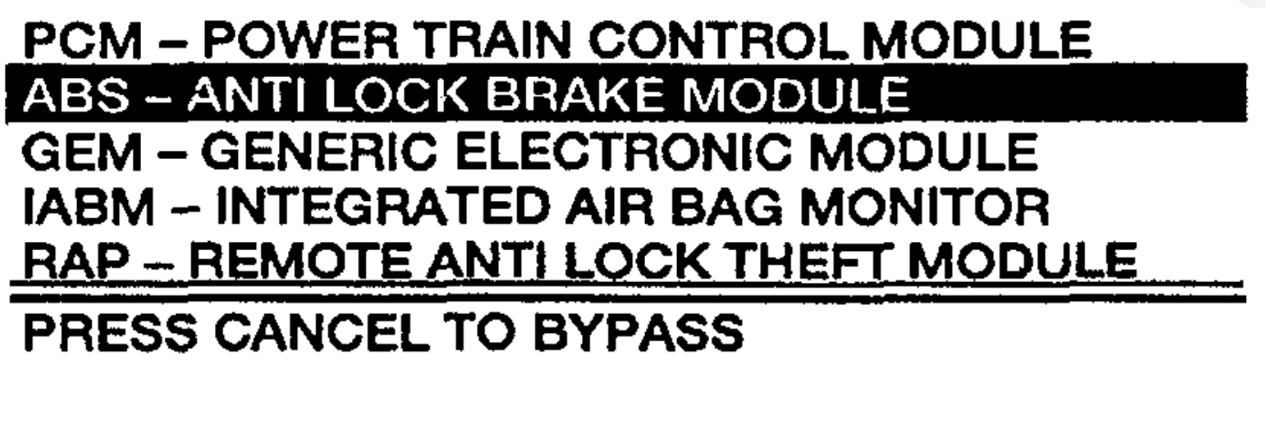

Select - Anti-Lock Brake Module
13.Select ABS ANTI-LOCK BRAKE MODULE and press trigger to start the NGS.

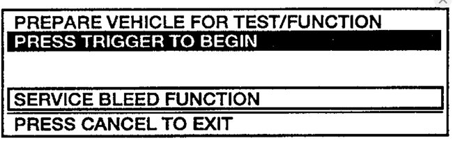

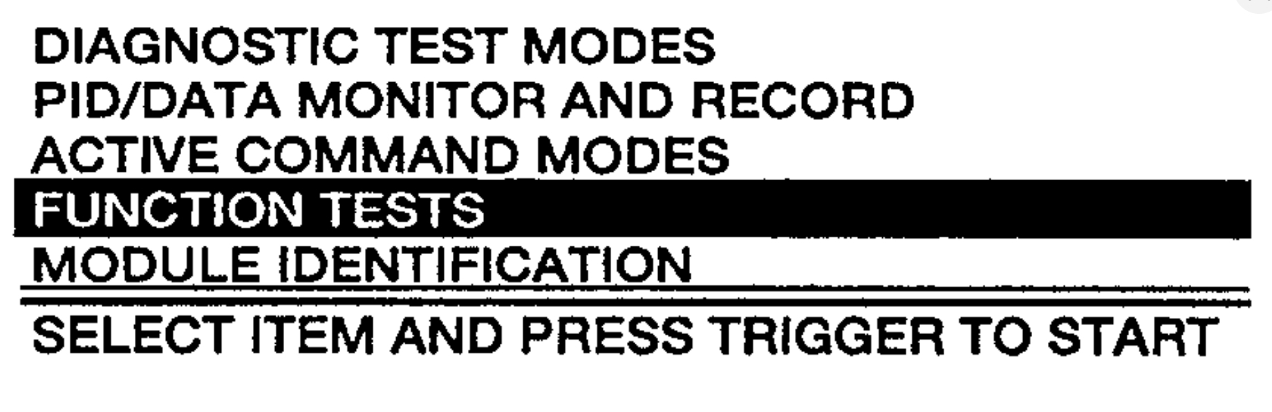

Function Tests
14.Select FUNCTION TESTS and press trigger to start the NGS.
Service Bleed Function
15.Select SERVICE BLEED FUNCTION and press trigger to start the NGS.
16.Select PRESS TRIGGER TO BEGIN.
NOTE: The brake pedal should be depressed while this procedure is functioning. Perform at least five service bleed procedures.
17.Repeat conventional bleed procedure as outlined in steps 1 through 4.
18.If brake pedal feels spongy, repeat NGS service bleed procedure as outlined in steps 5 through 16 and repeat conventional bleed steps 1 through 4.

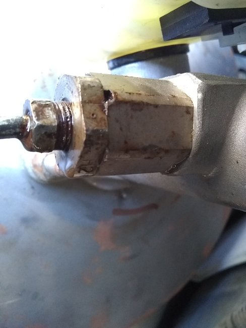

CHAD READ
  • 26 POSTS

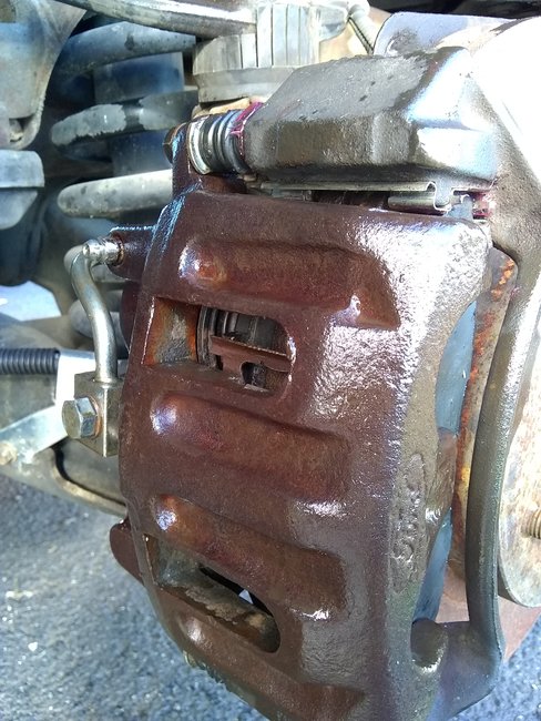

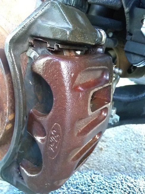

I replaced the master cylinder, replaced brake booster, new brake pads, turned rotors, replaced calipers. Tried bleeding brakes in sequence over and over, bench bled master cylinder. Front brakes squeeze together and won't let go. And pedal still sinks to the floor.

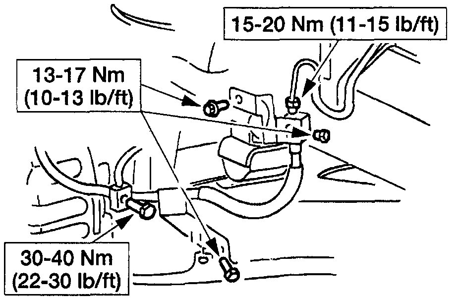

It sounds like an issue with one of the rubber brake hoses to the caliper. I need you to try this for me and let me know what happens.
First, safely lift the front wheels off the ground so you can turn them. Apply the brakes so the caliper locks. Open the bleeder on the brake caliper. Does the caliper release?
If so, do this. Apply the brakes to lock caliper. Release pressure at the master cylinder. If it doesn't release the caliper, replace the rubber brake hoses.

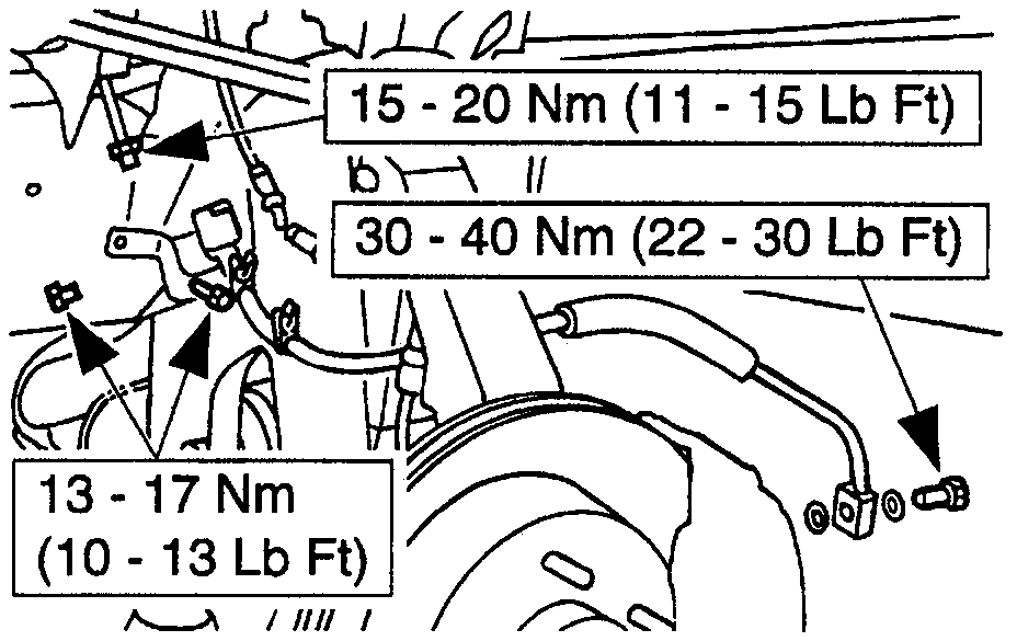

Here are the directions specific to your vehicle for brake hose replacement. The attached pictures correlate with these directions
Front brake hose
Removal:
Warning: brake fluid contains polyglycol ethers and polyglycols. Avoid contact with eyes. Wash hands thoroughly after handling. If brake fluid contacts eyes, flush eyes with running water for 15 minutes. Get medical attention if irritation persists. If taken internally, drink water and induce vomiting. Get medical attention immediately.
- Raise and support the vehicle.
Warning: the electrical power to the air suspension system must be shut off prior to hoisting, jacking or towing an air suspension vehicle, this can be accomplished by turning off the air suspension switch located in the right hand kick panel area. Failure to do so may result in unexpected inflation ()r deflation of the air springs which may result in shifting of the vehicle during these operations.

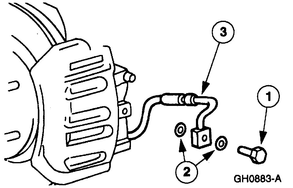

Disconnect Front Brake Hose
see picture 1
- Disconnect the front brake hose.
1 Remove the front brake hose bolt.
2 Remove and discard the copper washers. Plug the front brake hose.
3 Disconnect the front brake hose.
Remove Front Brake Hose
see picture 2
- Remove the front brake hose.

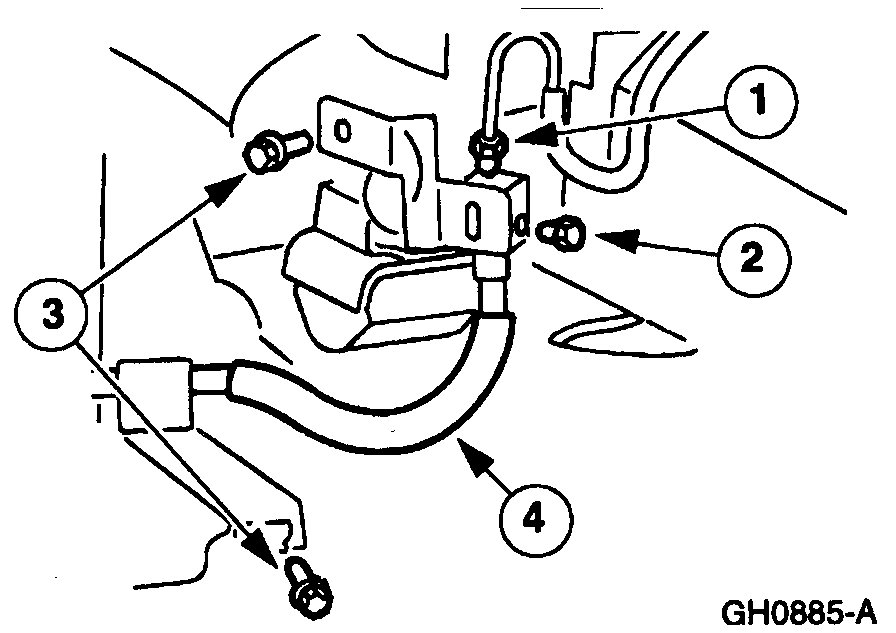

1 Disconnect the front brake tube fitting and plug the tube.
2 Remove the plug;
3 Remove the two brake hose frame bolts.
4 Remove the front brake hose.
INSTALLATION:
Front Brake Hose Torque Specifications
see picture 3
see picture 4
- To install, reverse the removal procedure.
^ Bleed the front brakes; refer to procedure in this section section.
Let me know what you find.

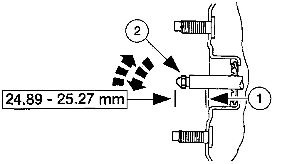

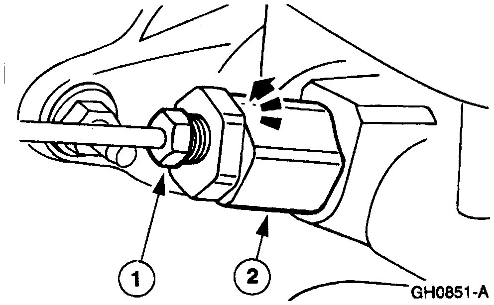

Also, since both the booster and master cylinder were replaced, you really should check the push rod adjustment between the two. Here are the directions for adjustment, Pic 5 correlates with this process.
Remove the brake master cylinder: refer to the Master Cylinder, Brakes.
Power Brake Booster To Master Cylinder Push Rod Torque Specification
see picture 5
-Adjust the power brake booster to brake master cylinder push rod.
1 Measure the power brake booster to brake master cylinder push rod.
2 If necessary, adjust the screw to the proper length.

  • 110,251 POSTS
Okay. Did you adjust the push rod? It sounds like something isn't put together correctly there. If nothing leaks, everything is new, either the master cylinder is bad or the push-rod is not properly adjusted and getting stuck causing the pressure to remain on the calipers. Try the release procedure I suggested. At least that way we will know if the problem is at the master cylinder or after it. THis guide can help us
Mar 10, 2021 at 3:21 AM (Merged)
CHAD READ
  • 26 POSTS
I have not yet adjusted the push rod yet. Waiting for warmer weather I also already bench bled the master cylinder the best I could with the kit. so I will check the push rod first.

I adjusted the push rod the pedal hardend and remained hard even after it set. (No more sinking to the floor). The front brakes squeezed but they aren't letting go do you recommend bleeding all after?
  • 110,251 POSTS
Okay, now that we have a good pedal, try to bleed the system. However, air in the system shouldn't cause the system to lock up. So, lets try to narrow it down. First, pump the brakes so the calipers lock. Once they do, open the bleeder on the caliper and see if the caliper releases. If it does, then we need to go further back. Close the bleeder at the caliper. Go the master cylinder, and apply brakes so they lock again and open the front steel line on the master cylinder and see if it releases. If it does, then something is bad in the master cylinder.

okay now fluid is coming out of all except the rear drivers side.
CHAD READ
  • 26 POSTS
nevermind just had to prop the the pedal fluid shot out of the right front passenger side strongly. fluid is coming out of all of them now pedal will sink to the floor after sitting a little bit.
CHAD READ
  • 26 POSTS
pedal is hardening up front brakes arent letting go I did not completely bleed all of the brakes I just made sure fluid was coming out no air shot out I made sure fluid was coming out of the abs module no air came out of it. Is the an ABS valve somewhere on this truck? I dont know exactly where it is I can see anything.
CHAD READ
  • 26 POSTS
It seems like all the brake pressure is staying at the front alot more pressure on the passenger side than on the right and just a little fluid coming out of the back right and left and I noticed looks like there is a rubber brake hose tin the middle probably need to be replaced. what do you think.
CHAD READ
  • 26 POSTS
Should I try to get a new valve?
  • 110,251 POSTS
The valve may be the entire problem. It is what determines pressure to the rear. However, I have to be honest with you, I never saw one cause this. But, if the calipers release when you open the bleeder at the MC, that is my first suspect unless the new master cylinder is bad.
Was the vehicle doing the same thing prior to replacing the MC? If not, there may be an internal issue in the MC. There are two plungers. The one for the rear brakes may be bypassing fluid, causing the rear pressure to be low and causing some kind of build up of fluid which in turn doesn't allow the fronts to release.
Do the front brakes release when you open the bleeder?
CHAD READ
  • 26 POSTS
No they dont open. Yes if I remember correcly the same thing happened with the MC.

Well it would have been a good idea to put them on the right way. LOL
CHAD READ
  • 26 POSTS
okay! now the passenger front brake compresses and lets go the front drivers side is compress and wont let go. what do you suggest I should do next? this would be very helpful.
CHAD READ
  • 26 POSTS
Now I remember from the beginning the driver's side front brake got really hot from sticking to the rotor so I think I have went back to the beginning of the original problem.
CHAD READ
  • 26 POSTS
If I could fix this one Brake I think it would solve the problem
