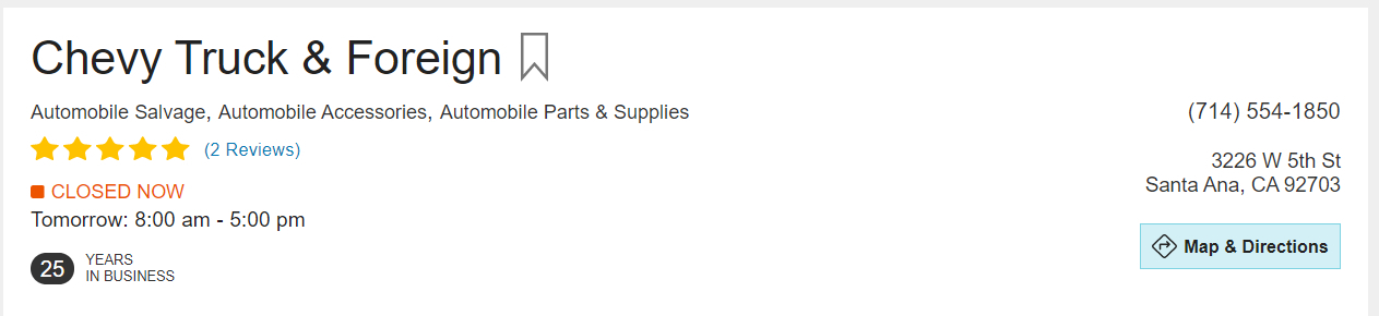

DANNY L
  • 5,648 POSTS
Hello again.
I've attached picture information below of the Chevrolet truck wrecking yard I use here in Southern California. Ask for Tom he knows his stuff and I'm sure he will have your wiring harness and can ship if you don't find it in your area. Hope this helps and thanks again for using 2CarPros.
Danny-
Sunday, January 3rd, 2021 AT 9:33 PM

Give him a call I'm sure his business can ship it to you if you can't find it in your area. Thanks again for using 2CarPros.
