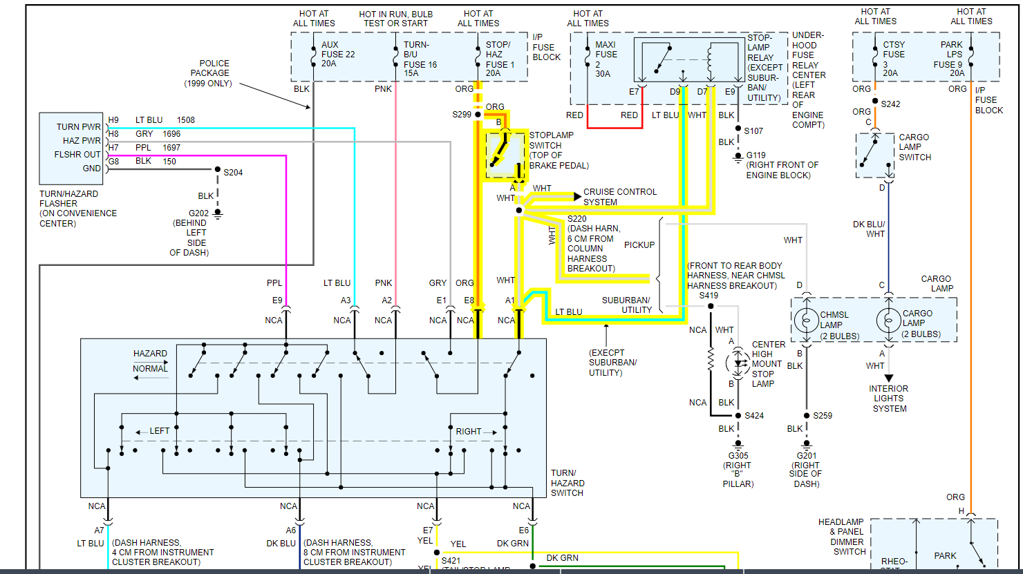

Good morning,

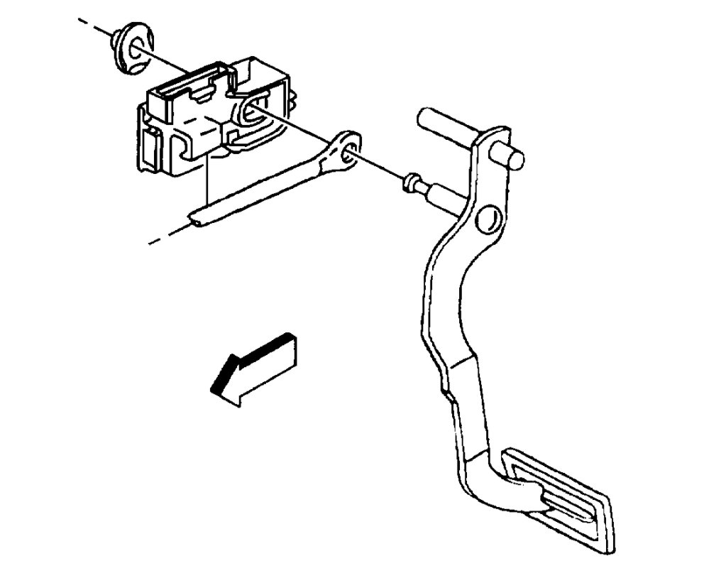

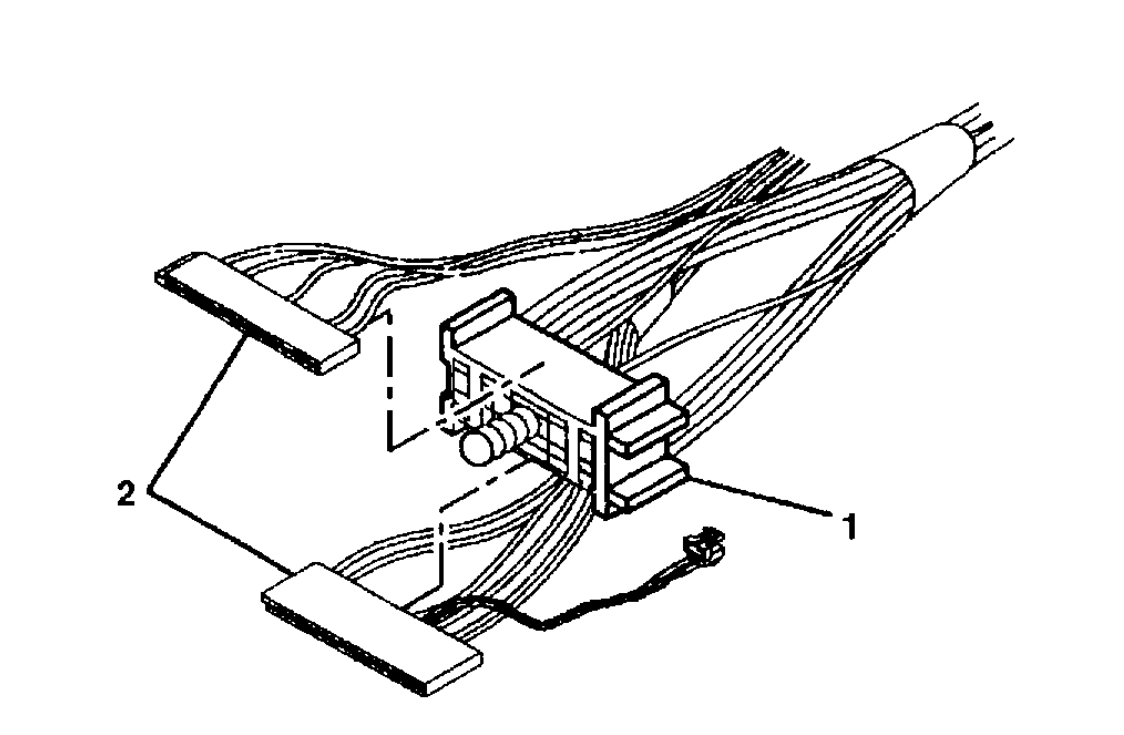

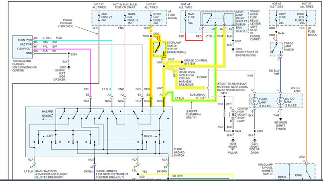

I attached a wiring diagram for you to view. Check the fuse for power to the switch.
Then check voltage at the switch itself. It is under the dash on the brake pedal.
For information on stop lamp circuit diagnosis, refer to Diagrams, Diagnostic Aids.
Caution: Refer to Battery Disconnect Caution in Service Precautions.
1. Disconnect the battery negative cable.
2. Disable the SIR. Refer to Disabling the SIR System.
3. Remove the pushrod retainer from the brake pedal pin. Use snap ring pliers.
4. Unsnap the stop lamp switch from the pushrod.
5. Disconnect the electrical connector from the stop lamp switch.
Installation Procedure
1. Connect the electrical connector to the stop lamp switch.
2. Snap the stop lamp switch onto the pushrod.
3. Install a new pushrod retainer on the brake pedal pin. Use an 11 mm (7/16 inch) socket in order to push a new clip onto the pin.
4. Connect the negative battery cable.
5. Enable the SIR. Refer to Enabling the SIR System in Restraint Systems.

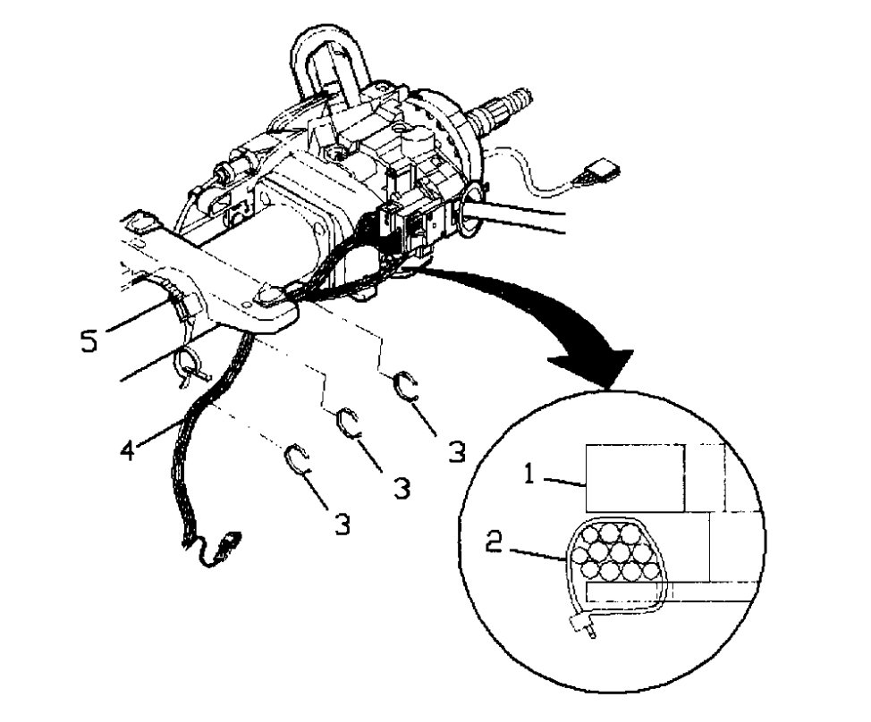

Dec 6, 2020 at 12:17 PM

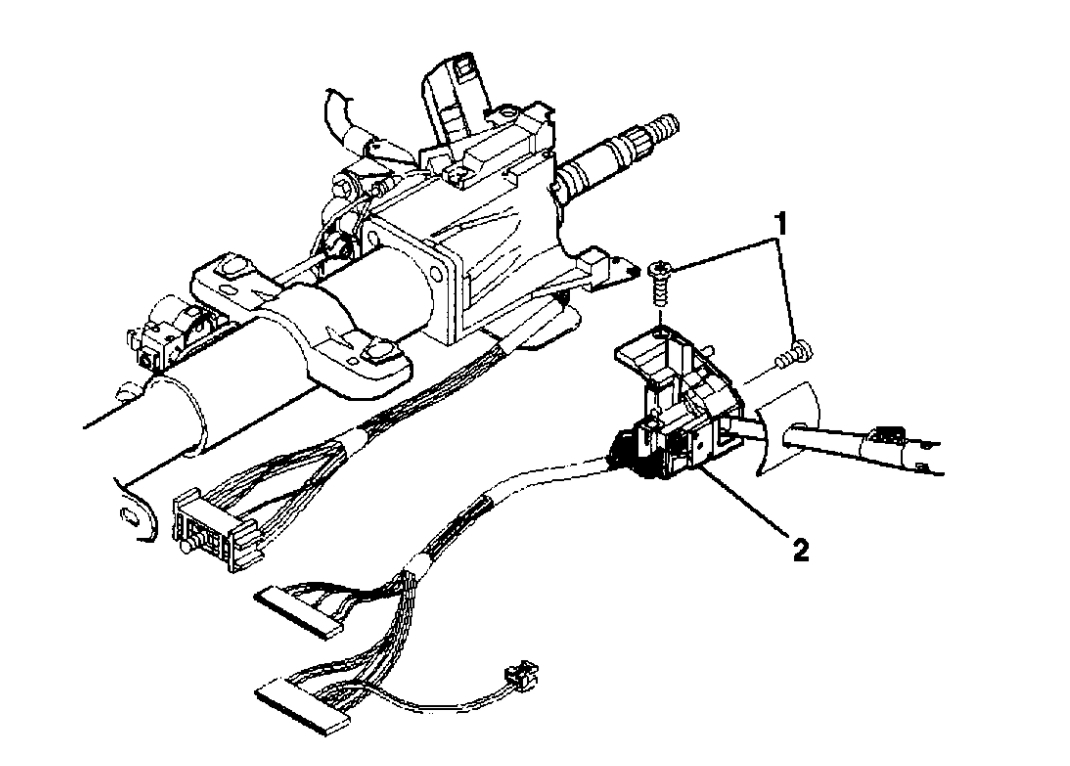

Correct. If it works, then the switch is good.
This means either the turn signal switch is bad or the wiring to the bulbs is an issue.
Assembly Procedure
Important: Be sure that the electrical contact of the turn signal and multifunction switch assembly (2) rests on the turn signal cancel cam assembly.
Notice: Refer to Fastener Notice in Service Precautions.
1. Install the turn signal and multifunction switch assembly (2).
2. Install the 2 pan head tapping screws (1).
Tighten the screws to 7 Nm (62 inch lbs.).
3. Slide the 2 connectors (2) of the turn signal and multifunction switch assembly into the bulk head connector (1).
4. Pop the wire harness assembly (4) into the wire harness strap (5). Install the wire harness strap (2) into the steering column support assembly (1). Install the wire harness straps (3) onto the wire harness assembly (4).
5. Install the upper and lower shrouds. Refer to Steering Column Trim Covers - Assemble Off Vehicle (Column Shift).See: Steering Column > Removal and Replacement

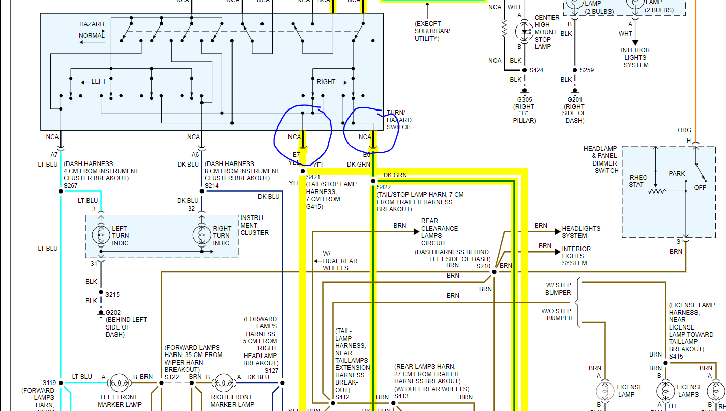

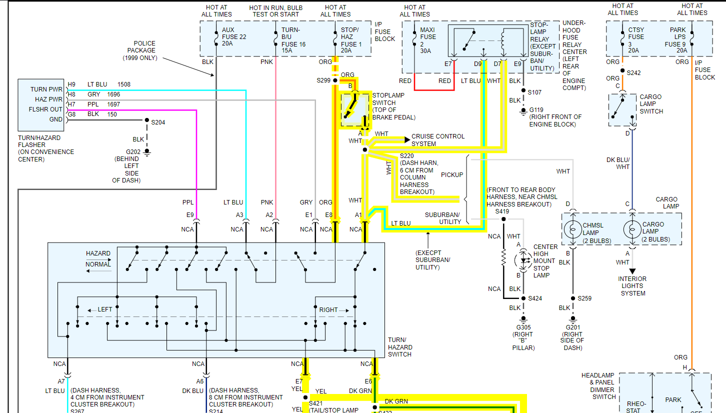

Okay, I attached a diagram for you to view. Check for power out of the multifunction switch with the brake pedal depressed with a voltmeter.
Dec 17, 2020 at 2:47 PM

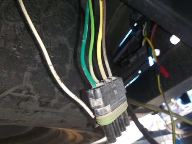

this has a trailer brake on it under the dash. not a very good looking job. The wires in the back are hooked to nothing there taped off would this have anything to do with it ?
Dec 17, 2020 at 7:02 PM
If they go to the rear brake lights, yes. Check the colors and match them to the diagram.
Dec 17, 2020 at 7:15 PM

i have a yellow, light green, dark green, brown, blue, orange. orange and brown are hot.
Dec 17, 2020 at 7:34 PM
Yellow and dark green are the ones going to the rear lights. Check the diagram I sent you to verify.
Dec 17, 2020 at 7:43 PM

i see what your talking about. these wires go to the trailer plug so i don't know what to do with them.
Dec 17, 2020 at 8:04 PM
Do a continuity check to the rear lights from those wires to be sure that they are the wires.

Dec 20, 2020 at 1:21 PM
What about the white and orange wires going into the multifunction switch?
Dec 20, 2020 at 5:41 PM

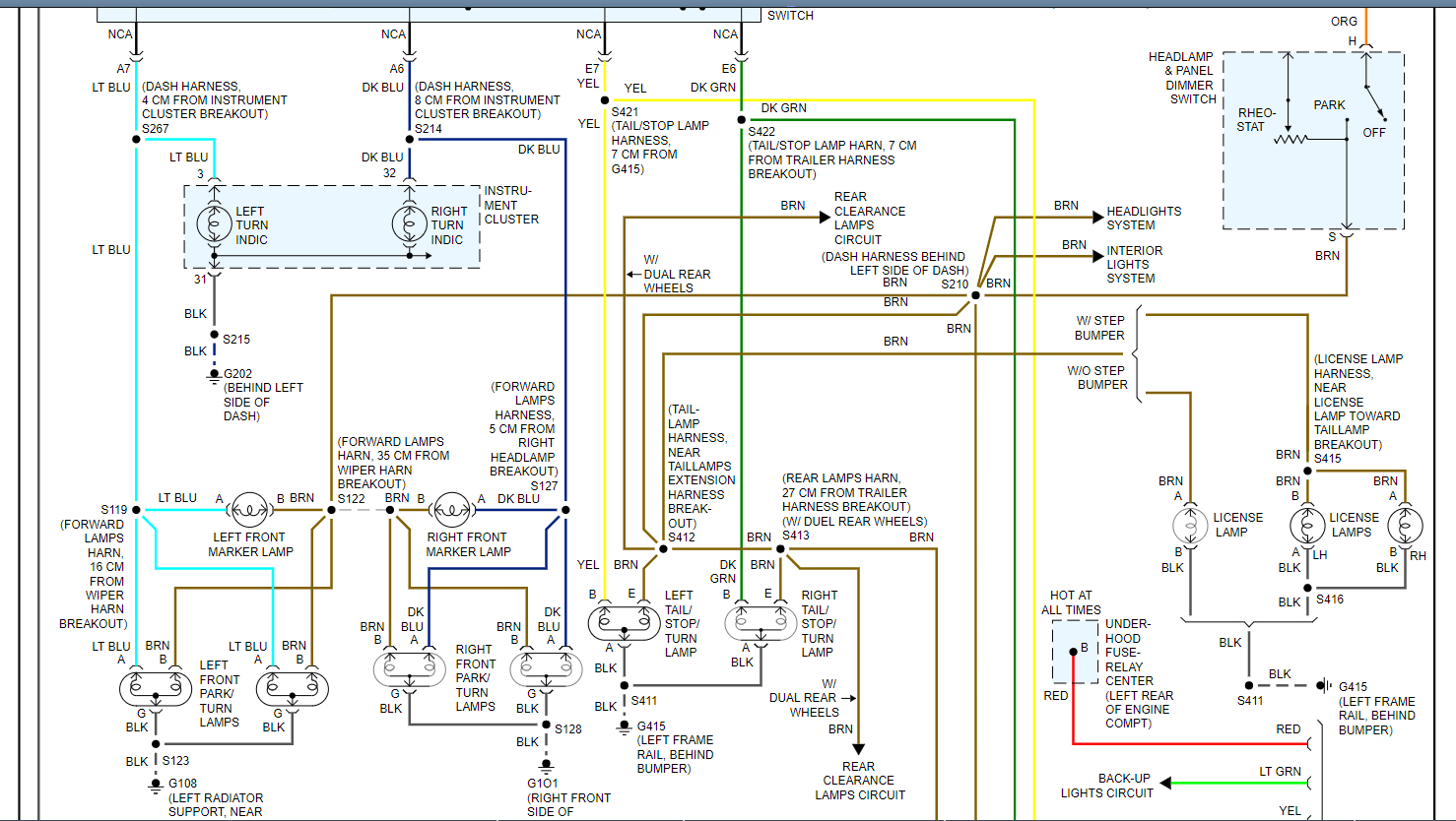

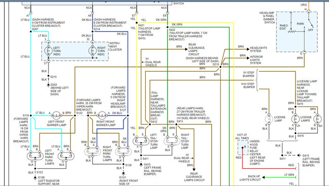

Dec 23, 2020 at 10:03 AM
DANNY L
  • 5,648 POSTS
Hello, I'm Danny.

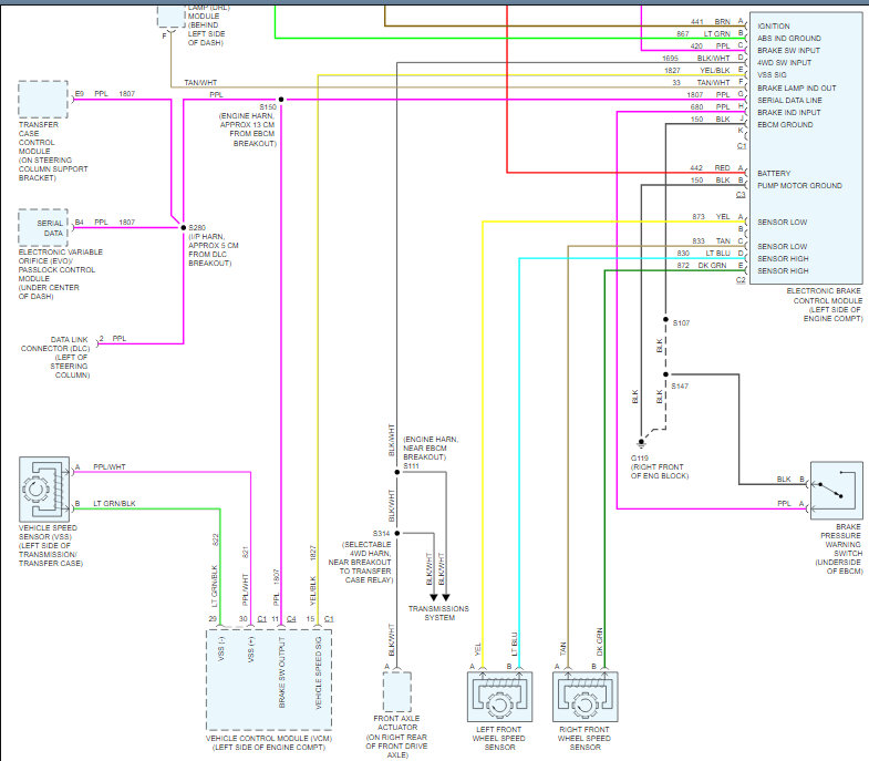

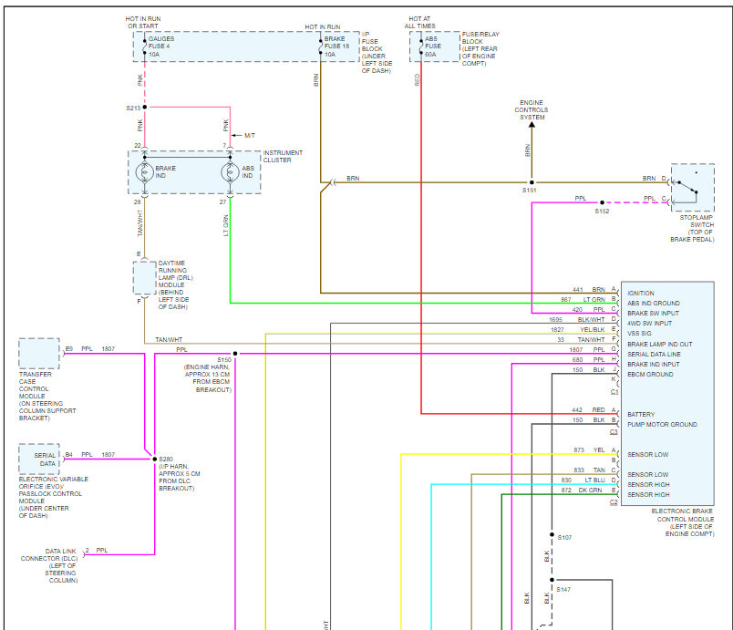

I've attached an ABS brake wiring diagram below for you. You mentioned you got the lights working. Are you trying to get a trailer brake to work? Let us know and we'll figure this out. Hope this helps and thanks again for using 2CarPros. Happy Holidays.
Dec 27, 2020 at 1:56 PM

what are these drawings for? I have a 2000 k3500 454 4x4 automatic stander cab .This seems different.
Dec 28, 2020 at 12:16 AM
Sorry for the delay, where is the connector from in your picture? Where does that white wire go?
Dec 28, 2020 at 1:30 AM
DANOC22
  • 45 POSTS
The white wire is hanging from the original wiring harness. no sign of it connected to anywhere.
Dec 28, 2020 at 9:58 AM
If you look at the original wire diagram I sent you in the beginning, the white wire is from the brake light switch. It feeds the turn signal switch as well as the brake relay.
Test that for voltage with the pedal depressed.
Dec 28, 2020 at 1:01 PM
DANOC22
  • 45 POSTS
should it be hot with brake depressed?
Dec 28, 2020 at 1:51 PM
Yes, it should. Look at the diagram I posted in the beginning and you will see that wire feeds off to several places.
Dec 28, 2020 at 2:01 PM

Dec 28, 2020 at 2:15 PM
It goes to A1 in the wire diagram I sent you for the multifunction switch.
It also goes to the underhood fuse block for power to the relay.
Dec 28, 2020 at 2:24 PM

i see where it goes to the stop light switch and to the relay, i don't see what it connect to at the rear of the truck.
Dec 28, 2020 at 2:58 PM
DANOC22
  • 45 POSTS
do i need to open the harness did it pull out of there?
Dec 28, 2020 at 3:00 PM
It does not connect to the rear of the truck. If you see where it goes to the relay, look down further and it connects to the multifunction switch at terminal A1.
Dec 28, 2020 at 3:05 PM
DANOC22
  • 45 POSTS
so it just hangs at the rear of the truck?
