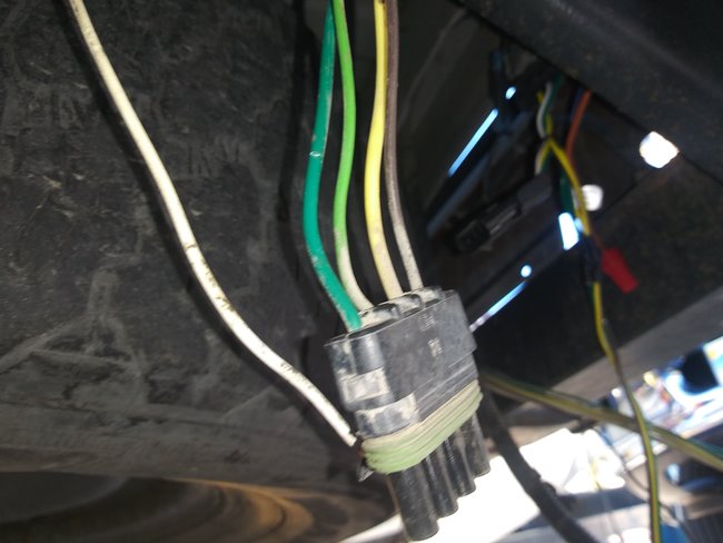

This is at the rear of the truck? You never mentioned that at all.
Was there a cap on the back of the truck at some point?
Dec 28, 2020 at 7:24 AM
DANOC22
  • 45 POSTS
You saw it in the picture of the connector. Cap you mean like a camper type cover? I have only had the truck 2 years. It has a trailer harness.
Dec 28, 2020 at 7:31 AM
Okay, at this point you need a shop that is good at electrical work. You have a harness issue somewhere that was modified or changed by someone and needs to be traced to find out why you do not have rear brake lights.

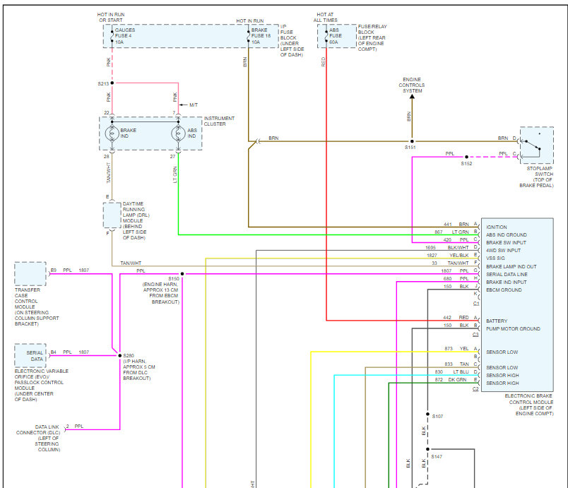

Going back to the start, do you have power out of the multifunction switch to the wires to the rear tail lights with the brake pedal depressed?
Dec 30, 2020 at 11:06 AM
DANOC22
  • 45 POSTS
yes.
Dec 30, 2020 at 11:17 AM
Okay, if you have power out of the switch, then it is wiring to the rear lights. It is a direct path to the rear sockets.
Did you test for power to the rear sockets?

in the brake relay wiring is one wire hot all the time?
Dec 30, 2020 at 11:35 AM
They should not if you went around by tying into the 3rd light.
Going back to the diagram, there is a fuse that supplies power all the time to the relay. The white wire feeds it only after the pedal is depressed.
Check the diagram I posted in the beginning.

that fuse is good. so the cab light does not go through the relay?
Dec 30, 2020 at 11:47 AM
No, if you look at the diagram, it comes from the brake light switch white wire.
