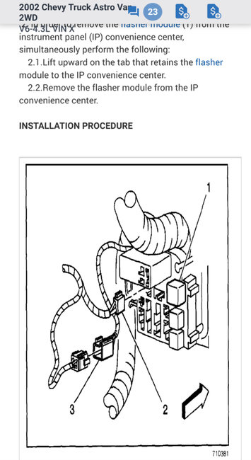

Okay, turn signals work hazards don't work, fuses are good. does the top brake light that works with it the side left and right brake lights do not what could be the problem.

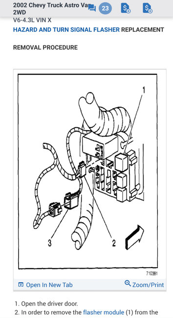

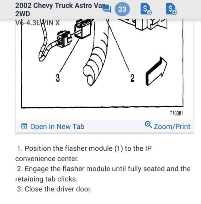

Hello there. Do the brake lights work when the hazards aren't turned on? If so, then your problem is most likely going to be in the multifunction flasher module. I'm including instructions on how to replace the flasher in the images.
If you use your hazards often or do a fair amount of towing trailers, then I suggest the one in the link below. I run my hazards about 5 his a day and haven't needed a new flasher in 3 years because if how this thing is made. Before that I was replacing them at least yearly.
