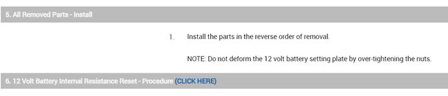

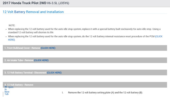

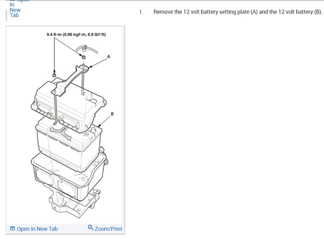

If the vehicle has the original battery that is probably the problem, to be sure this guide can help you load test the battery without equipment:
Here is a generic guide to help you step by step with instructions in the diagrams below to show you how on your car:
https://www.2carpros.com/articles/how-to-replace-a-car-battery

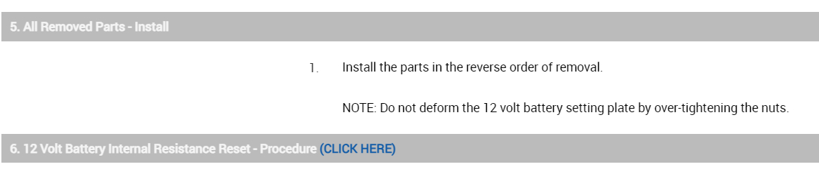

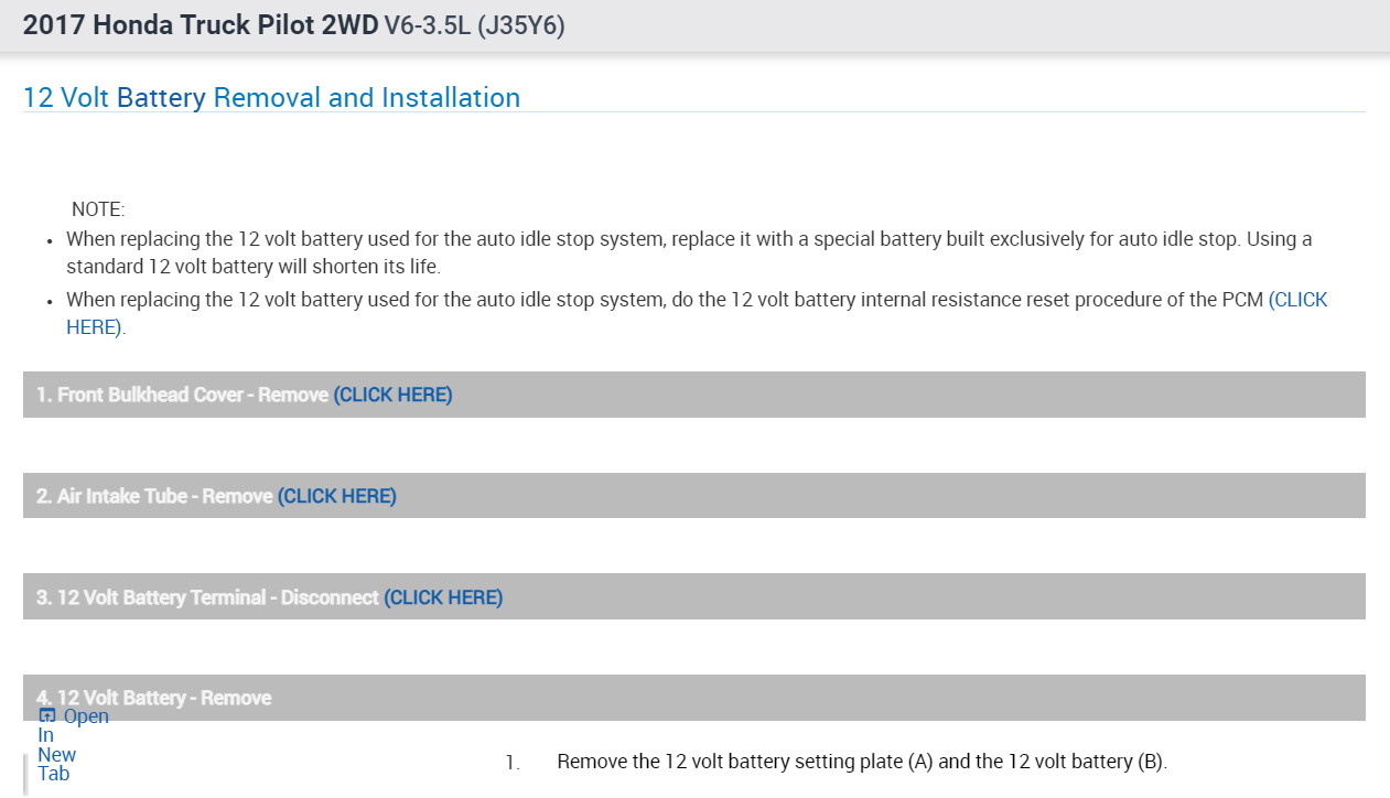

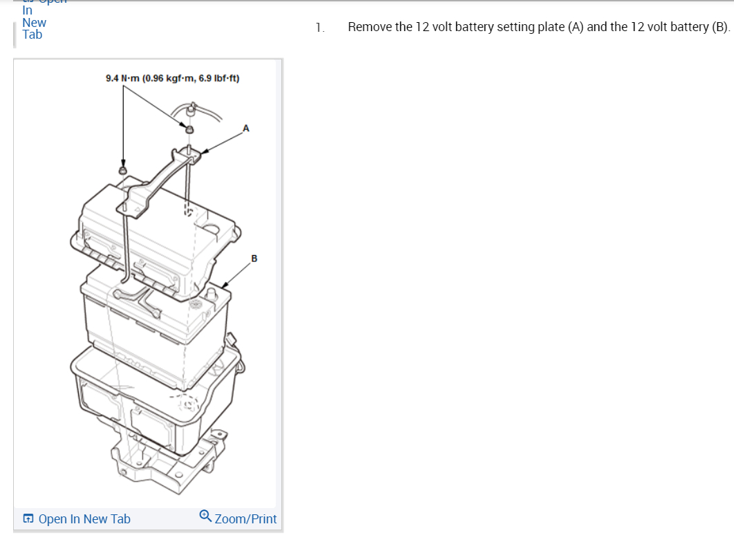

If the vehicle has the original battery that is probable the problem, to be sure this guide can help you load test the battery without equipment.
Here is a generic guide to help you step by step with instructions in the diagrams below to show you how on your car.
Check out the images (Below). Let us know what happens and please upload pictures or videos of the problem so we can see what's going on.
