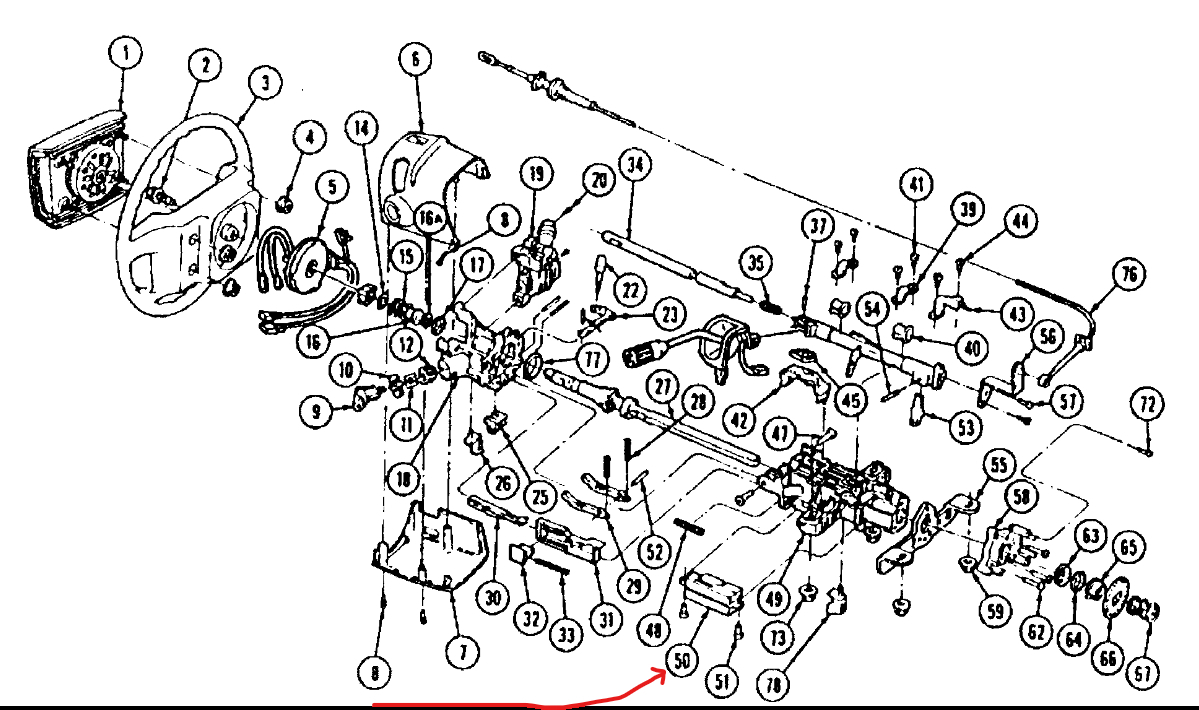

Yes, the battery sounds like it is low on charge or bad. Let's run the codes to see what comes up.
This guide may help as well:
https://www.2carpros.com/articles/comprehensive-guide-reasons-why-a-car-engine-wont-run-when-hot-and
I have seen the ignition switch cause this problem BTW. Check out the images (below). Please let us know what you find.
