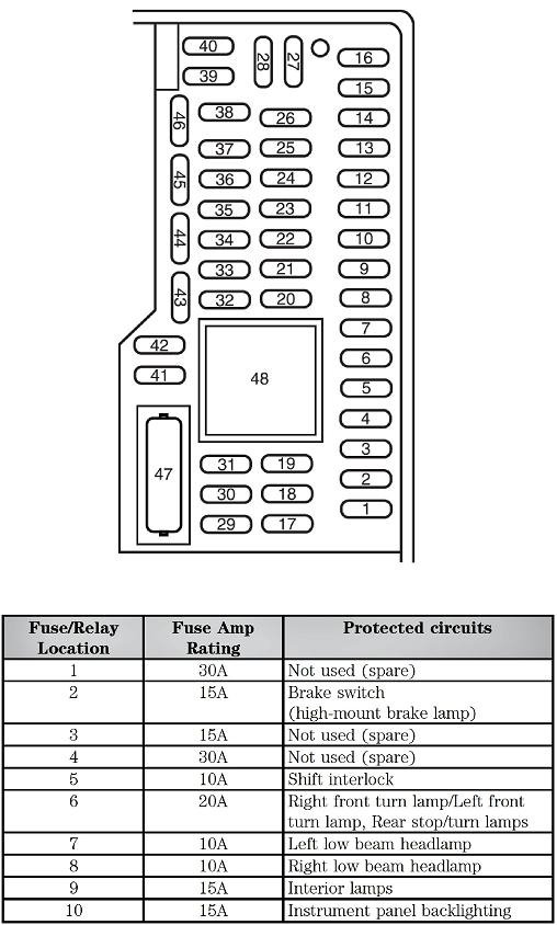

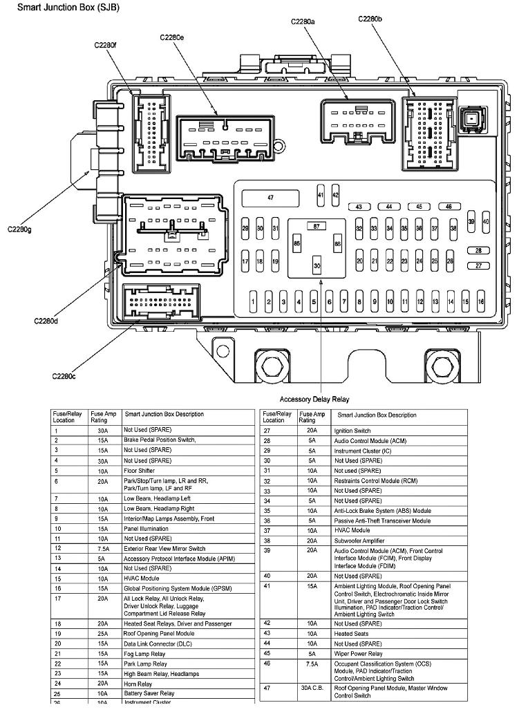

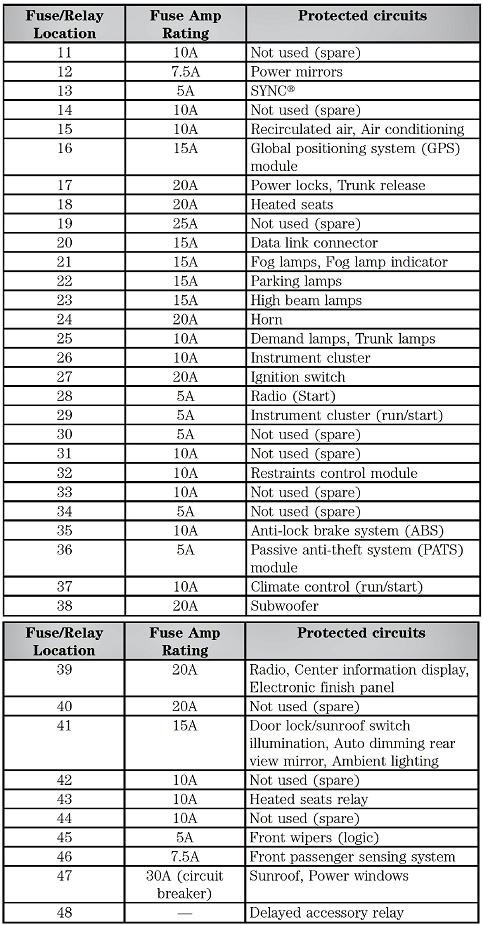

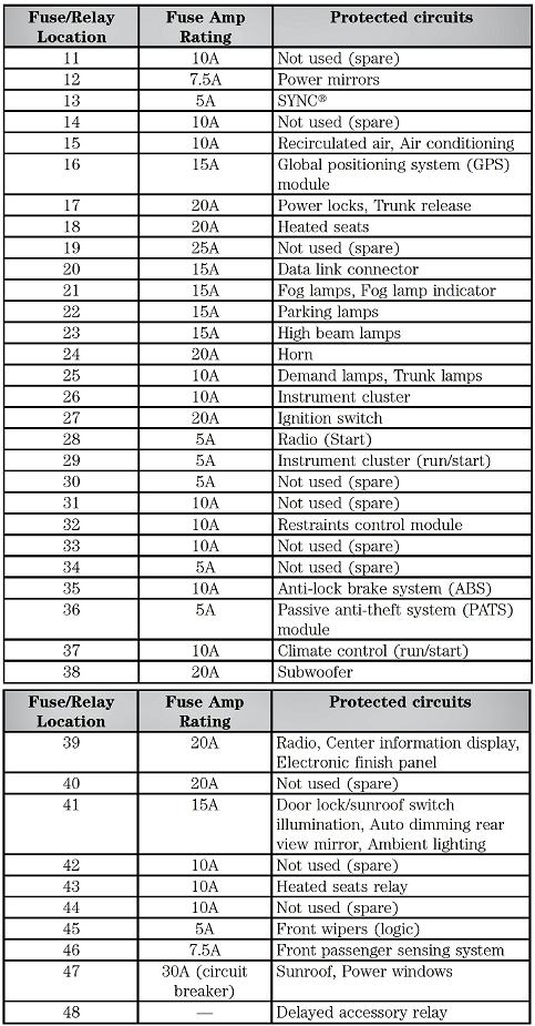

Another thing to be aware of is jump-starting, and even just having a run-down battery, can cause multiple fuses to blow when there really isn't a problem. Once the engine is running, if there are non-working systems, particularly things like interior lights and the radio, suspect a blown fuse. There will be a fuse box under the hood and another one inside the car. Some computers may have set diagnostic fault codes related to the low voltage, and sometimes those have to manually erased to turn off their warning lights. We'll discuss the need to visit a mechanic with a scanner if that becomes necessary. If you need to look at the fuses, here's a link to the appropriate article:
