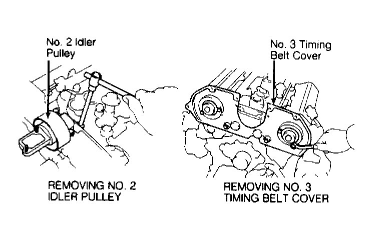

Remove No. 2 and 3 fuel pipes. See Fig 1.
Remove No. 4 timing belt cover, No. 2 idler pulley and No. 3 timing belt cover. See Fig 2 and Fig 3.

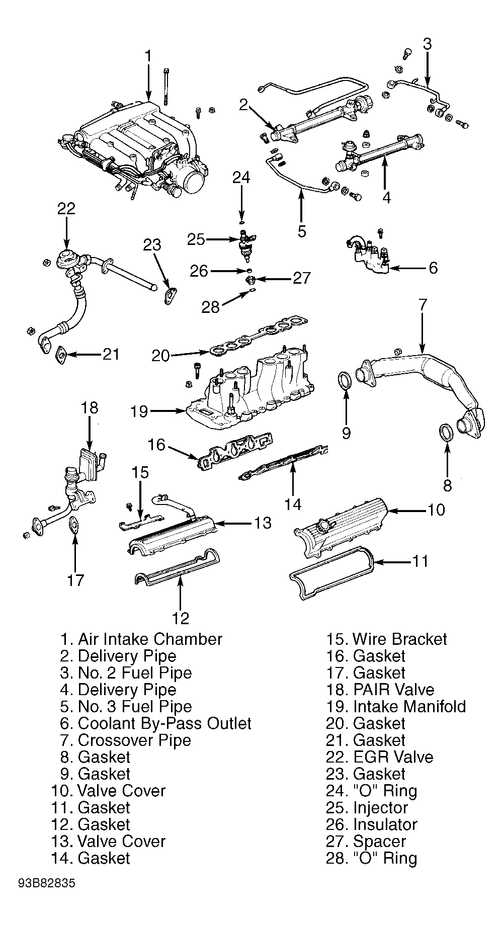

CAUTION: DO NOT allow injectors to fall from delivery pipe when removing delivery pipe from intake manifold.
Remove PAIR valve. See Fig 1.
Remove delivery pipes, injectors, insulators, spacers and "O" rings.
Remove coolant by-pass outlet. See Fig 1.
Remove bolts/nuts, intake manifold and gaskets.

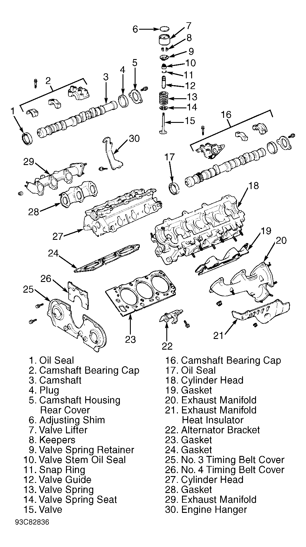

For all cylinder head applications, remove valve covers and gaskets.
Remove camshafts. See CAMSHAFT under REMOVAL & INSTALLATION.

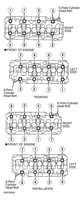

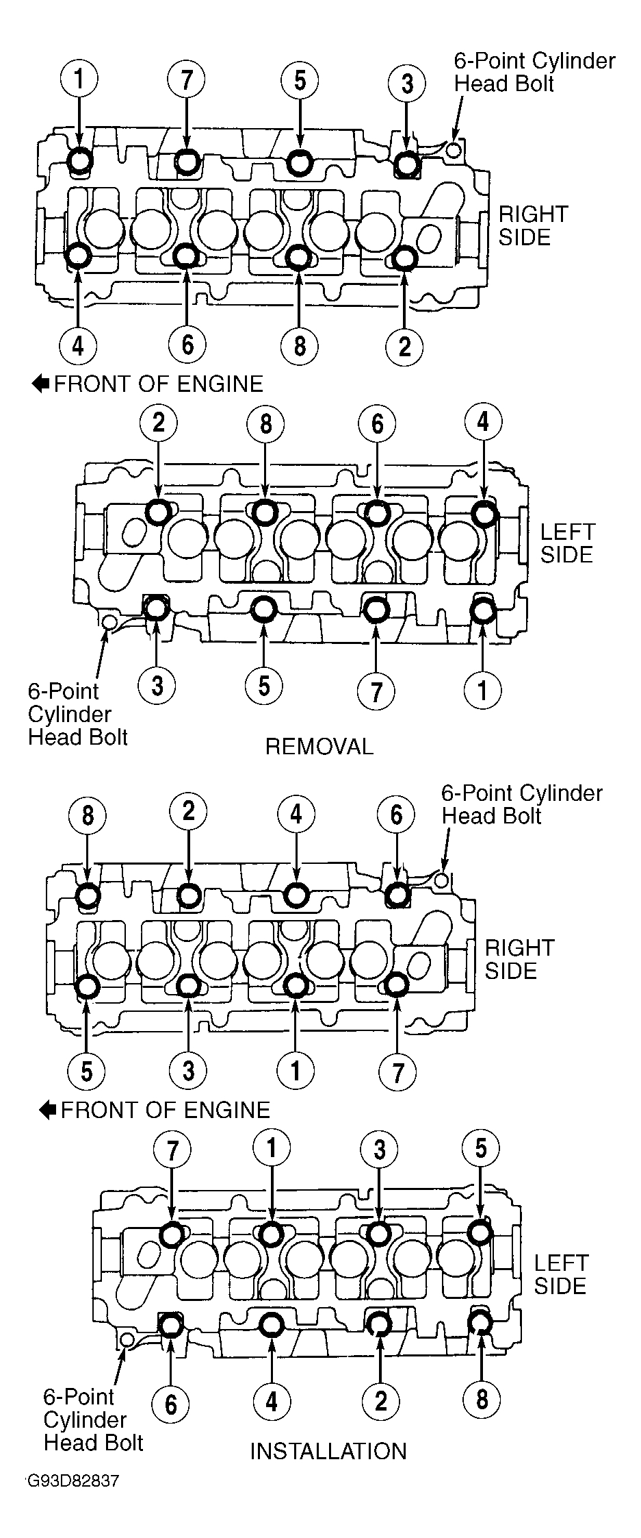

CAUTION: A 6-point cylinder head bolt is located on each cylinder head. All other cylinder head bolts are 12-point bolts. See Fig 4. Cylinder head bolts must be loosened in proper sequence to prevent cylinder head warpage.
Remove 6-point cylinder head bolt from cylinder head. See Fig 4. Loosen remaining 12-point cylinder head bolts in sequence using several steps. See Fig 4.
Remove cylinder head bolts with washers, cylinder head and gasket. Remove exhaust manifold and gasket. If removing valve lifters and adjusting shims from cylinder head, ensure component location is marked for reassembly reference.
