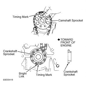

Hello again, had a few probs but it's on now, my last Q is, I lined up the dimpels on the crank and cam sprokets with the chain links, put the time cover back on and ready to install the distrib, but now when I line up the cam sproket @ 12:00 the crank time mark is between the 5* and 0, will that work or is it off a tooth? Thanks Manny.

Hi there,
Set valve tining as per pic & text.
Mark (mhpautos)
https://www.2carpros.com/forum/automotive_pictures/61395_pic_1_1.jpg
https://www.2carpros.com/forum/automotive_pictures/61395_snap_1_3.jpg
