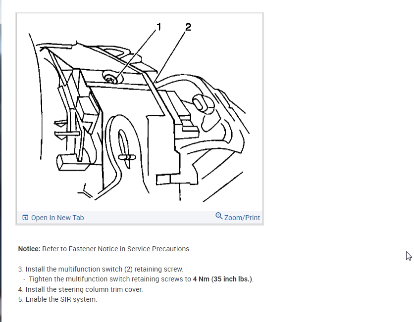

The blinkers stop working and only way to get working is play with the hazard switch.
Jan 19, 2021 at 12:33 AM
When you say you have to play with the hazard switch are you talking about the turn signal lever or the flasher button?

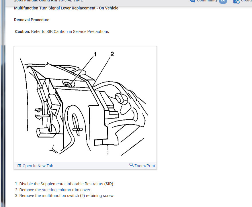

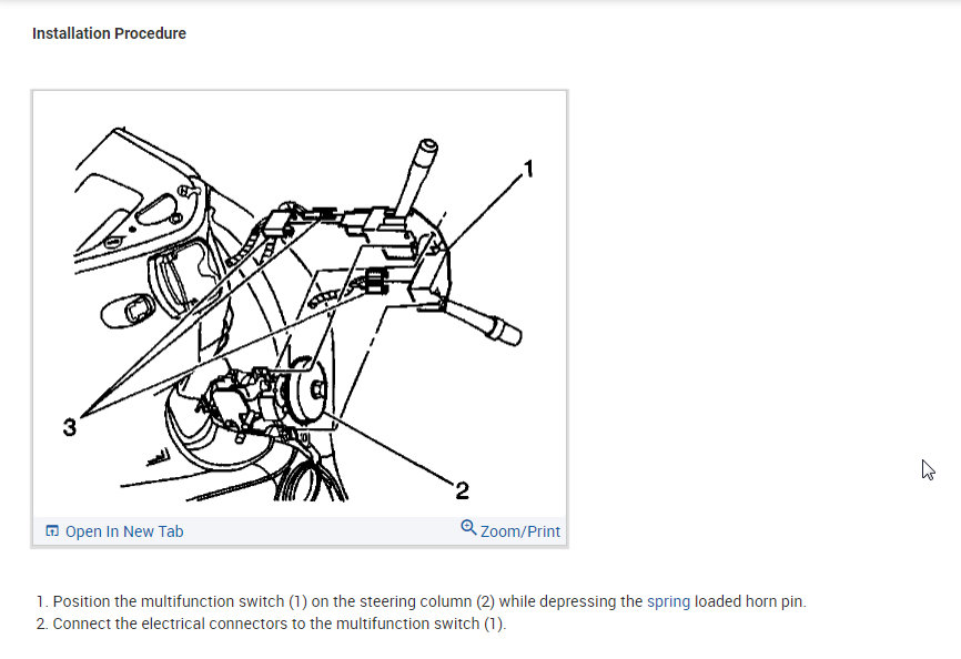

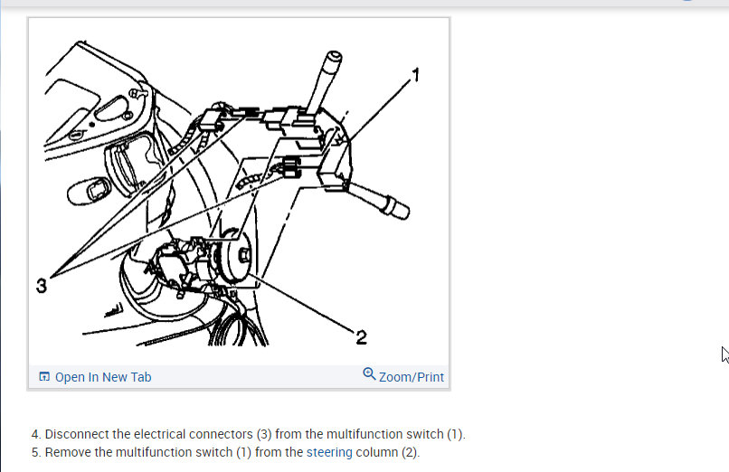

This sounds like you have an issue with the turn lever. I am attaching the process for replacing that but maybe if you get a video of what you have to do in order to get the turn signals to start working, that will help us get on the same page.
Let us know. Thanks
Jan 20, 2021 at 10:13 AM
  • 110,194 POSTS
When you say stop working, do you mean they don't flash or they don't turn on? It sounds like either something is loose or the switch itself is bad. The flasher is part of the hazard switch.
Let me know exactly what is happening.
