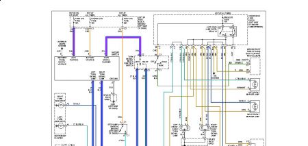

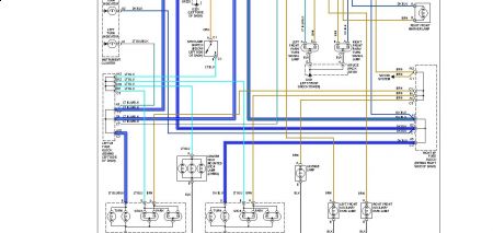

My blinker system has gone haywire. It usually works right away in the cold (but not all the time). After awhile, when it warms up, the blinkers stop working. Sometimes they start working again for awhile and then quit again. To top it off, when they do work, the right one blinks really fast. What do you think the problem is? Is there any way I can fix this without costing me 800 dollars? I was told that if it is the switch, the part alone is almost $500. Also, is there a diagram and step by step guide I can look at to do it myself? Thank you.
Saturday, January 16th, 2010 AT 12:50 AM
9 Replies
  • 75,992 POSTS
Could be an open bulb that's causing it to blink fast, overall get the turn signal/multifunction switch tested-

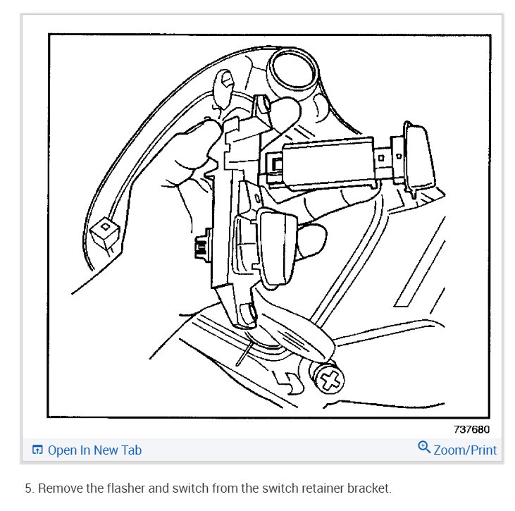

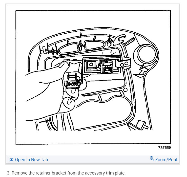

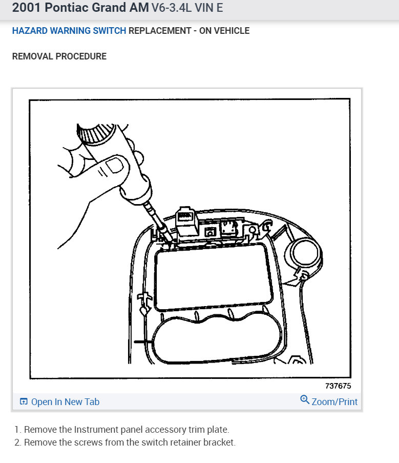

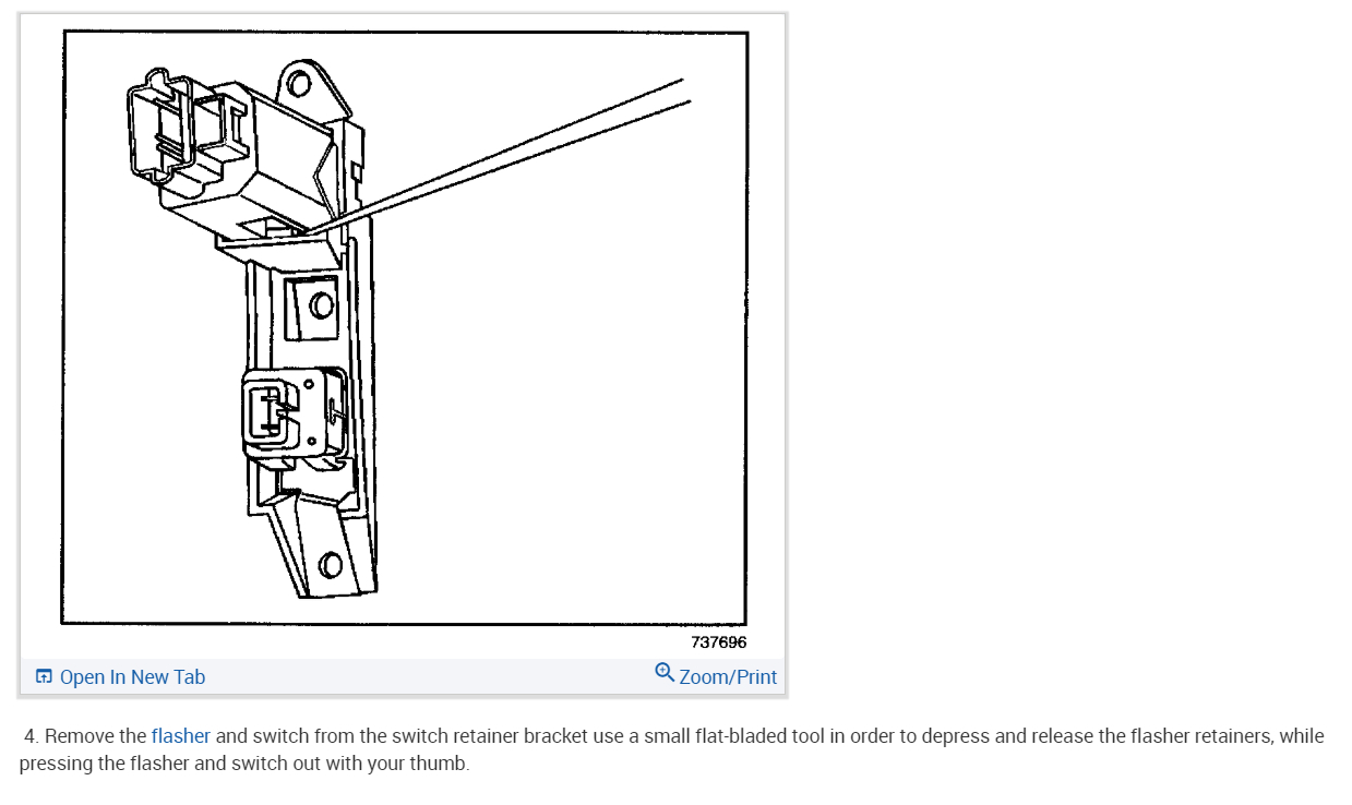

KEN L
  • MASTER CERTIFIED MECHANIC
  • 48,363 POSTS
This is because the hazard switch needs to be replaced here are instructions on how to do it in the diagrams below. Check out the diagrams (Below). Please let us know if you need anything else to get the problem fixed.
