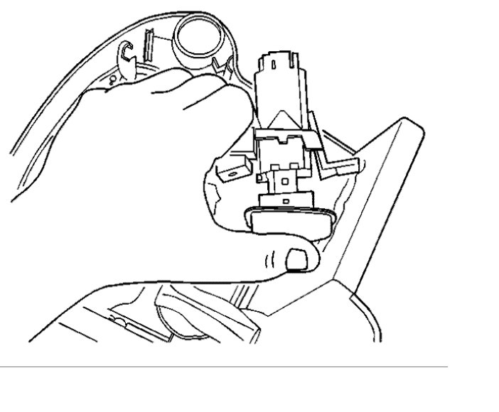

How do I remove the turn signal flasher? It appears to be located behind the fuse panel on the left end of the dash. I haven't figured out how to get to it. I've tried removing the fuse panel itself - won't budge. I've tried removing the lower dash panel (under the steering wheel) and the aluminum panel underneath that - still can't get to it.
It is the GT. I'm not sure what it looks like because I can't even see it. I can hear it, and I can feel the "clicking" coming from behind the fuse panel on the left end of the dash. Fuse panel is accessed while the driver's door is open. Engine is the 3.1 liter V6.
Can anybody give me any ideas?

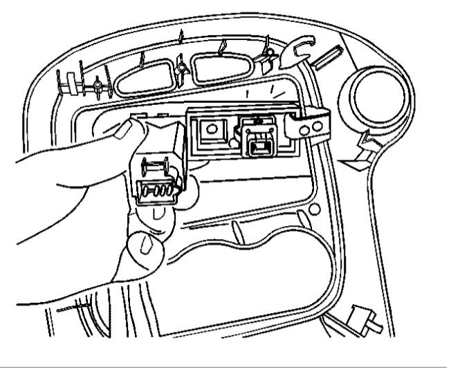

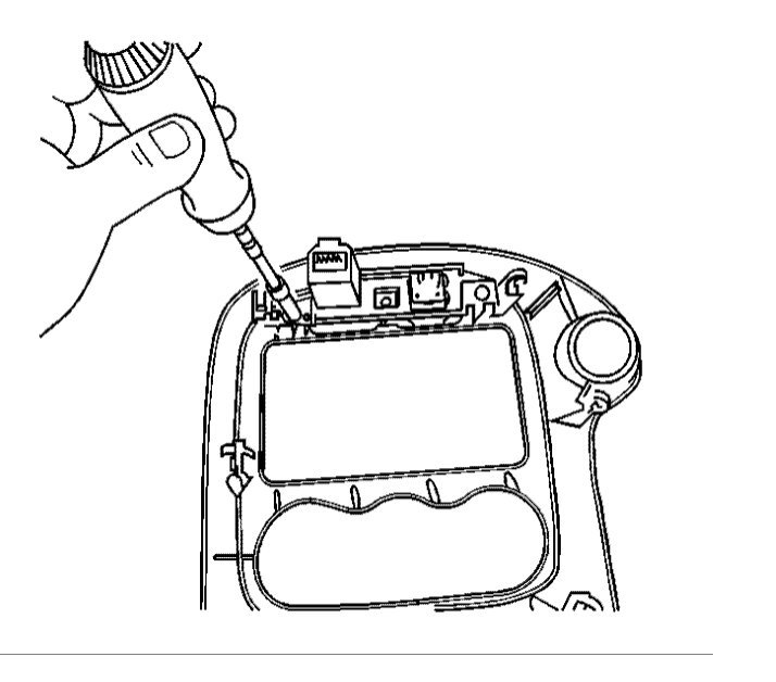

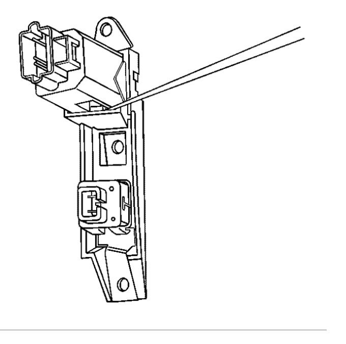

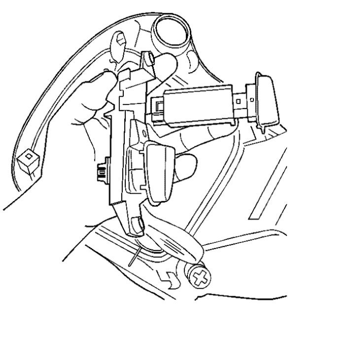

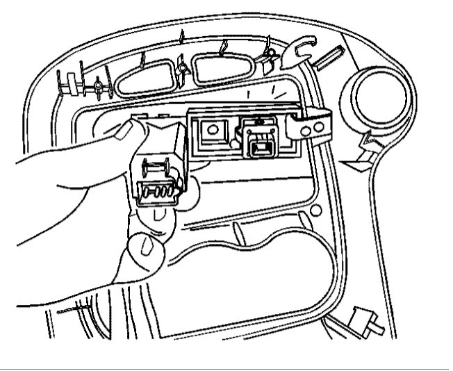

The turn signal flasher on this car is integrated into the hazard switch, Here are some diagrams (below) so you can get the problem fixed. You need to remove the center panel of the dash where the switch is mounted and change it from the backside. Check out the diagrams (Below). Please let us know if you need anything else to get the problem fixed.
