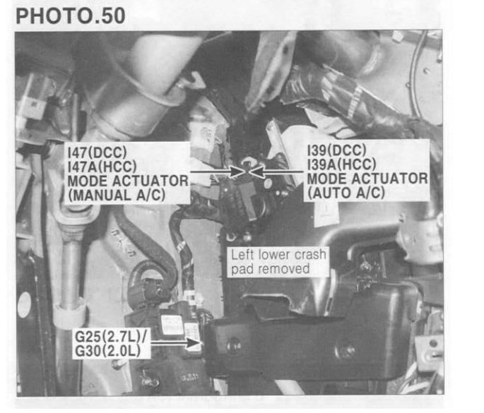

I am trying to find where this is located. I think it must be bad because the a/C comes out of defrost when set to come out of vent. Also hear the same clicking noise many others have reported.
Thanks in advance!
May 20, 2018 at 4:41 AM
Good afternoon.
The actuator is under the dash, left side. I have attached a picture for you to view.
May 20, 2018 at 5:06 AM

Do I need to remove any panels to access it or will it pretty much be visible if I get down there with a flashlight?
Thanks again! Alan
May 20, 2018 at 5:11 AM
The knee bolster or cover above the gas pedal is what needs to come down. It is either held by some plastic clips or a couple of bolts. Then look with a light.
May 20, 2018 at 5:18 AM

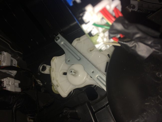

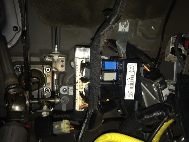

Hey Roy, have another question for you. I am going to attach a few pictures and we will call them 1, 2, and 3 . Picture 1 shows where the actuator attaches. I will just use the old silver mounting bracket as it is the exact same. The old actuator did not have that white plastic part in it. I do not know if it is supposed to be removed, ( I would guess no). So that leaves me with the question, how does the new actuator fit onto the white plastic nipple ( picture 1)?
Help!
Thanks, Alan
May 26, 2018 at 1:27 PM
The bracket has to come off the case and use the bracket with the new actuator.

Okay, let me make sure I understand.
I will take the silver bracket off of the new part, I get that but are you saying that the white plastic piece must be removed from the new actuator prior to installation?
May 27, 2018 at 1:10 AM
The white piece on the car with the bracket has to come off. Do not remove the bracket from the new actuator.

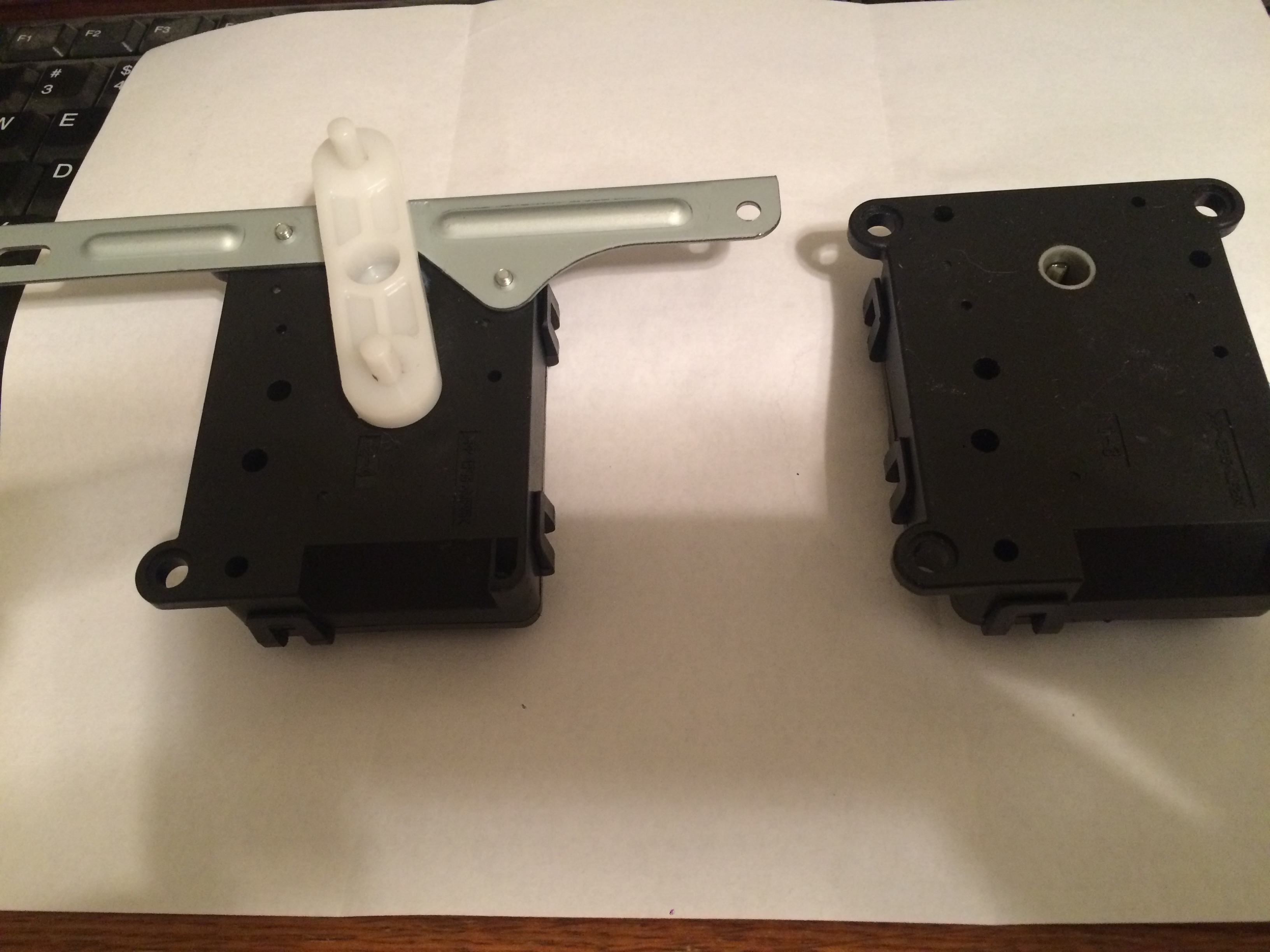

I guess I am still confused.
The white piece of plastic in photo one just sits in place behind the silver bracket.
That part I understand has to stay in place to control the doors.
The new actuator In photo three has the white plastic piece attached to it but the old actuator did not have one.
So I need to cut off that piece?
It is in there good.
Why is it on there in the first place?
Please clarify!
Thanks, Ron
May 27, 2018 at 4:54 AM
ALAN MCLEAN
  • 15 POSTS
Roy, sorry! Darn auto correct.
May 27, 2018 at 4:55 AM
Sorry, got it.
The white piece and bracket are part of the actuator. The old ones have to come off with the old actuator.
You will install the new actuator as it came with the white piece and bracket.
May 27, 2018 at 4:57 AM

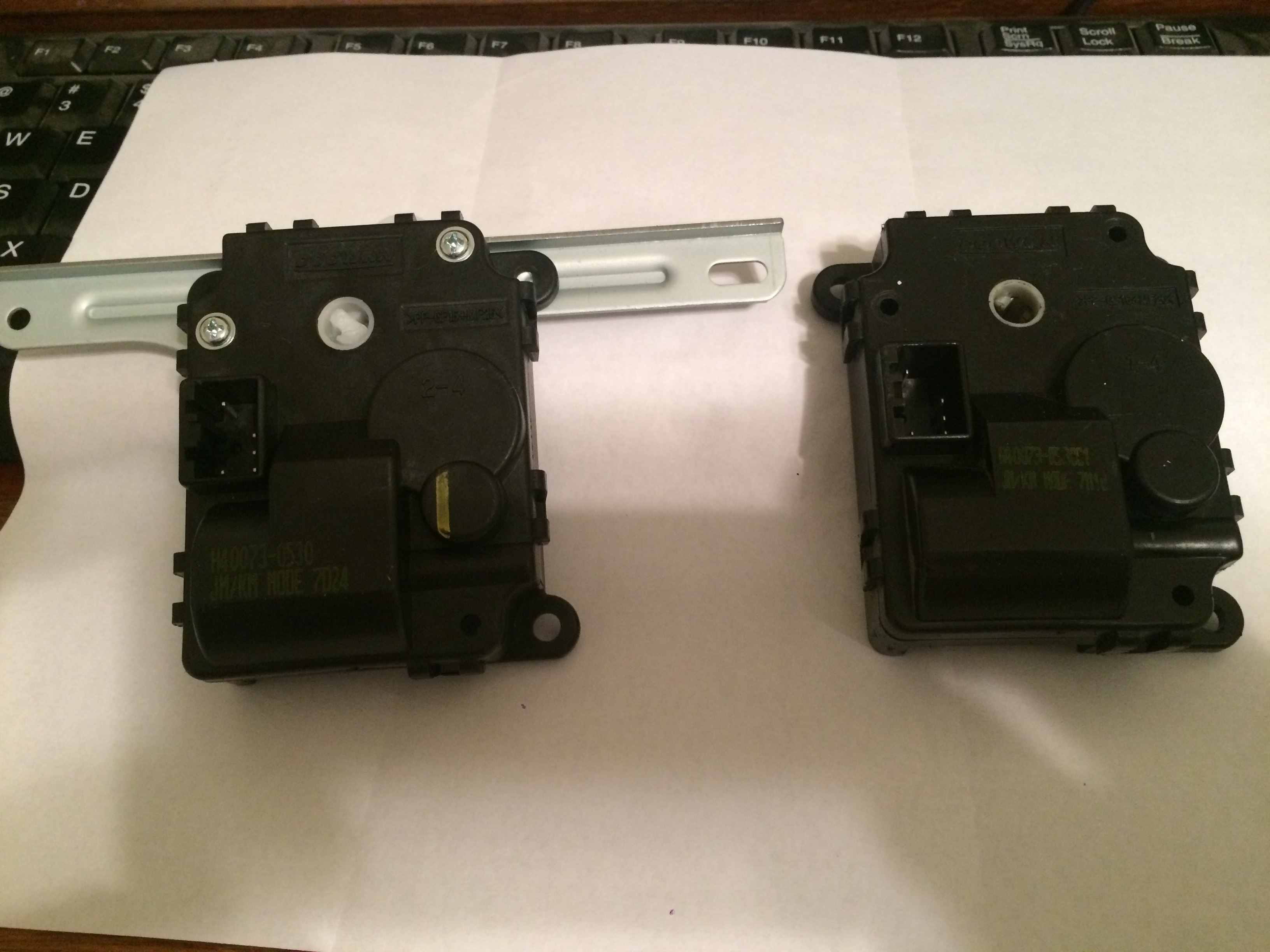

Well, there is no way I have the right part.
While I was taking off the old silver bracket I noticed a third door that that original white piece attached to and controlled.
Back to the drawing board!
May 27, 2018 at 6:55 AM
What is the part number of the actuator you have?

STEVE W.
  • 15,351 POSTS
The new actuator you have needs the plastic piece and the metal bracket removed then it will snap over the piece on the car and the screws will hold it to the bracket that is already there. They use the same actuator on the automatic and manual systems and the same unit fits on other vehicles as well. They sent you one that has "extra" parts that need to come off to be used in your application, that way they just stock one part instead of having five different versions that use the same actuator. The one you have is set up for the 2005-2006 that likes to shear the pins on the plastic arms.

ALAN MCLEAN
  • 15 POSTS
Okay, thanks I appreciate the help. I will see if I can get that white plastic piece off, and the metal bracket which should be easy because that is just screwed in.
May 29, 2018 at 4:12 AM
STEVE W.
  • 15,351 POSTS
The plastic will have a tab that snaps into the inner part of the actuator. Normally you can just use a small flat screwdriver to move the tab and it will come out.
