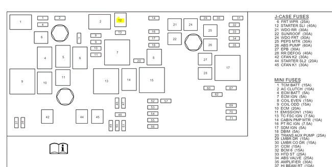

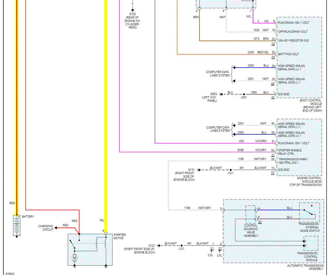

I attached the wiring schematic below for the starting system. If you have a push-button start, let me know. This schematic is for a traditional system.
First, see if it starts in neutral. If it does, then we have an issue with the transmission range sensor (Neutral Safety Switch). If it doesn't change anything, turn the headlamps on and have a helper watch the lights when you turn the key to start. Do they dim? Let me know.

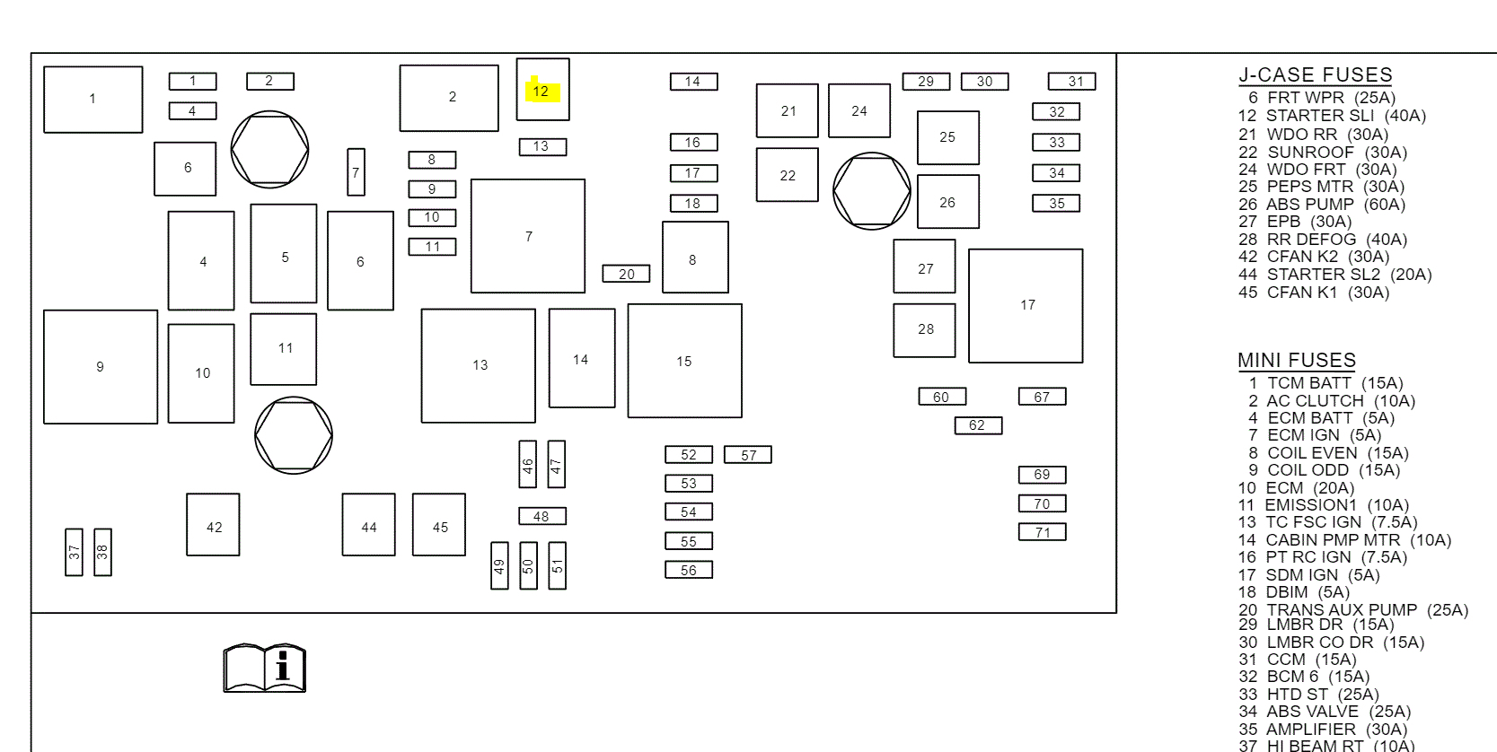

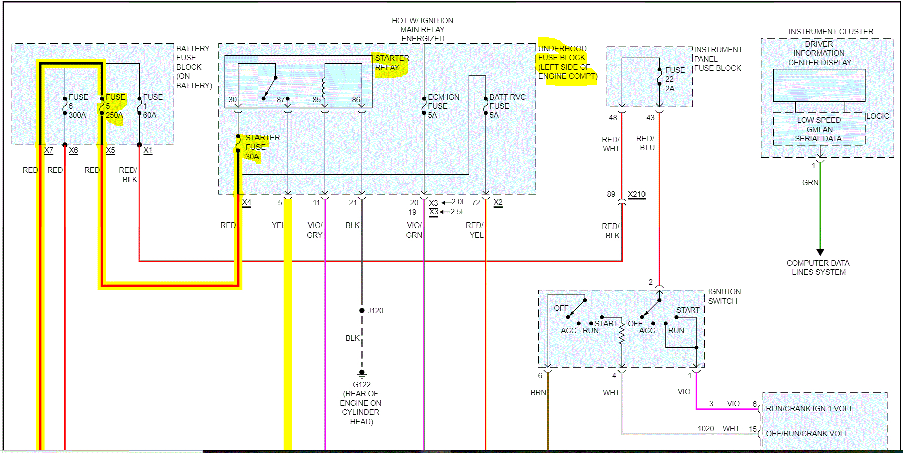

Next, I attached the schematic below and highlighted the starter fuse. I highlighted its location in the under-hood fuse box. Check that fuse. If it is good, confirm there is power to and from it. Here is a link you may find helpful.

It sometimes make motor sound then this morning when I turn it all power left I checked my under-hood fuse box and all seem okay. I had to manually check because I have no tools and to be honest no money to purchase.
