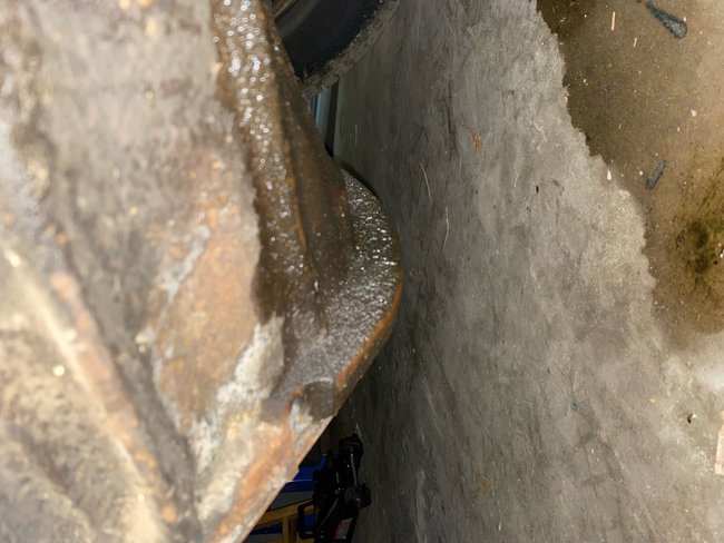

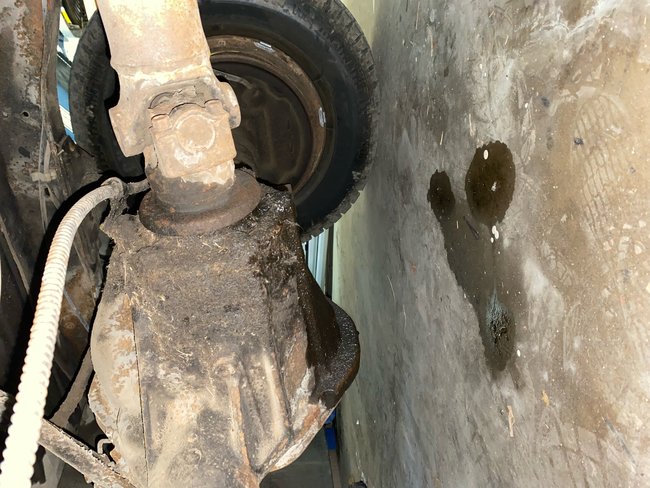

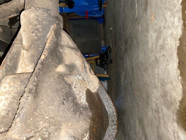

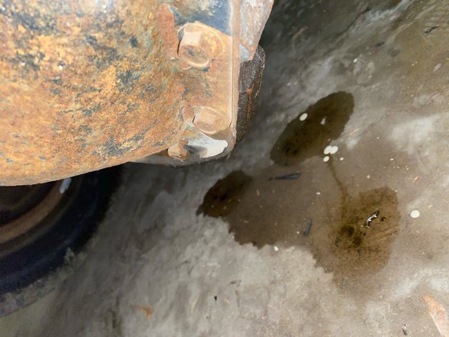

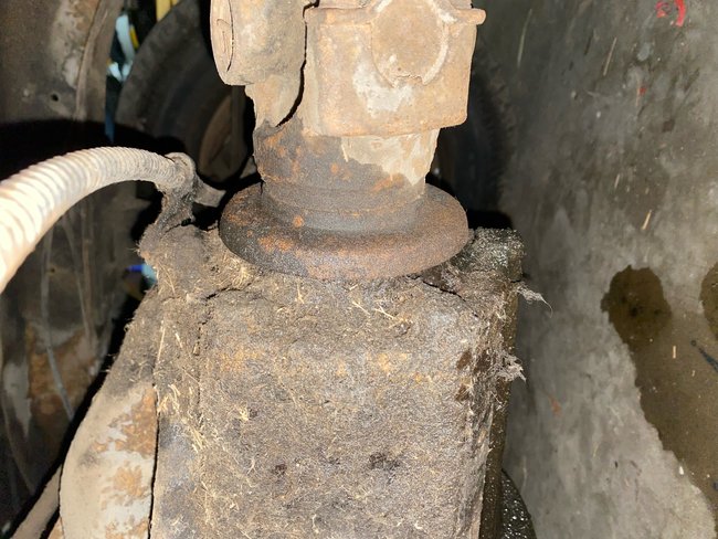

I suspect my rear pinion seal is bad. Can you confirm that by looking at these pictures? If so, can you provide instructions on replacing that?
Apr 12, 2022 at 7:19 AM
Unfortunately, that is what this is.
Based on this amount of oil we need to remove the front cover as well and service the unit. I would clean it out and then put the cover back on and fill it with new fluid after you replace the seal.

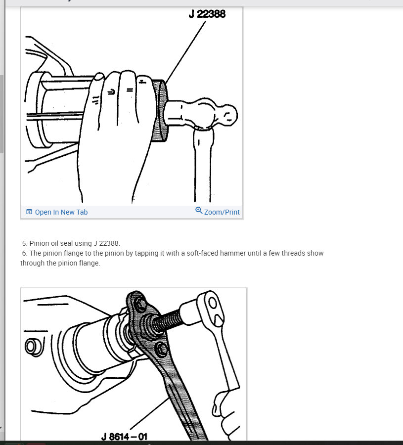

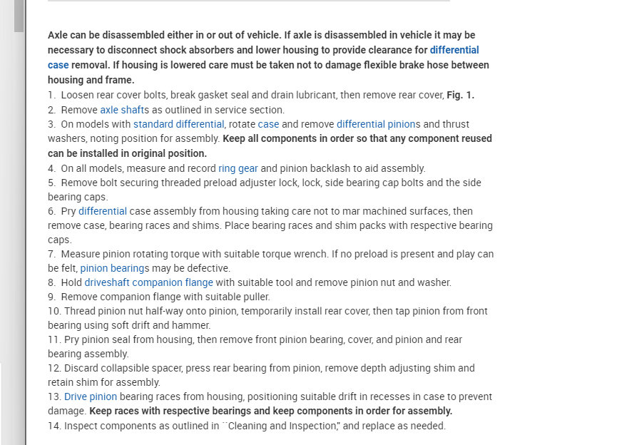

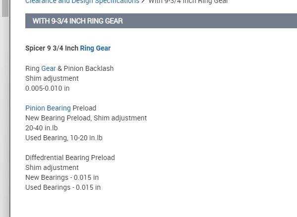

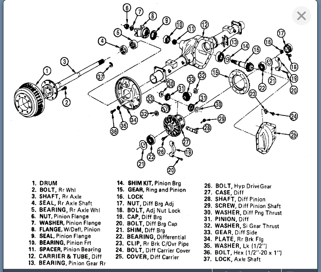

I am attaching the info below on how to replace the seal. Basically, you need to remove the drive shaft, remove the pinion nut and then the seal.
Then install the new seal as shown and then set the preload using the used bearing spec. The turning torque should be around 15-inch lbs.
Please let us know what questions you have.

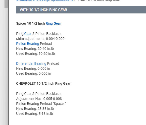

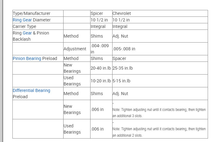

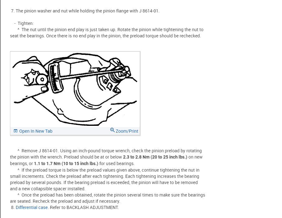

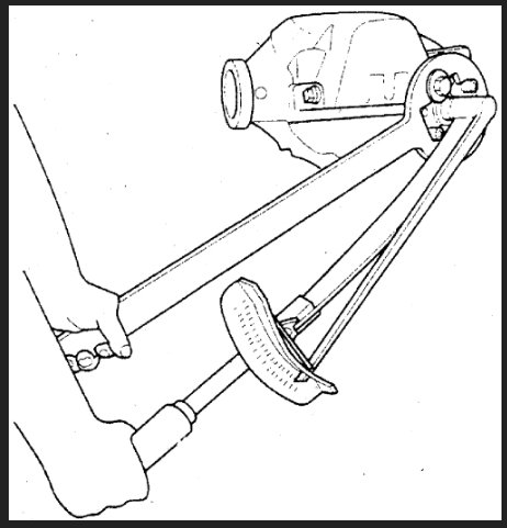

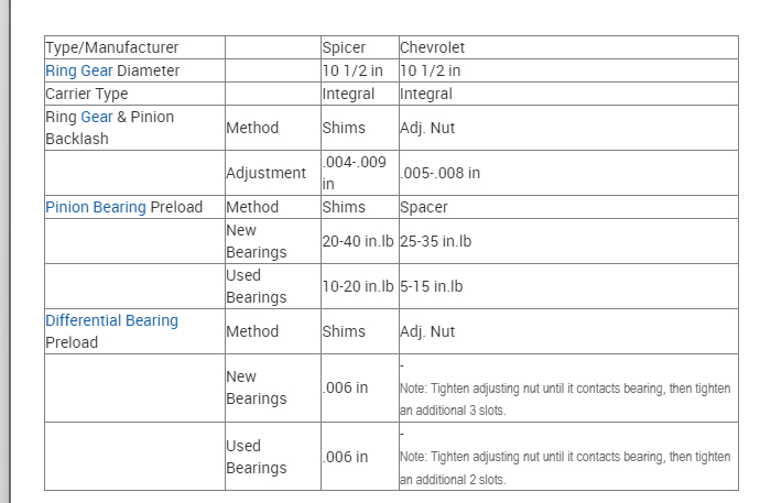

Great question. That is great that you marked the nut so that you can get it close. However, you are correct that it could be overtightened because you have a crush sleeve in there that if you tighten it more then you are crushing the sleeve even more and causing the pre-load to be too much.
I am attaching the spec below, but you need to set the nut so that you have 5–15-inch pounds of turning torque.
This means you tighten it down and line up the mark that you made just like you did, then you use an inch pound torque wrench on the pinion nut to turn the rear end and it should read between 5 -15-inch pounds as the pinion nut turns. In other words, you are measuring the friction or drag that the rear end has when turning from the pinion nut.
If you are in this range, then you have set it back where it was, and you are good to go. If not, then you are going to have to replace the crush sleeve and set it again. However, you cannot use an impact wrench. You are going to have to use a breaker bar on the nut and hold the flange in place with the special tool or pry bar as shown below.

There are a couple ways to do this, and you are correct that the torque spec is pretty high to crush the sleeve.
However, you can't solely rely on this large torque spec because we are concerned with turning torque as this is the drag that the rear end will have when it is turning.
So basically, you crush the sleeve to this large torque spec and then you have to check the turning torque. However, you are not using a new crush sleeve, so you only need to tighten the nut and then check the turning torque.
From what I am hearing you did it correctly. So, I would just check the turning torque as it sits, and I suspect you will be fine.

Okay, great! So, I need an inch-lb torque wrench, and then I need to jack up the truck, so the back wheels are off the ground, remove the drive shaft from the yoke, and attach the torque wrench to the big pinion nut. Then turn it and measure what torque it reads. Is that right?
Apr 25, 2022 at 2:54 AM
That is exactly correct.
Just try to watch the dial as you are turning. The initial break away torque may be higher just to get it turning but the turning torque needs to be between 5 and 15 inch pounds. Make sure you get a torque wrench that has a dial and not a digital readout.
