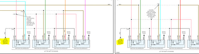

I hope you guys don't mind me jumping in. I read through all the posts you had and wanted to suggest something. These vans with the 6.0 are known to have grounding issues for the coils. All 8 coils are grounded at the same point. The grounds corrode, get loose, and I've seen them actually break and the vehicle not run at all. If you have a weak ground, you may have a weak ignition spark at each plug. It's worth checking.
I attached a portion of the wiring schematic below that shows the ground location. When you check it, make sure to grab onto it and make sure it is in good condition and not corroded or loose.
It's just a theory, but thought it would be good to check.
Take care and let us know what you find or if you have other questions.

Thanks for jumping in on this. It is a very good point but it goes back to one of my original points that I'm not getting any codes and it seems to run very good in all other conditions other than full acceleration under load. It seems that grounding issue would definitely set misfire codes and MIL. As Tom said earlier, it really does feel like a timing issue and it makes me feel like it's related to the VVT system, But I don't know how to check it.

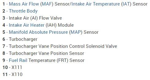

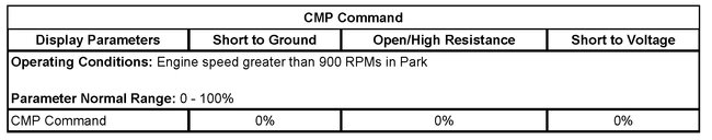

pic 1
Typical Scan Tool Data Table

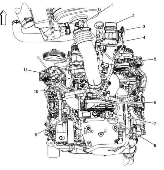

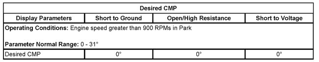

pic 2

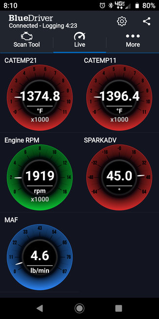

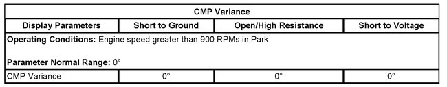

pic 3

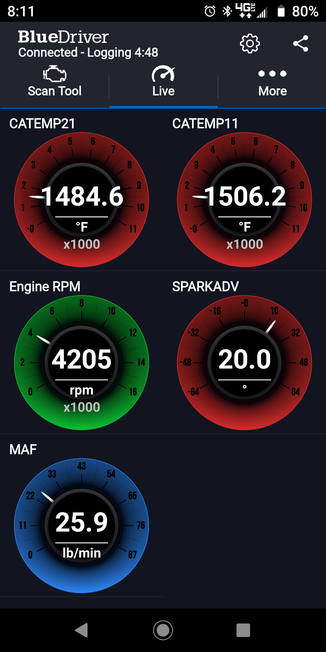

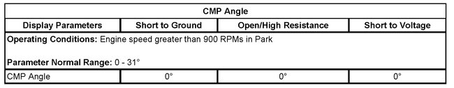

pic 4

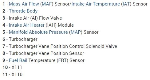

pic 5
Circuit/System Description
The camshaft position (CMP) actuator solenoid is controlled by the engine control module (ECM). The ECM sends a 12 volt, pulse width modulated (PWM) signal to the CMP actuator solenoid. The CMP actuator solenoid positions the CMP actuator spool valve to control the amount of pressurized engine oil, which enters into the CMP actuator assembly. A low reference wire circuit between the CMP actuator solenoid and the ECM completes the electrical circuit. The frequency of the pulse width modulated signal is fixed at 150 Hz. The ECM can only command the CMP actuator to retard the valve timing from the camshaft park position, or advance the valve timing back to the park position. The total range of valve timing command is 31 degrees as measured at the camshaft, or 62 degrees as measured at the crankshaft.

4. Using the output control function of the scan tool, command the CMP actuator solenoid to 25 degrees. The CMP Desired parameter value should match the CMP Angle parameter value.
5. Observe the CMP Variance value, on the scan tool. The CMP Variance value will increment for several seconds, until the CMP Angle value matches the Desired CMP value. The CMP Variance value should then return to zero degrees.
