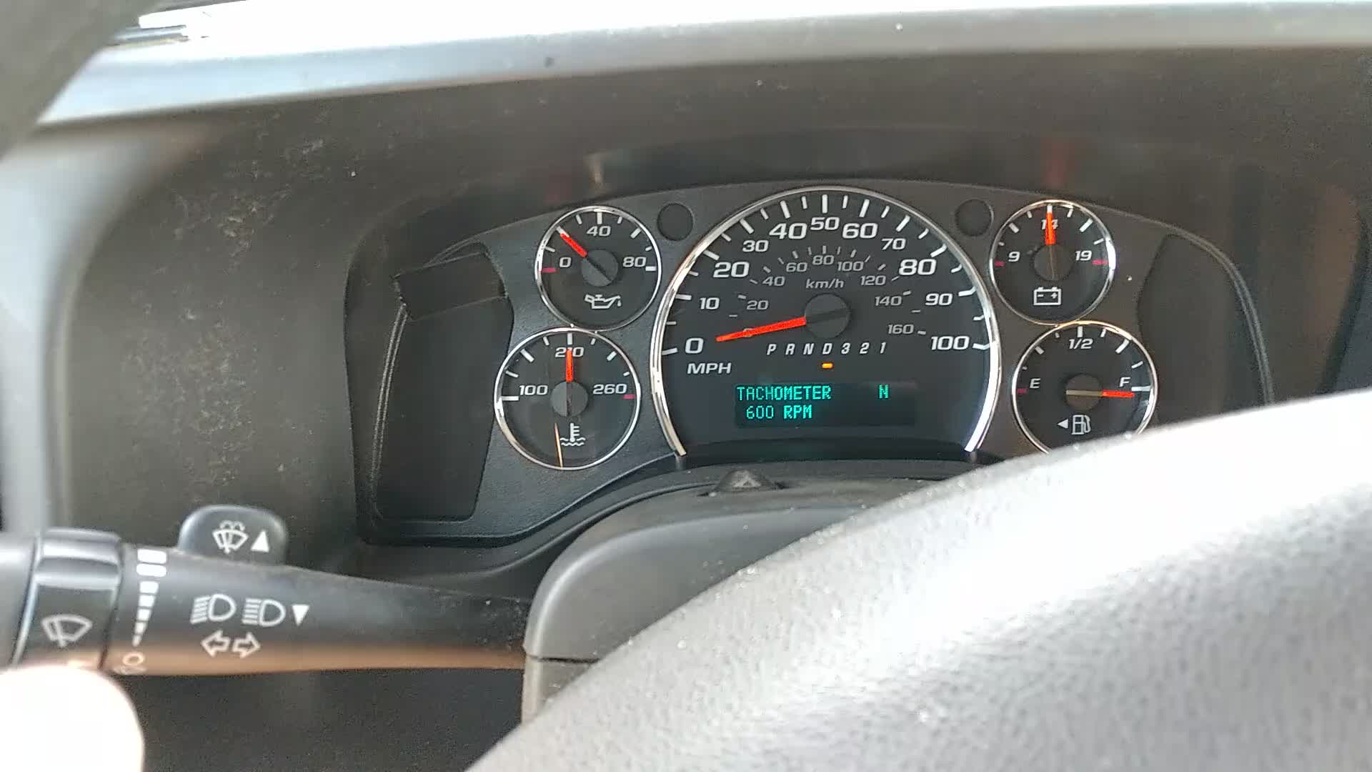

I_MBOWTIE
  • 40 POSTS

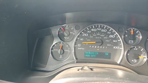

The engine does kinda sound like it's laboring, but also it kinda surges up to speeds when floored. I'll try to get a video, I live in Toledo, OH. I appreciate your efforts and time you've invested in my problem, thank you.

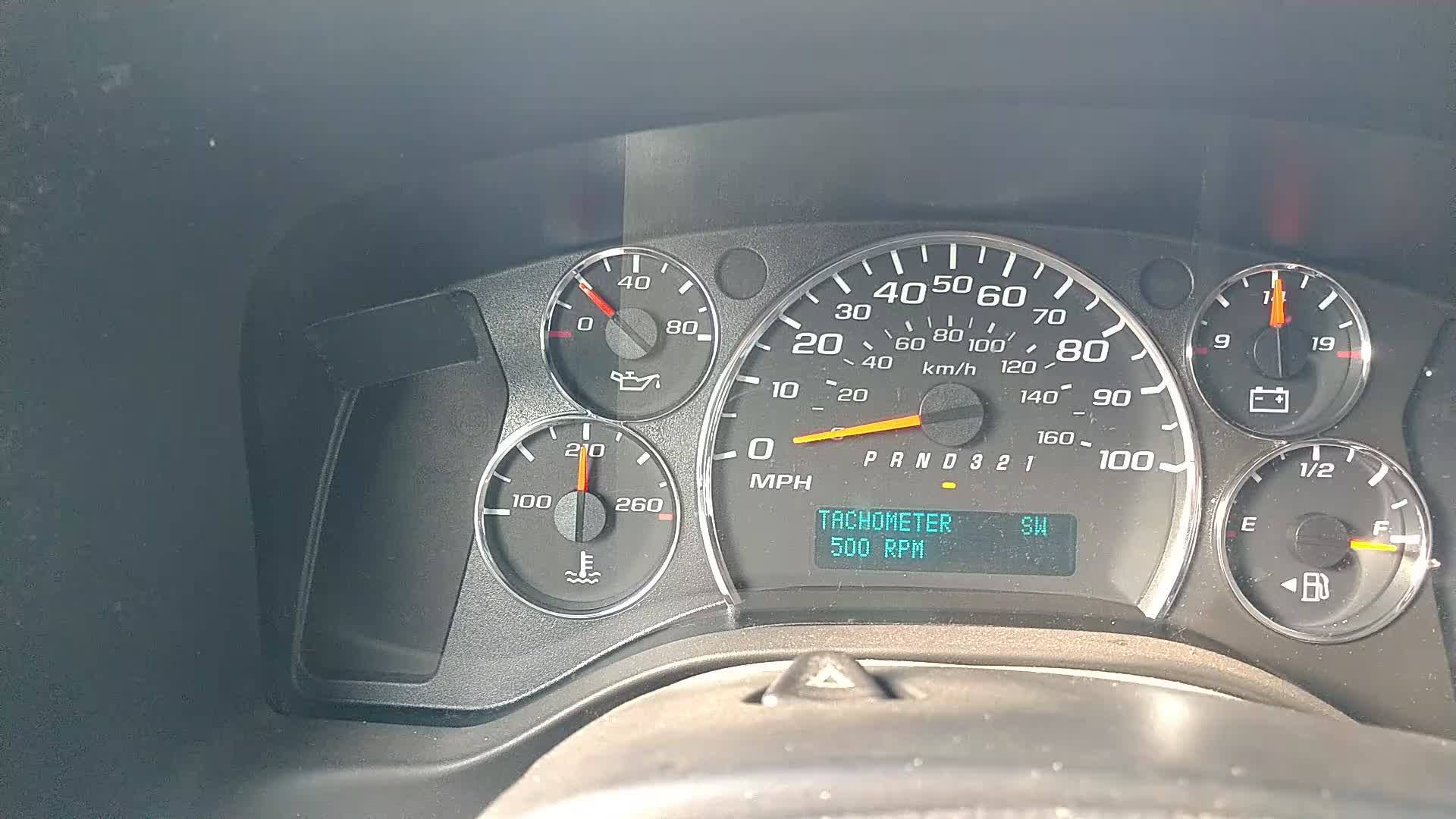

I_MBOWTIE
  • 40 POSTS

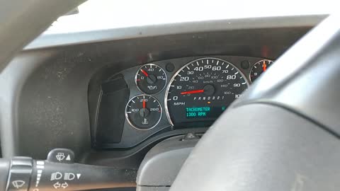

Seems like it is downshifting but maybe not enough. I have the tachometer on the odometer.
Aug 27, 2020 at 12:27 AM
I_MBOWTIE
  • 40 POSTS
I can run it right up to the rev limit. But it takes awhile to get there.
Aug 27, 2020 at 12:31 AM
4DRTOM
  • 467 POSTS
Good Morning,
Thanks for the video.
Being a delivery van and going in and out of the rig all day, water getting in the car is probably common for you. On some vehicles, the IP to body harness connector, which carries the APP signal to the ECM/PCM, is located in the left hand kick panel area and if the kick panel is not sealed properly, water enters and causes a short in the APP circuits. Locate the IP to body harness connector, which should be located in and around the left hand kick panel area. Check to see if there is a water leak into the area.
I got the good headphone out and could hear pretty good. The second one did seem to show that the transmission is kicking down properly. How much cargo are you moving around with that, is is bulky and light or are your loads heavy?
Tom
Aug 27, 2020 at 2:19 AM

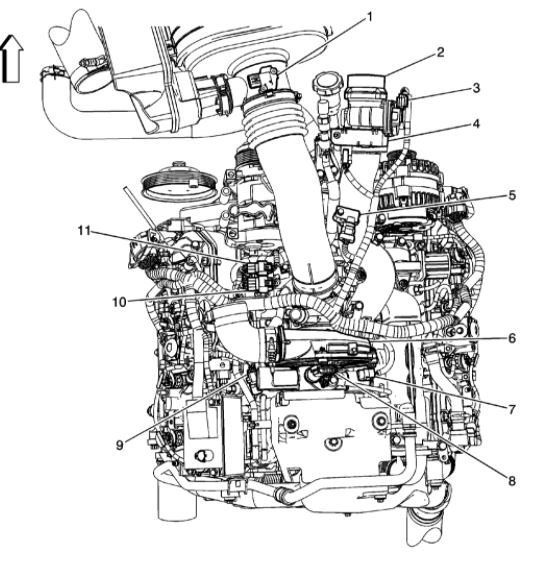

4DRTOM
  • 467 POSTS
Well that's a good question, in the old days you would be looking at the rotor for change here the cams so the valve cover comes of. The other symptoms of the chain and guides being bad would be noise and misfire. I don't think its the issue, I think you should take a good look at the timing chain cover and try to see any form-a-gasket or anything to lead us to believe it was taken apart or if the cover is still factory with the factory installation. Then let me know maybe we have to pay attention to the actuator.
But here, this is the system that matters for a timing issue the actuator maybe is suspect
Camshaft Position (CMP) Actuator System.
The camshaft (CMP) actuator system is an electro-hydraulic operated device used for a variety of engine performance and operational enhancements. These enhancements include lower emission output through exhaust gas dilution of the intake charge in the combustion chamber, a broader engine torque range, and improved fuel economy. The CMP actuator system accomplishes this by, changing the angle or timing of the camshaft, relative to the crankshaft position. The CMP actuator simply allows earlier or later intake and exhaust valve opening, during the four stroke engine cycle. The CMP actuator cannot vary the duration of valve opening, or the valve lift.
During engine "off", engine idling conditions, and engine shutdown, the camshaft actuator is held in the park position. Internal to the CMP actuator assembly is a return spring and a locking pin. During non-phasing modes of the camshaft, the return spring rotates the camshaft back to the park position, and the locking pin retains the CMP actuator sprocket to the camshaft. For the Gen IV small block engines, the park position for the CMP actuator and camshaft is, 8.5 degrees before top dead center (BTDC), which is equal to 17 crankshaft degrees BTDC, to the next cylinder in firing order. The engine control module (ECM) can only command the CMP actuator to retard the valve timing from the park position, or advance the valve timing back to the park position. The total range of valve timing authority is 31 degrees of camshaft rotation, which is equal to 62 degrees of crankshaft rotation. The control range is from the park position of 8.5 degrees camshaft, or 17 degrees of crankshaft BTDC, to 22.5 degrees camshaft, or 45 degrees crankshaft, after top dead center (ATDC).
CMP Actuator System Operation
The camshaft position (CMP) actuator system is controlled by the engine control module (ECM). The ECM sends a pulse width modulated, 12-volt signal to the CMP actuator solenoid to control the amount of pressurized engine oil, into the CMP actuator. A low reference circuit, or ground wire between the CMP actuator solenoid and the ECM completes the electrical circuit. The frequency of the pulse width modulated signal is fixed at 150 Hz. To regulate the pressurized engine oil into the CMP actuator, the solenoid uses electromagnetic force on the solenoid pintle to pulse the oil control spool valve. The pressurized engine oil is sent to unseat the locking pin, and to the vane and rotor assembly of the CMP actuator, to either retard or advance the valve timing. The ECM will control the amount of ON time applied to the solenoid, through the 12-volt signal from the ECM.
The ECM uses the following inputs before assuming control of the CMP actuator, and to calculate the optimum valve timing.
* Engine speed
* Manifold absolute pressure (MAP)
* Throttle position angle
* Camshaft position sensor (CMP)
* Crankshaft position sensor (CKP)
* Crankshaft/camshaft correlation
* Engine coolant temperature (ECT)
* Closed loop fuel control
* Engine oil pressure (EOP)
* Engine oil level
* CMP actuator solenoid circuit state
CMP Actuator Solenoid Circuit Diagnostics
The engine control module (ECM) monitors the control circuit of the camshaft position (CMP) actuator solenoid for electrical faults. The control module has the ability to determine if a control circuit is open, shorted high, or shorted low. If the control module detects a fault with the CMP actuator solenoid control circuit, DTC P0010 will set.
CMP Actuator System Performance Diagnostic
The engine control module (ECM) monitors the performance of the camshaft position (CMP) actuator system by monitoring the calibrated desired position, and the actual position of the camshaft, through the 4X signal of the CMP sensor. If the difference between the actual and desired position is greater than a calibrated angle, for more than a calibrated amount of time, DTC P0011 will set.

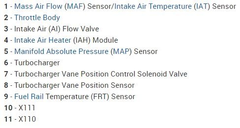

This truck isn't turbo is it? What about the size of the tire? Are they the stock size or the same as the comparison van
Here is why I ask about Turbo because it must be and we have been chasing our tails looking for everything besides the obvious. Is this your motor in the attachment below?
Let me know,
Tom

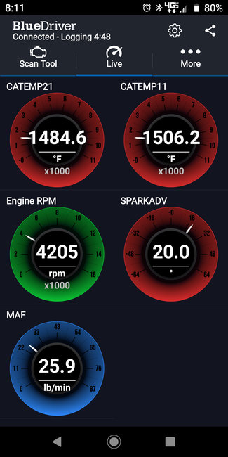

I curious about your combustion efficiency, with a good burn and everything working right you should be getting water drips out of your tail pipe. Take a look at that, let me know if you have a clean burn with water coming out of the pipe or if you have black carbon build up on the inside of the exhaust pipe. Also don't remember if you said whether or not the clutch fan is locked up or not. I think you just said you could hear it not that you went out and feel how much resistance it had not running. Ken does have something with the MAP. Does you scanner have live capabilities? If so we might be able to get some direction at watching that while driving.

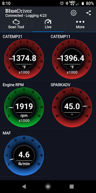

I_MBOWTIE
  • 40 POSTS
Yes I get drops of water, and also some black carbon but not a lot. Yes, my fan clutch is working, and yes, I can read limited live data. I have a Blue Driver code reader. It's pretty good after market unit.
https://www.bluedriver.com/products/bluedriver-scan-tool
Sep 1, 2020 at 4:37 AM

Okay, that's interesting to have both because the water is showing the engine is working good or has perfect combustion but having the carbon on there is saying that something is wrong with combustion and its loading up. It usually is one or the other. Are you having better or worse take off when its cold as opposed to it being warmed up? I wondering if there is something happening with the engine temperature changing the condition.of the burn. Can you send me a freeze frame of the live data for the oxygen sensors to see the catalytic function when your pushing the engine. We have to have a problem there in the catalytic's with all we have gone through and if the MAP is truly working fine, Ken does have a good point with that possibility, we have to have them partially clogged.

I_MBOWTIE
  • 40 POSTS
Well, there is no freeze frame data saved when there is no MIL and since it never sets any codes there is no data saved. I'll try to send live data image. The first one is at 60 mph and the second one is WOT.
