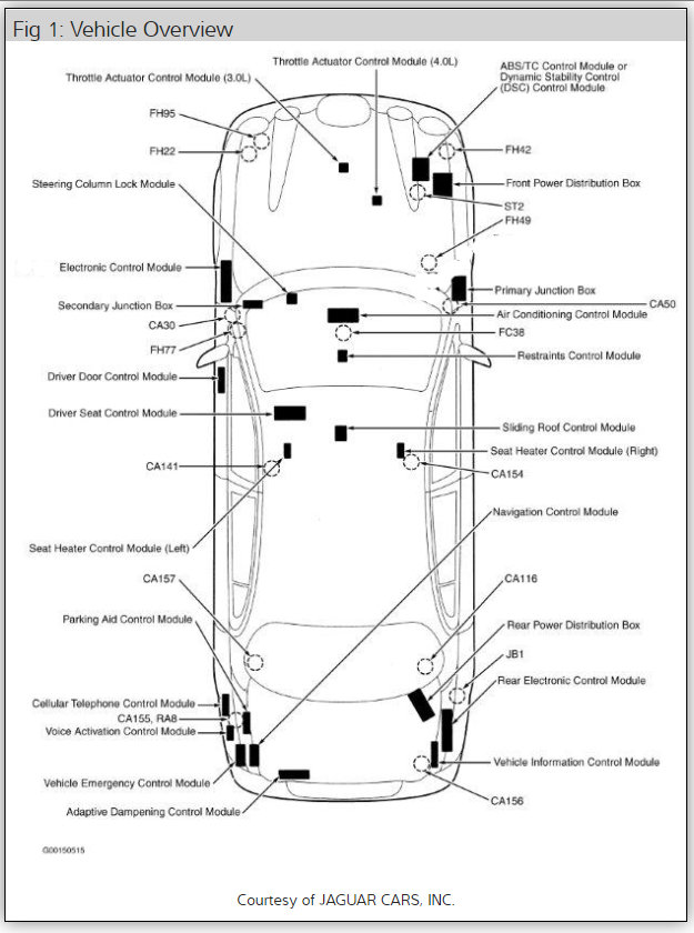

Car starting okay and some times not starting the security system light blinking.
Jul 27, 2018 at 10:39 PM
  • 55,746 POSTS

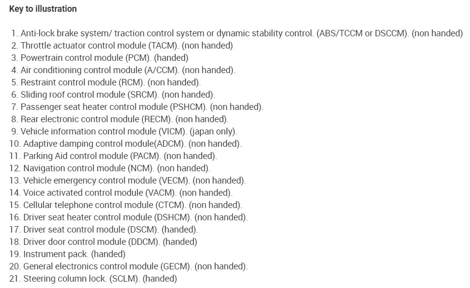

The security light is the issue. It sounds like the BCM is going out. But first I would remove the BCM and check the connectors for corrosion which will cause the issue here is the location below. They call it an general control module BTW.
Check out the diagrams (below). Please let us know what you find.

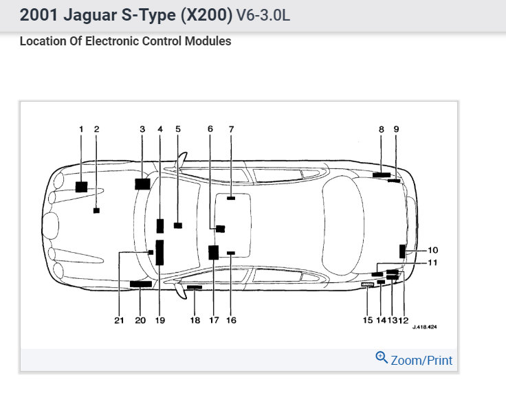

Dear,
Do you mean to check all these modules one by one? The car starting when it is cold and once parked will not start until one or two hours normally. Could you please explain what to check exactly instead of going through all these modules? Thanks
Ramzi
Jul 30, 2018 at 2:51 AM
  • 55,746 POSTS
Please check the number 20 module only which controls the security system. Look at the connectors you will not be able to test the module we are just looking for obvious water damage.

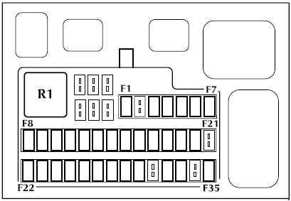

The passenger compartment fuse box is located on the right-hand side trim panel in the footwell.
I have checked this, but all okay.

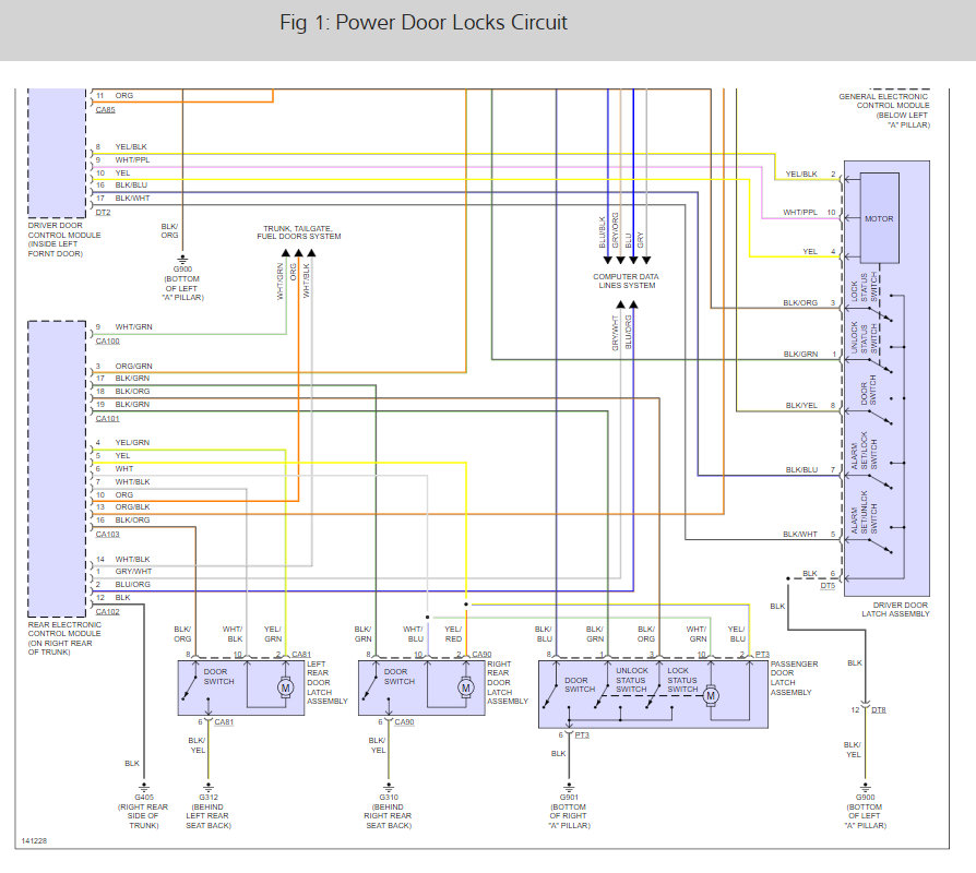

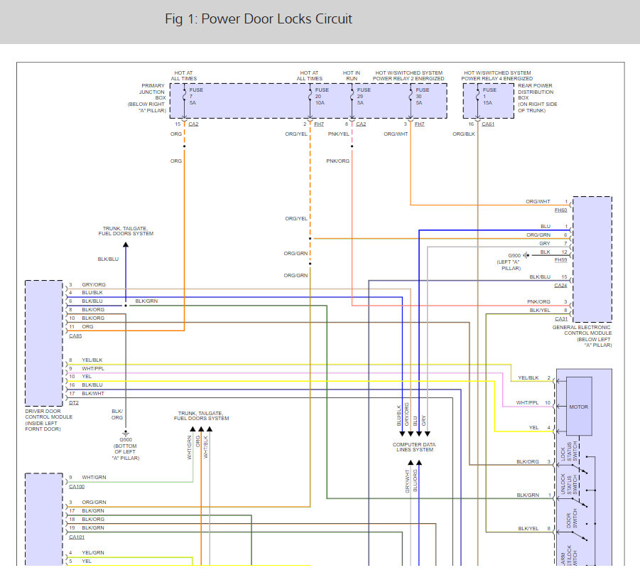

Yes Ken, I have a problem with the door locks. It will not lock from driver door, it locks from left front passenger door normally only if I get inside the car. Also, locks open by remote and close again immediately after clicking the remote to open, have to be quick to pull and open the door.
The passenger door will not open by remote.

Yes! We are getting closer. There is a driver door lock module that sound like it is going out. Here is a wiring diagram so you can see how the system works and the location of the door module try to find a used one first.

Dear Ken,
I have changed the door control module but it is the same, mean there is no fault with it. I guess the left rear door latch is bad. I will change it also with second hand working one and see if it works. I will let you know.

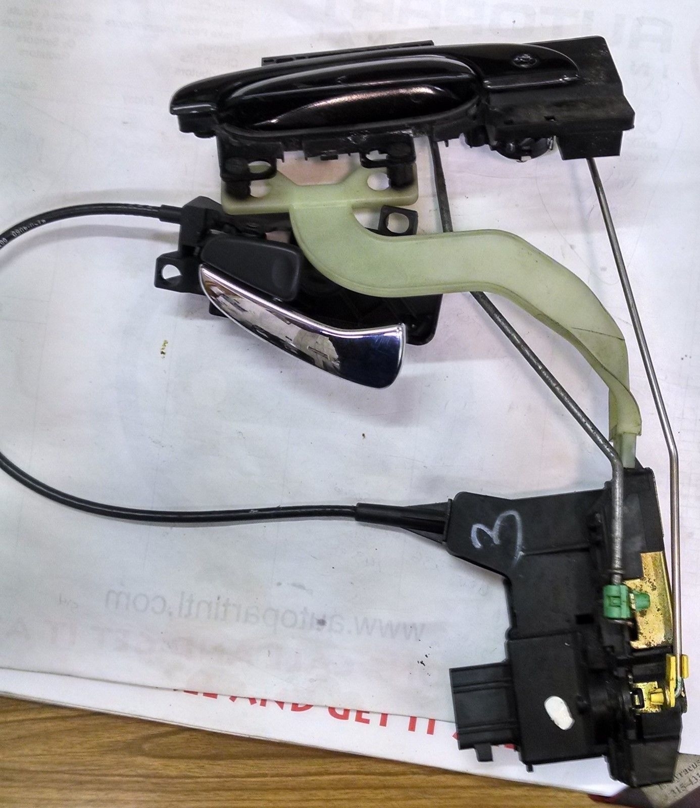

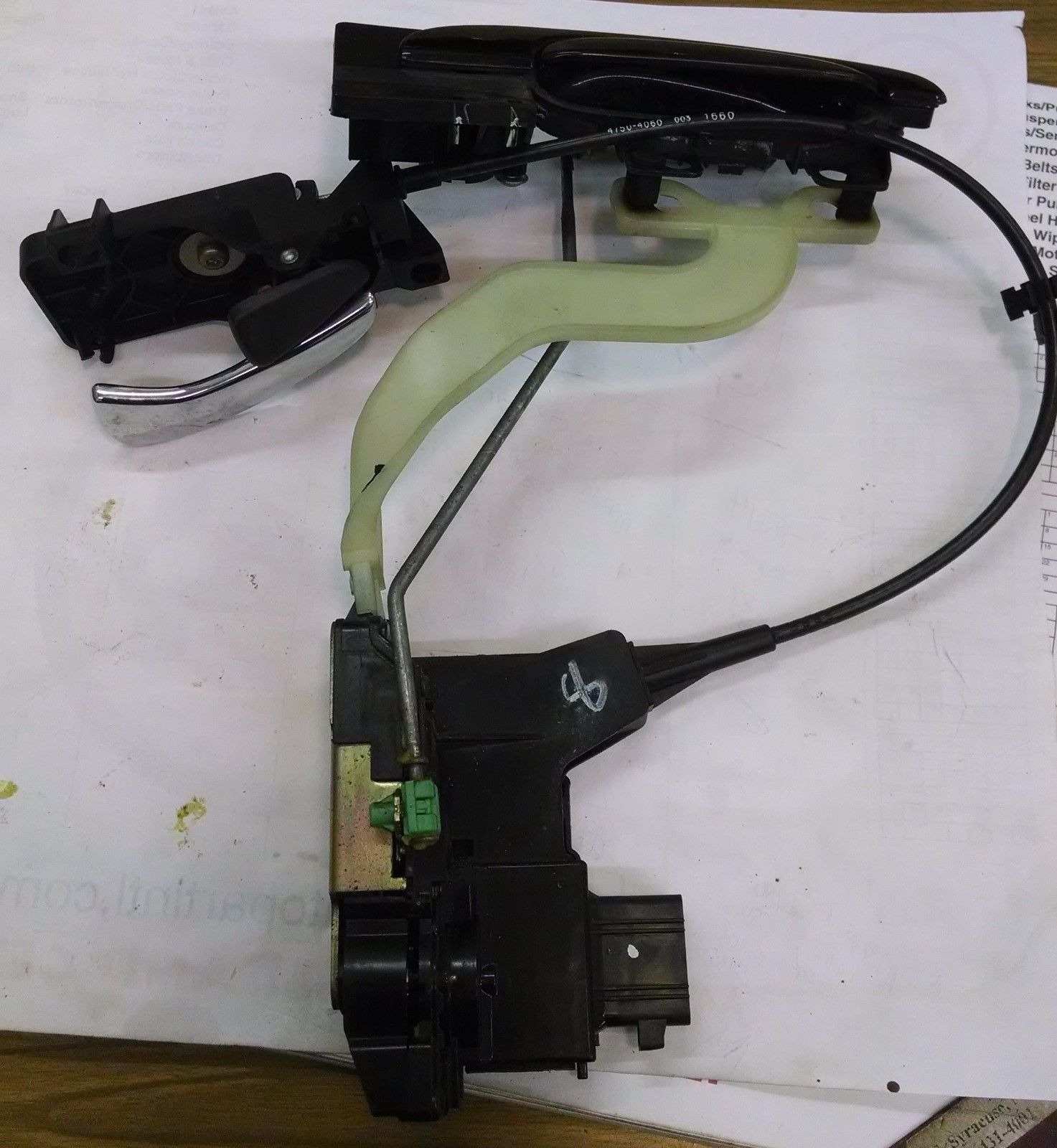

Just received two front side full set lock and latches, will be changed soon and let you know what happen.
See pictures.

I disconnect the battery and changed the two front locks and latches, it took almost one hour
changing it, again reconnect the battery and the complete locks on four doors are working perfect but the security light still blinking. Again I disconnect the battery and wait for twenty minutes and reconnect it, the security light went off and the car started normally.
I tried several times switching off the car and lock it, open it with the remote it is working perfect, running the engine, it runs normal, the security light on once and when engine starts the security light went off as it should be.
