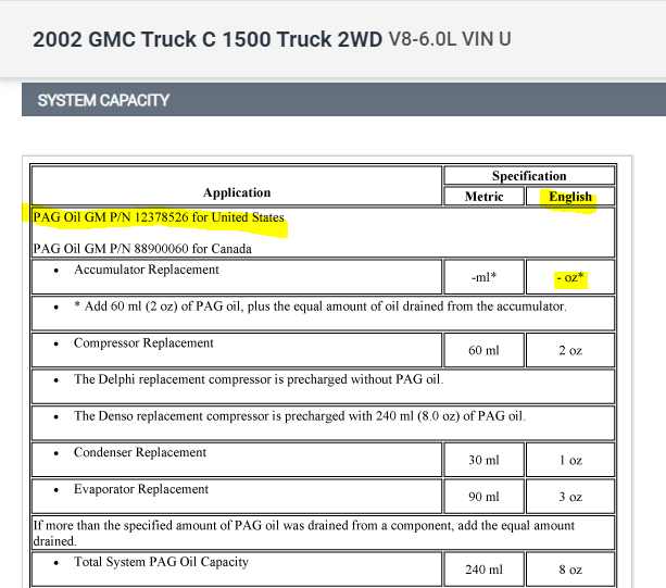

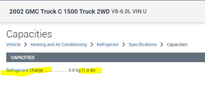

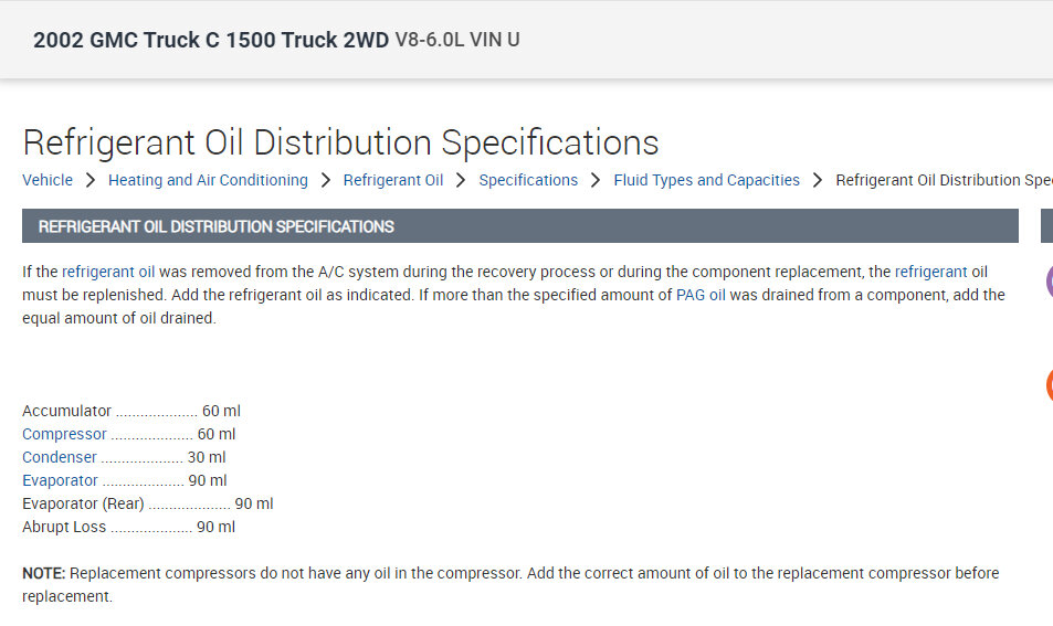

  • 110,176 POSTS
Pic 1 below shows the amount of freon needed for the system, 1.8 lbs. Pics 2 and 3 are related to the PAG oil.
If you look at pics 2 and 3, they indicate how much should be added based on what component was replaced.
I'm not sure if you only replaced the condenser or not, but it is listed.
Let me know if this helps.
