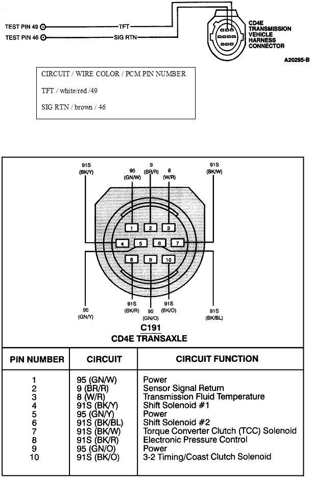

Haven't looked at the high idle problem because I decided to take the car for a drive. A problem with the transmission shifting became apparent. At first it wouldn't go into reverse. After moving the shift lever back and forth a few times reverse finally engaged. When starting off in drive the trans wouldn't shift into 1st, it stayed in 3rd. It would only downshift if I moved the lever into the first position. Then it would shift into 2nd if I moved the lever but it would always start off from a complete stop in 3rd when in drive.
That car has been sitting for at least 3 years and I wondered if the solenoid valves got sticky or do you think it is an electrical problem?

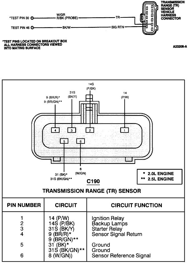

The car was running fine, I was able to drive it around a little. So then I started checking the other systems. I turned on the heater blower and it's fuse went. Rather than taking the dash apart I made a bypass to a toggle switch. But now the backup lights and the starter won't energize. I was checking the range sensor switch and two of the wires came out of the plug. I have the electrical schematics as well as Alldata DIY and I don't think their picture of the plug is correct. Could you tell me exactly which wire goes where and what is the viewing angle of the plug and the switch?

Here's everything I found related to the transmission.
