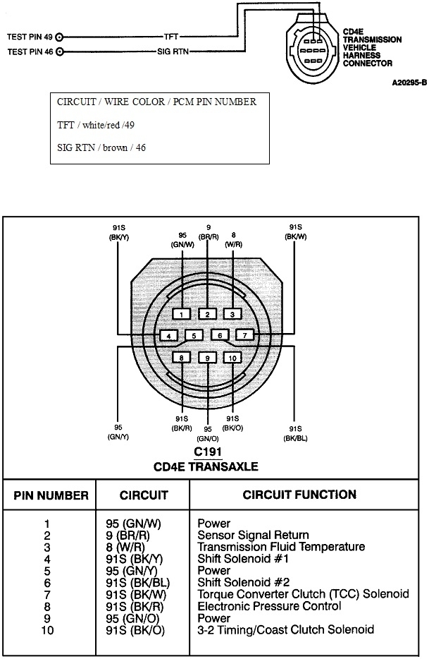

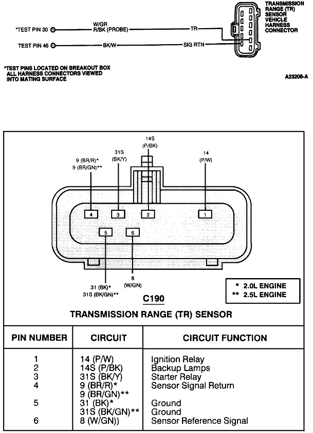

The car was running fine, I was able to drive it around a little. So then I started checking the other systems. I turned on the heater blower and it's fuse went. Rather than taking the dash apart I made a bypass to a toggle switch. But now the backup lights and the starter won't energize. I was checking the range sensor switch and two of the wires came out of the plug. I have the electrical schematics as well as Alldata DIY and I don't think their picture of the plug is correct. Could you tell me exactly which wire goes where and what is the viewing angle of the plug and the switch?
Sunday, February 7th, 2021 AT 5:55 PM
CARADIODOC
  • 33,916 POSTS
Here's everything I found related to the transmission.
