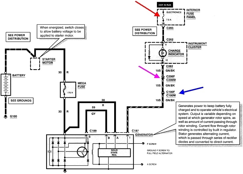

I overlooked that you already posted the warning light isn't working. That would mean you were on the right track with the green / black wire. First check the 7.5-amp fuse that feeds that circuit. For the benefit of others researching this topic, the only information about the inside fuse box location is, "The fuse junction panel is located to left of steering column and is attached to the instrument panel.".

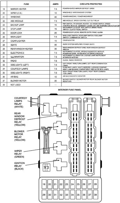

The second drawing shows the fuse box layout, but they used different designations between that drawing and the wiring diagram. You'll have to check all the 7.5-amp fuses.
After that fuse, the warning light bulb comes next. Even if that is burned out, there is always a resistor in parallel with it to get the charging system started. In that case, the only symptom would be the lack of the warning light turning on when the ignition switch is turned to "run".
Next, there's two connectors in the green / black wire. They're pointed out with the purple and blue arrows. There's no drawing to show the locations. They're listed as:
C206 Under LH side of I/P, above interior fuse panel
C100 LH side of engine compartment, near strut tower
C100 sounds like a good place to find the green / black wire. If you can find that, tell me what you find for voltage there. Here again it will be more accurate if taken with the plug connected.

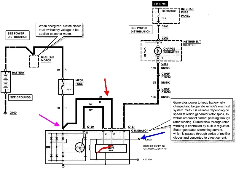

Running new wires is almost always a bad idea. It's one thing when there's an open, meaning a break in the original wire that you can't find or is hard to reach, but a lot of people run new wires when the original one is shorted to ground, or worse yet, intermittently shorted. I always insisted my students locate the short or narrow it down to the closest possible points, as in connectors or accessible splices. The reason for doing that is you don't know yet what caused the short. Common causes are a wire harness that fell down onto hot exhaust parts, a harness draped over the sharp edge of a metal mounting bracket, harnesses that slide back and forth on the body sheet metal as the engine rocks, and corrosion between multiple adjacent terminals in a connector. Any one of those will likely lead to additional wires and circuits meeting the same fate in the near future, then you have to start the diagnosis all over again. By finding the location of the original defect, you'll see those other wires and take care of them before they become a new problem.
If you were to find a badly-corroded section in the fat wire running from the generator to the battery, that would be a legitimate reason to run a new wire. Ford especially had problems with this on their battery cables where they attach to the starter motor. The corrosion runs up the cable or wire well past the end of the insulation, so you can't see all of it. You need to cut the wire back far enough to reach shiny copper so solder will adhere to it, but that could mean cutting off a few feet. By that time, just cut the entire wire off at both ends and run a new one.
When you have such a large maxi fuse, 175-amp in this case, it is going to be bolted into the fuse box. Often it's hard to tell if they're blown. A fast way to tell is you should find full battery voltage on the generator's output stud all the time. If the fuse is blown, you'll find 0 volts there with the engine off. Your observation the "Charge" light turns off when the engine is running tells us the generator is working. In that case, you're going to find normal charging voltage of 13.75 to 14.75 volts on the generator's output stud with the engine running, or even a little higher, but it won't be getting back to the battery.
The clinker here is the voltage regulator has to have battery voltage on the smaller red wire at the "A" terminal for the system to work, and that comes through the maxi fuse, so the fuse has to be okay. Most Ford models have a separate circuit for that wire, with it's own ten or 15-amp fuse, and that fuse is a common cause of failure-to-charge.
The only other thing I can think of, but isn't likely, is the generator would "self-excite" due to residual magnetism in the rotor, then the small output would feed the "A" terminal, and from there, the generator would get up and running. That is how GM's older generators were used on hot rods. They had just the one output wire going to the battery. The voltage regulator was also built in, so it was a self-contained system with no other wires. It was expected to self-excite and start operating on its own.

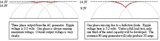

When it starts producing output, a sample of that is tapped off and appears on the white or white / black wire. (It's shown as gray on your diagram). That will be around 6 - 7 volts. That wire goes right into the voltage regulator and it's that voltage that tells the regulator the generator is working. In response, the regulator puts full battery voltage back out on the green / black wire. With full voltage there, and full voltage on the other side of the dash light, the difference is 0 volts, so the warning light turns off.
The interesting thing is all "AC generators", (aka "alternator), put out three phase output which is very smooth compared to rectified 60 cycle single-phase house current. That gray wire taps off just one of those three phases, so only that one phase has to be working to turn the warning light off.
When one of the six main diodes fails, you lose one phase of output. Because of the interaction between the phases, each diode is used in multiple phases, but at different times. As a result, when one of the three phases is lost, you will lose exactly two-thirds of the generator's output capacity. A common 90-amp generator will only develop a maximum of around 28 - 32 amps under a full-load test. That's enough to keep an older vehicle going, but with all the electronics on newer models, the battery will have to make up the difference as it slowly runs down over days or weeks.
If a second diode fails, you could lose even more output capacity, as long as it's the right second diode. They call them the three "negative" diodes and the three "positive" diodes. Both are exactly the same electrically. The polarity designation actually refers to how they're placed in the circuit. If one positive diode, for example, were to short, you'd lose that one phase of output, but if any one of the negative diodes also shorts later, that would create a dead short to ground and the 175-amp maxi-fuse would blow. We know that's not the case here because you found battery voltage on the output stud. That had to come through the maxi-fuse.
All three positive diodes or all three negative diodes could short, (extremely unlikely), and you'd have no output at all, but in either case, it's the good diodes that would still stand in the way of causing a dead short to ground.
The point is, you can have two failed negative diodes or two failed positive diodes, resulting in very low output capacity, but if the phase that the gray wire is tapped off is the one that's still working, the voltage regulator will see that as a working generator and it will turn off the warning light. I've run into a number of generators with a failed diode, but never with two, so I don't know what kind of output you'd be able to get.
Here's a drawing I put together to show another dimension to this story. The left chart shows the overlapping output from three properly-working phases. The red line shows the output voltage that would be seen at the generator's output stud. That's called the "ripple" voltage and gets measured by most charging system testers other than the less-complicated hand-held type. That's the same voltage that goes right back through the regulator on the smaller red wire, and is what provides the current to run the field winding which creates the rotating magnetic field.
The second chart shows that ripple voltage goes way up when one phase is missing due to a failed diode. Two things are different than in the past with this regulator. First, older voltage regulators turned the warning light on if generator output went to "0". This regulator can also turn the light on if output voltage goes low or too high. Second, this type of regulator circuit can respond in one of two ways when ripple voltage is high due to the failed diode. Some will see the 9.3 volts I used in the chart and respond by trying to get charging voltage back up. Output voltage could reach 16 volts or more, but the regulator is still seeing 9.3 volts. Testing this system would show output voltage is too high while full-load output current is one-third of what it should be. Conclusion would be a failed diode / replace the generator.
Some voltage regulator designs respond to the high point of the ripple voltage, in this case a perfect 14.5 volts. In response they wouldn't try to change anything, but since it's the same ripple voltage that feeds the field winding, during the times the ripple voltage drops to 9.3 volts, it's that lower voltage that would create a much weaker electromagnetic field, and therefore much lower output current. Lower output current is the result of lower output voltage, and that turns right around and creates a lower magnetic field. It's a vicious circle that makes output voltage drop a lot during that missing phase, but the regulator still sees the 14.5 volts and thinks everything is normal. With this regulator design, under the full-load test, you'd again find output current to be one-third of the generator's maximum rating, but output voltage would look okay.
All of these test results can be aggravated by digital voltmeters. They take a reading, analyze it, then display the results while it takes the next reading. Some of the fastest meters might take two or three readings per second, and one of those could be right in the middle of the missing phase, and the next one could be when a different phase is producing its highest voltage. The meter's display would be bouncing around and would likely be hard to read. The battery will smooth those voltage fluctuations out a lot, so you may get a usable reading right across the battery terminals, but the reading at the other end of that fat wire at the generator's output stud is bouncing around. Even though that's just a big wire with very little resistance in it, it only takes a tiny amount of resistance to make the readings different at each end. Partly for convenience, but also partly because of this smoother meter readings at the battery is why professional charging system testers have us connect the voltmeter leads at the battery and not at the generator.
To answer your original question, see what you have for voltage on the generator's output stud with the engine running. It needs to be between 13.75 and 14.75 volts. All generators are inefficient at low speeds, so testing is normally specified with engine speed at 2,000 rpm. For the testing you're doing, it is sufficient to simply raise engine speed a little. Let me know what you find there.
If the voltage stays at battery voltage of 12.6 volts or less, there could be some other defect inside the generator, but also check for a loose belt. Yours uses a bolted-on pulley. I suppose that nut could work loose, but I suspect things would have gotten worse real quickly, as in the pulley and belt fell off. A lot of newer models are using a clutch-type pulley that is supposed to reduce vibration. A friend gave me one that he replaced after it seized, but I can't remember the symptoms he ran into. I could see how they could get weak and slip too. Belt slippage with a serpentine belt is pretty uncommon unless the spring-loaded tensioner pulley is weak, but then you'd hear the belt squeal. On older GM and Ford generators that had the fan outside right behind the pulley, push on a blade of that fan with your thumb. (For others researching this topic, . . do that with the engine not running!). Those mostly go back to the days of V-belts. If the pulley can be spun and it slips under the belt, that belt is too loose or it has worn on the sides until it is running on the bottom of the pulley instead of being gripped on the two sides. When the belt is tight enough, it's pretty common to be able to turn the crankshaft just by pushing on the generator's fan blade. In this case of "tight is good", tighter is not better. Over-tightening the belt puts too much stress on bearings. That can lead to early failure of the water pump, power steering pump, or generator bearings.

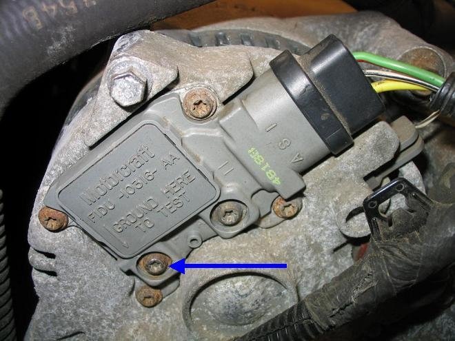

This photo is from a Tempo, but your regulator should look the same. The blue arrow is pointing to the screw head that needs to be grounded with a clip lead or any piece of wire. You'll note that this one is rather rusty, so it would be necessary to scratch at it a little to make a good momentary connection. Same with the surface corrosion on the generator's housing.
If this works, you'll suddenly hear the generator whine a little, and load the engine down as it starts charging. If you have the head lights on or you have a helper watching the voltmeter at the battery, you'll see system voltage start to rise. If this test indicates the regulator is defective, it can often be replaced without removing the generator from the engine, as is the case here with the Tempo. Remove the four screw in the four corners, not the one with the blue arrow or the other one across from it. These should be T15 or T20 Torx heads.
If you remove the "A" screw and the "F" screw, (blue arrow), the brush assembly will detach from the regulator. Doesn't matter as a new regulator comes with a new set of brushes already bolted on and ready to install. Notice too the small hole between the "A" and "F" screws. There will be a small wooden stick, like a toothpick, in there. That's to hold the brushes retracted so they'll slip over the slip rings without being cracked or damaged. Once the regulator is bolted on, slide that stick out and you'll hear the spring-loaded brushes snap into place.
I'm betting there will be no change when you ground the "F" terminal. That would point to some defect within the generator. The best suspect I can think of is the output stud's connection has burned off just inside the housing. That would leave the circuit intact that is monitored by the regulator to know when the system is working, and 12 volts would still show up on the smaller red wire from the battery to keep the regulator working. The only other defect I can think of would be multiple failed diodes. With some physical designs, especially on older Chrysler products, a shorted diode would overheat, then burn off one of its connections, so it would no longer pose a potential dead short if a second diode were to short. In that way, there could be as many as three or four defective diodes that would cause no or low charge, but no blown fuses.
