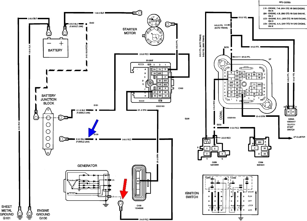

So, my alternator was not charging, I changed it and still not charging. The battery light comes on, somebody said there's a voltage regulator external on top of the manifold next to the distributor. I can't figure out why it won't charge. can anybody help me please?

Does the "Battery" light turn off once the engine is running? What are the symptoms?
There is no external voltage regulator. It's built into the generator.
First we need to know if the fuse link wire is okay. Measure the voltage on the generator's output terminal with the engine not running. You can do this with a digital voltmeter or a test light. If you aren't familiar with either, check out these articles:
These tools are very inexpensive at Harbor Freight Tools, Walmart, or any hardware store. I can help with setting up the voltmeter if you need it. Measure the battery's voltage, also with the engine not running. You must find the same voltage there and at the generator's output terminal. If you find 0 volts at the output terminal, the fuse link wire is burned open, either from the old generator was shorted or a metal tool touched that terminal and a metal part of the engine at the same time while the battery was connected. I'll describe how to replace that fuse link if necessary.
If you find 12.6 volts at both places, the battery is good and fully charged. If you find closer to 12.2 volts, it is good, but fully discharged. It should be charged at a slow rate for a few hours. Next, measure the battery's voltage again with the engine running. Now it must be between 13.75 and 14.75 volts. If it is, that is only the first part of the test that shows it is okay to perform the rest of the tests, but those require a professional load tester. You'll need to visit a repair shop for that.
