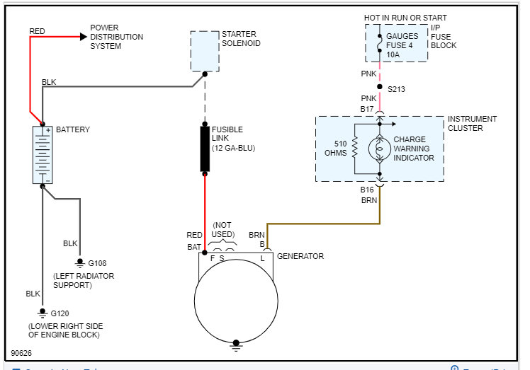

I am having trouble with my 98 astro keeping the battery charged. I have replaced the alternator twice and it has a new battery as well. weird thing about it is the battery will charge most of the time when its at idle, but voltage drops when there is a load on the motor. on the highway the drop is down to 10 to 12 volts and killing the motor. I was suspicious of the fuel pump. could a bad pump cause this type of problem? I can hear the pump go up and down at the same time the voltage changes. seems to me like the battery should charge more at highway speed than at idle. but it's opposite. I really don't even know where to start.

There are a number of things that can cause this. So, let's start at the beginning as if you have not done anything.
Let's get the battery and alternator tested so that we can rule that out for good. Just replacing them at some point in the process does not mean that they are good parts so before we dive into test the rest of this, we need to rule that out for good.
Assuming they are both passing these tests then we most likely have a wiring issue where we have high resistance in the wiring, and it is not able to carry the load that the engine and electrical system needs at times of higher demand.
So, this means each of the wires going to the alternator needs to be load tested or resistance checked. I would not use a light bulb to load check them as we need to get a definitive measurement and trying to judge the brightness of a bulb is not definitive.
On this vehicle this testing is going to be easier because you only have two wires. So, we need to disconnect the wire from the starter and battery and then measure the resistance from the battery connection to the starter. Then from the starter to the alternator with it unhooked from the alternator as well.
Both readings should be less than a half ohm. If they are then we need to inspect the connections at each point on this circuit.
Then do the same for the circuit on the indicator. As you can see this indicator gets turned on based on a resistor so if there is resistance in the wire then that could falsely turn the light on.
Please let us know what you find or what questions you have. Thanks

Yep, that wire is important, I opened up the connector and soldered the wire back onto it and it's working perfect. Thanks for all the help.

Suggested Repair
After confirming the battery and alternator pass load tests, check the charging cables for high resistance and poor connections. The fault was a loose wire in the connector; soldering it back restored charging.
Conversation Summary
A 1998 Chevrolet Astro would charge at idle but voltage fell to about 10-12 volts under load or on the highway, stalling the engine. The alternator had been replaced twice and the battery was new; the owner also noticed the fuel pump noise changing with voltage. The expert advised proper battery and alternator tests, then resistance checks of the two charging wires and connections, expecting less than half an ohm. The owner found a wire loose in the connector, soldered it back, and charging worked normally.
