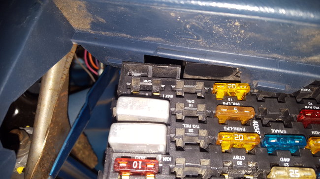

so my truck battery won't charge. i have replaced battery, alternator checked grounds, added grounds still can't get battery to get a charge.

STENNY
  • 13 POSTS
yea it is a little less between the 2 but i can't figure out why i ran a new wire from alt to battery and that didn't help anything. i believe its the gauges. but there is also a battery fuse which has no power going to it. and i recently had battery to starter wire arc out and touch metal and melt wire and kill old battery ever since i have had charging issue it seems like battery connects to start the truck then when truck is running alt is running everything on truck but not charging battery because when i shut down the truck it has same power it did before engine started

STENNY
  • 13 POSTS
It was actually not battery fuse it was crk whatever that is

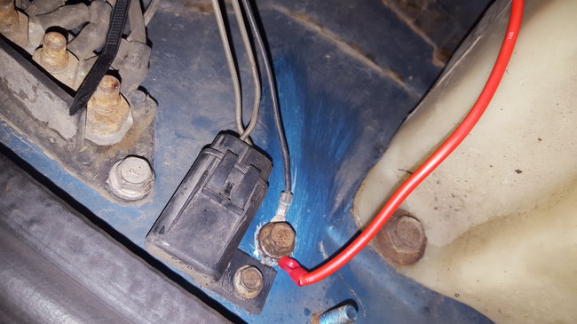

STENNY
  • 13 POSTS
What does this black box on firewall that had a fuse inside goto? I checked fusible links they all seem good

  • 55,743 POSTS
That is a system fuse, are all the fuses in the fuse box that need to be? sounds like you have one missing
