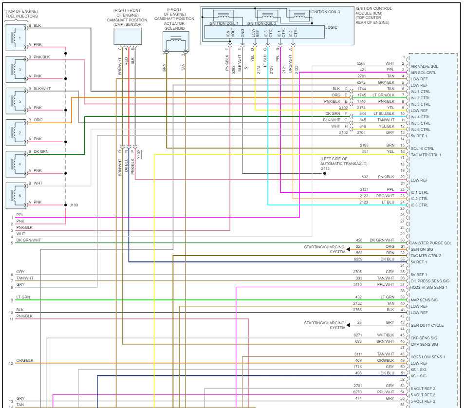

Code p0641, could it be a bad alternator?
127,000 MILES • 5 CYL • AUTOMATIC
ROBERT D GRAY
  • 5 POSTS

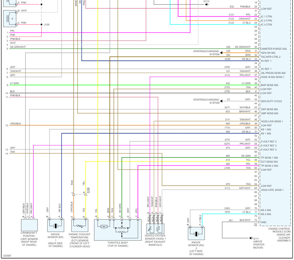

Can a bad alternator cause code p0641 on my car?
Sep 4, 2023 at 1:13 AM
  • 55,721 POSTS
Do you have any other codes? If the engine runs let's check the alternator output, this guide can help:

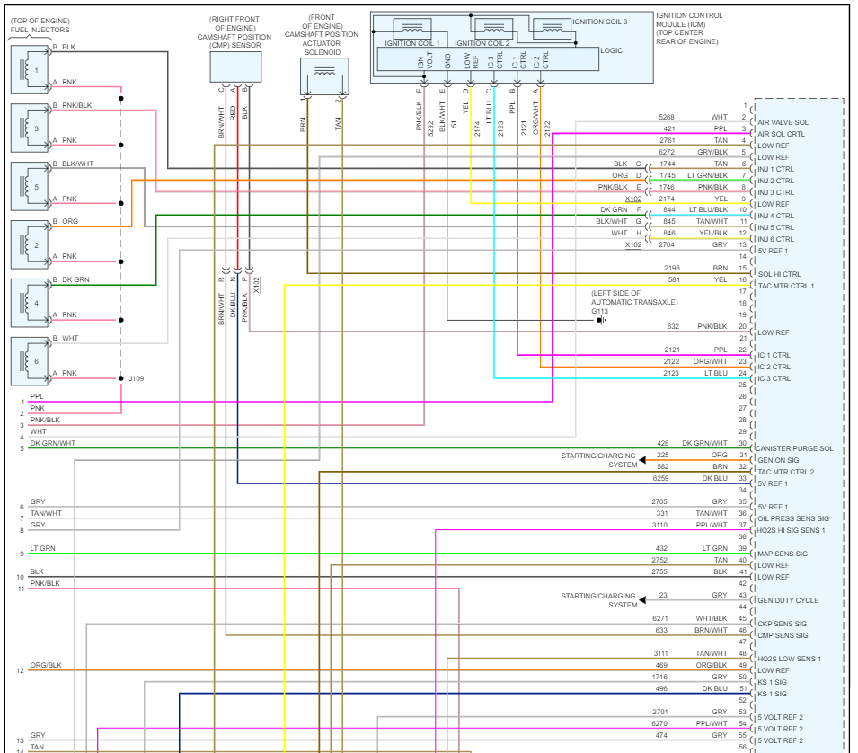

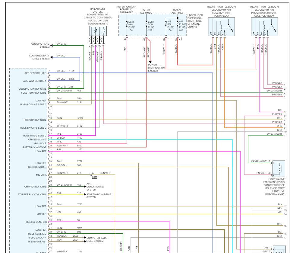

With the system on test the 5-volt references to each sensor and look for the one that is low and replace that sensor. This guide can help, and I have included the engine PCM wiring diagrams so you can see how the system works and which sensor wires to test.
code P0641 "Sensor Reference Voltage 'A' Circuit/Open."
Check out the images (below). Please let us know how it goes.
