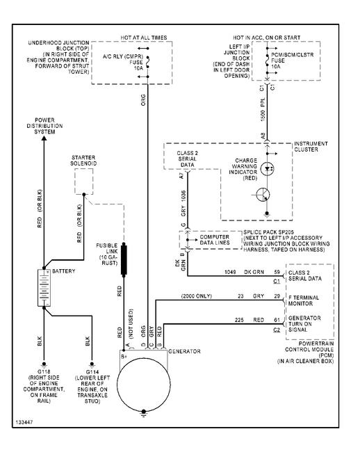

My starter goes out, I replace it, then my battery light comes on, and my battery runs dead. My alternator needs to be replaced, but when I replace it, it won't recharge my battery. I bought a new battery and alternator at that point, but my battery dash light still comes on,. I suspect there is a fuse linkage between the alternator and the positive terminal on the battery but I cannot find it. Is that my problem here?

it may be running off the starter it's arust colored wire and connects to ared wire. tha tmay be burnt or just a coulpe of strands connected. also check fuse a/c underhood and pcm in dash

HERE'S A DIAGRAM FOR THE CHARGING SYSTEM FOR YOUR RIG---LOCATIONS ARE USUALLY MARKED ON WHERE THE COMPONENTS CAN BE FOUND
GOOD LUCK!
KEEP US UPDATED
