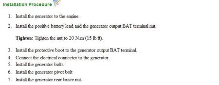

i need installation instructions for the alternator

https://images.2carpros.com/forum/automotive_pictures/261618_Noname_1456.jpg

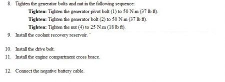

https://images.2carpros.com/forum/automotive_pictures/261618_Noname2_426.jpg
