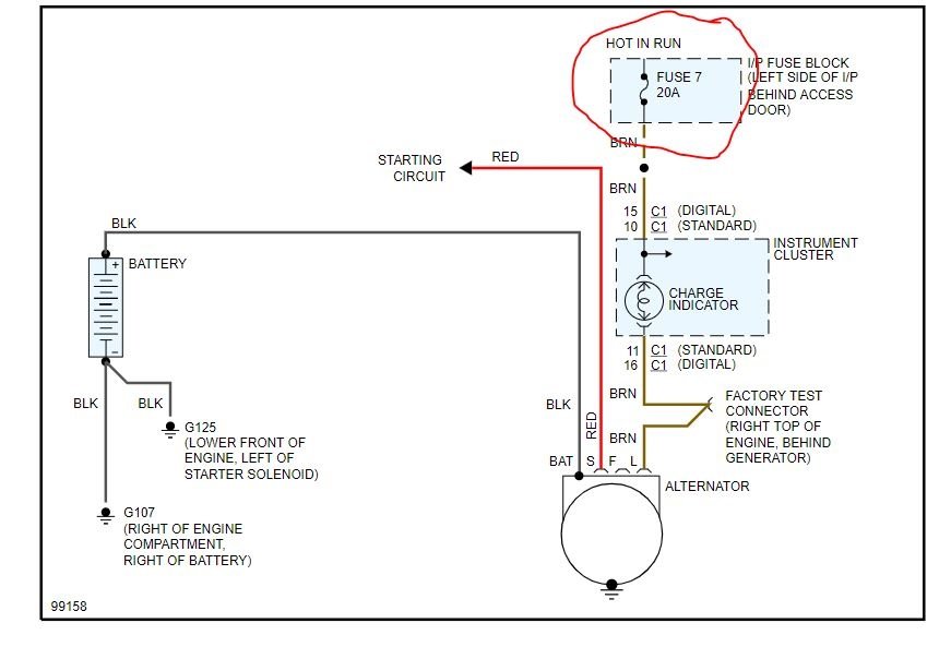

New battery new alternator and not charging. got another new alternator and still not charging. could ECM be causing this?
Mar 27, 2021 at 7:04 PM
Good morning,

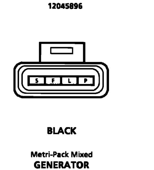

You will need to do some voltage checks at the alternator. I wire from the batter must have 12.4 to 12.6 volts and the brown wire must have the same with the key in the on position.
Check the fuse I circled for power on both sides. The battery light should come on with the key on as well.
