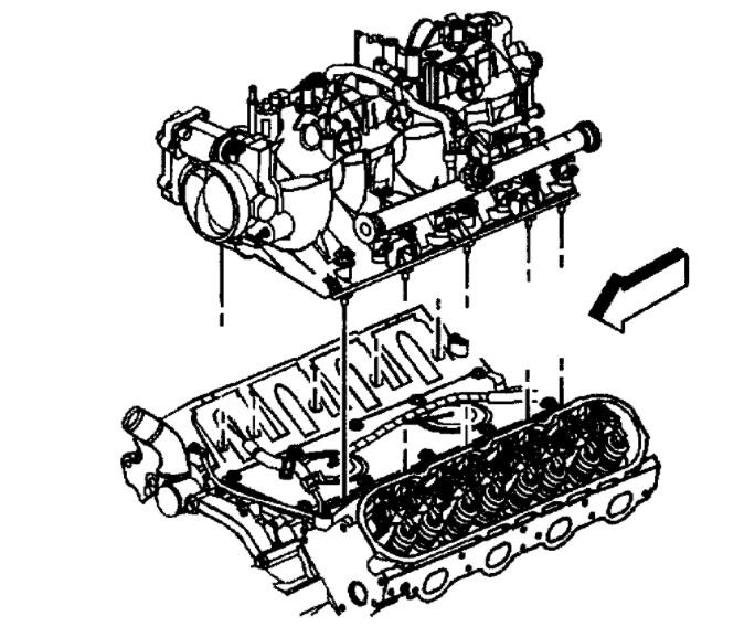

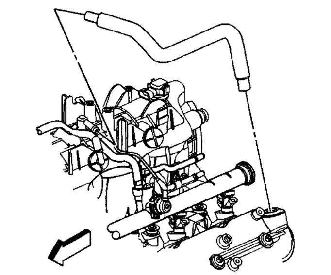

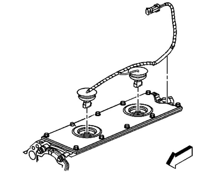

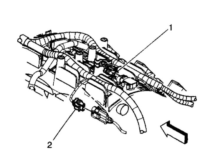

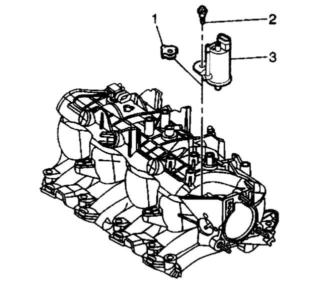

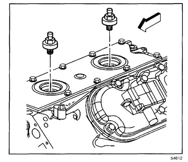

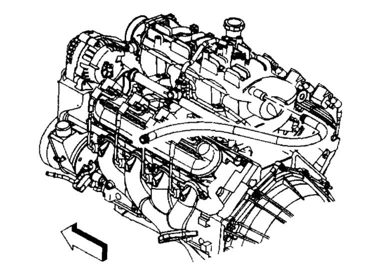

REMOVAL PROCEDURE
1. Remove the intake manifold.
2. Gently pry up the rubber covers.
3. Disconnect the knock sensor electrical connectors.
4. Remove the knock sensors.
Intake Manifold Replacement
Removal Procedure

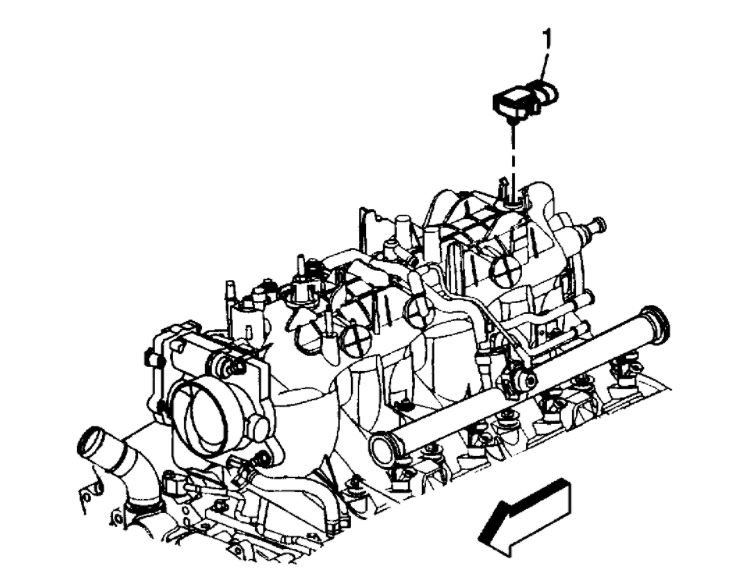

Important:The intake manifold, throttle body, fuel rail, and injectors may be removed as an assembly. If not servicing the individual components, remove the manifold as a complete assembly.
1. Remove the throttle body.
2. Remove the fuel injectors.
3. Disconnect the following electrical connectors:
Manifold Absolute Pressure (MAP) sensor (1)
Knock sensor (2)
4. Remove the knock sensor harness electrical connector from the intake manifold.
5. Set the electrical harness aside
6. If equipped with vacuum assisted brakes, remove the vacuum brake booster hose from the rear of the intake manifold.
7. Remove the Positive Crankcase Ventilation (PCV) hose with valve.
8. Remove the MAP sensor (1) from the intake manifold.
9. Remove the evaporative emission (EVAP) purge solenoid vent tube by performing the following:
9.1. Remove the EVAP tube end from the solenoid (1).
9.2. Remove the EVAP tube end from the vapor pipe (2).
10. Remove the EVAP purge solenoid bolt (2), solenoid (3), and isolator (1) from the intake manifold.
11. Loosen the intake manifold bolts.
12. Remove the intake manifold.
13. Remove the intake manifold gaskets (1) from the intake manifold.
14. Discard the old intake manifold gaskets.
15. If required, clean and inspect the intake manifold.
