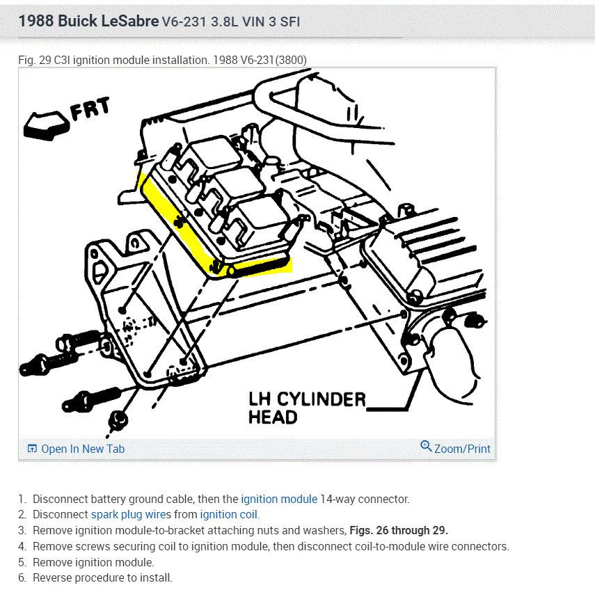

JOEL KING
  • 7 POSTS
I did the starting fluid... Nothing... I did the jumper wire again... And again the #12... Obviously, there's something wrong... Why won't it show a code for it? And where do i start? I'm going to pull a plug now.
Mar 31, 2022 at 9:27 AM
  • 110,236 POSTS
Hi:
If you have no spark, it is likely related to the sensor you installed. Check for spark. If there is none, go back to the sensor. Get a replacement and see if that makes a difference. Also, if by chance you got the sensor online, try getting one from a parts store. I am seeing so many issues with online parts, especially electrical parts.
Also, the ignition control module may have failed. If there is a tachometer in the vehicle, see if it moves a little when cranking. If it does, then the crank sensor is likely okay and the module has failed. I attached a pic below showing the module. It is what the coils bolt to. If you remove it, a parts store should be able to test it for you.
Mar 31, 2022 at 10:48 AM
