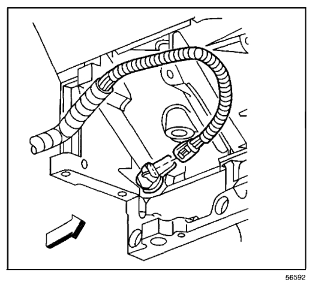

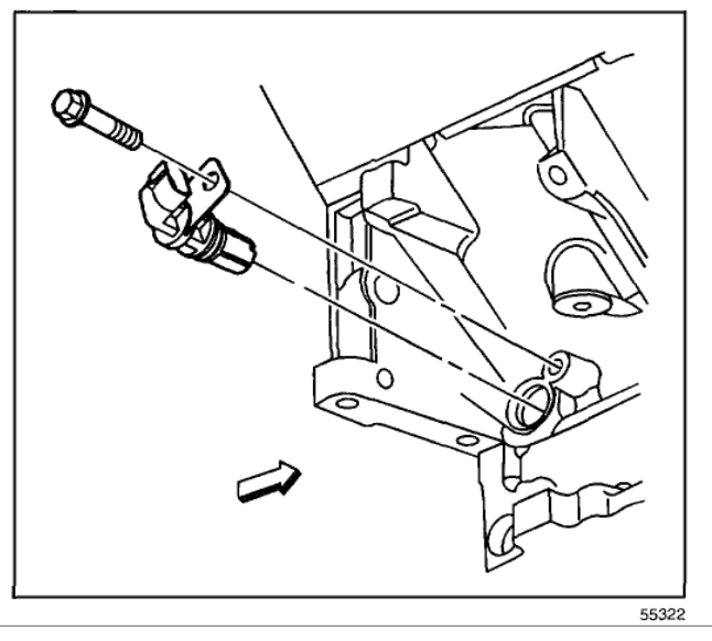

  • 55,851 POSTS
When the engine does not start do you have spark? If not these cars had a problem with the crankshaft angle sensor going out. Here is a guide that will show you how to change it out.
and
