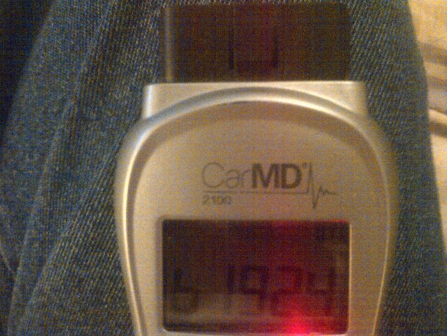

my scan tool gives me code b1924. Can you please tell me why? Also, how to fix it?

B1924 is a fault in the power feed to the SRS system. A common issue would be bad battery connections or a blown SRS fuse. Beyond that it is usually an internal fault in the SRS module itself, the repair for that is a new module.
