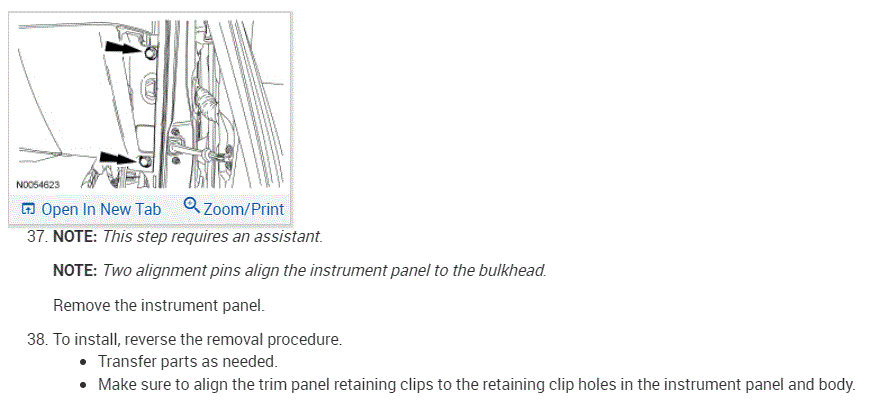

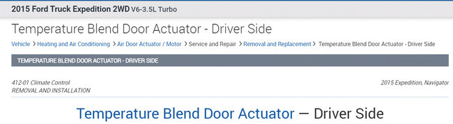

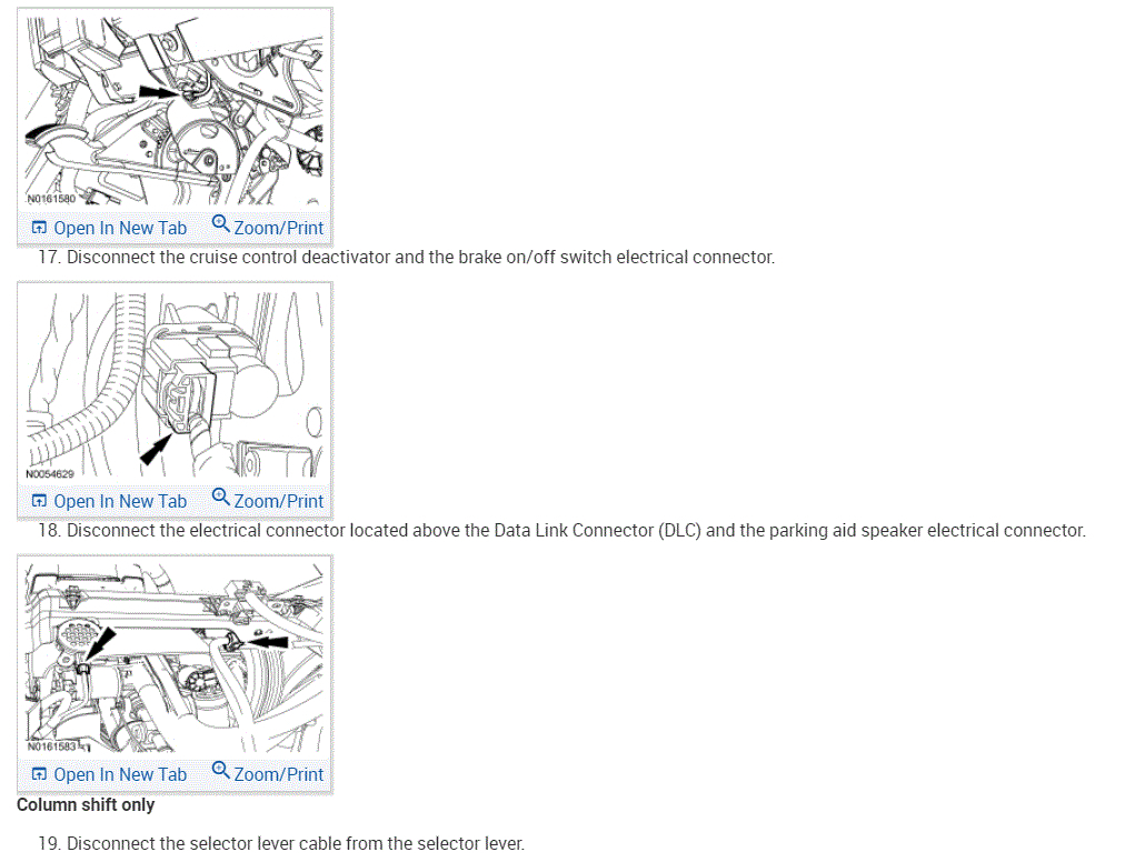

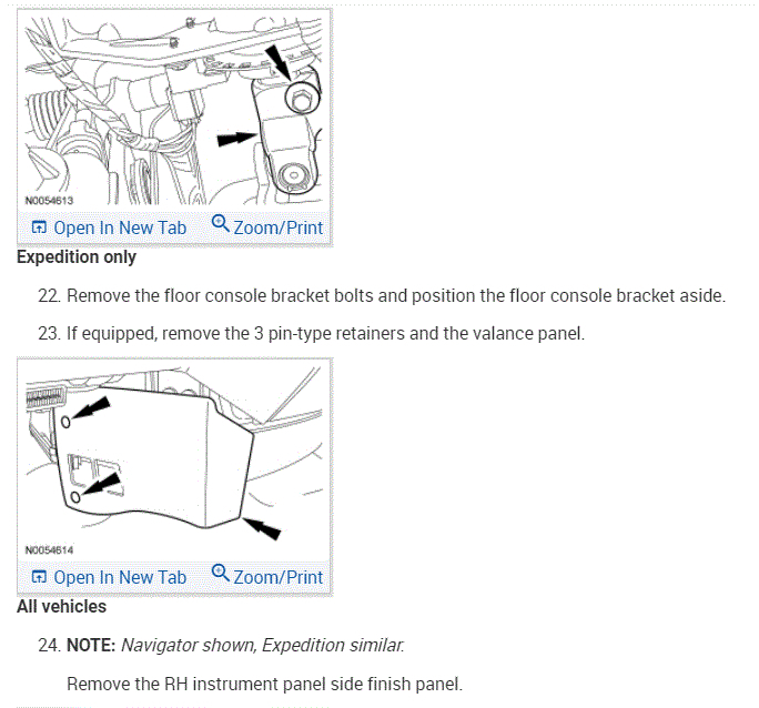

My air conditioner is knocking when changing positions; defrost, high, low, etc. The right-side actuator appears to be behind the glove box area. Do you have instructions for the left side actuator? Thank you in advance!
Apr 19, 2022 at 10:33 AM
  • 110,244 POSTS

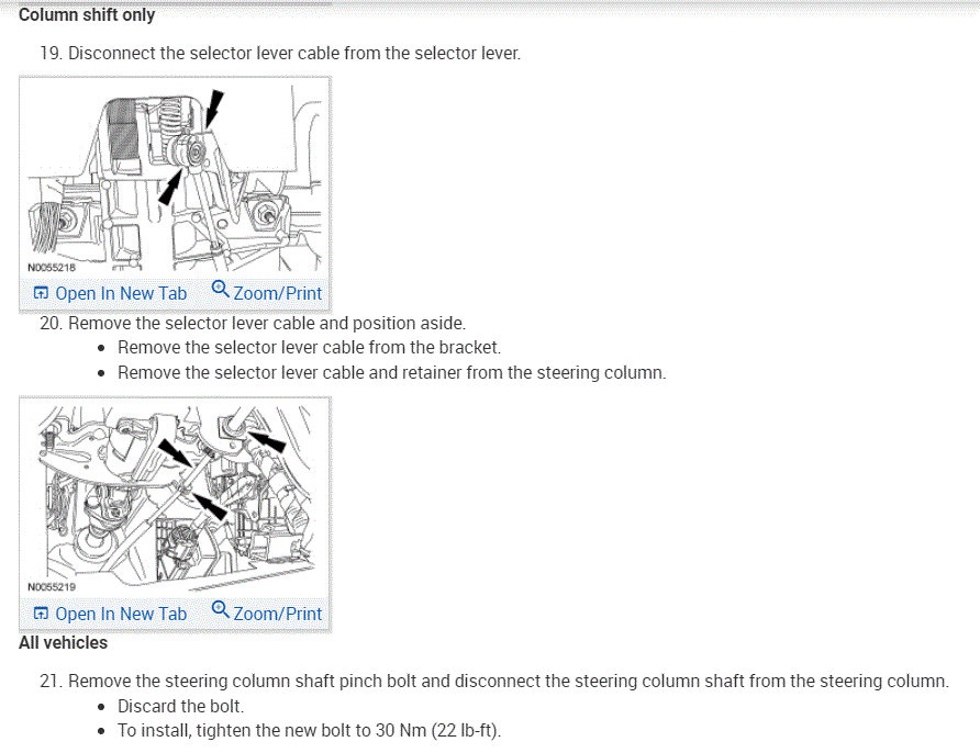

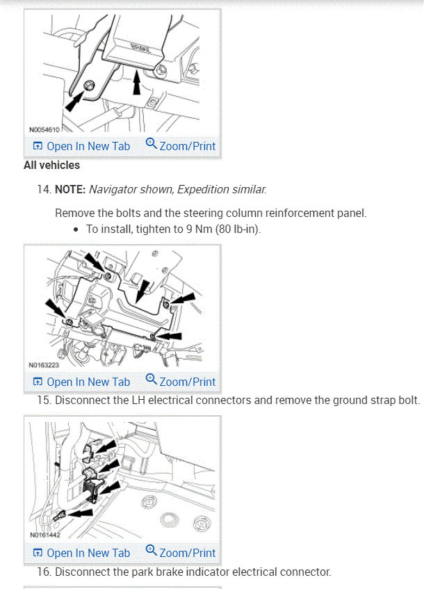

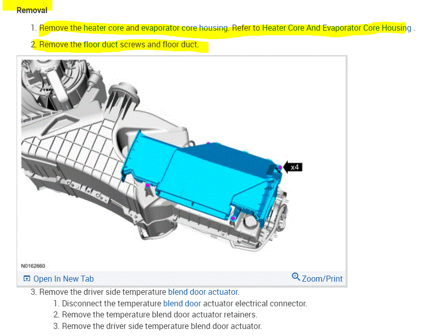

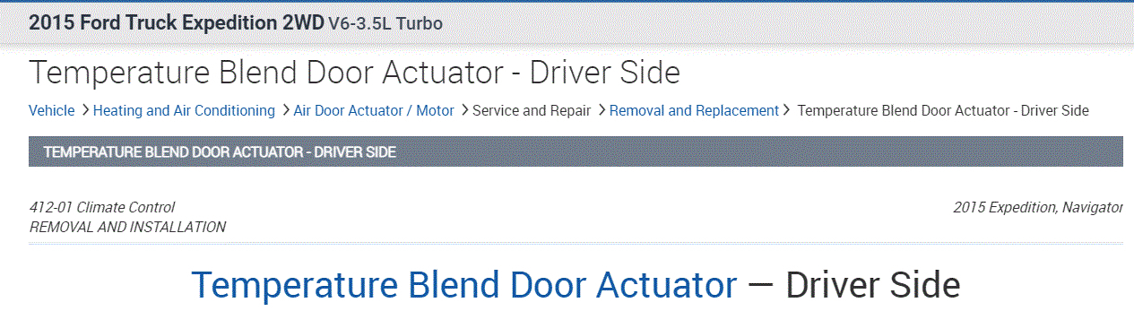

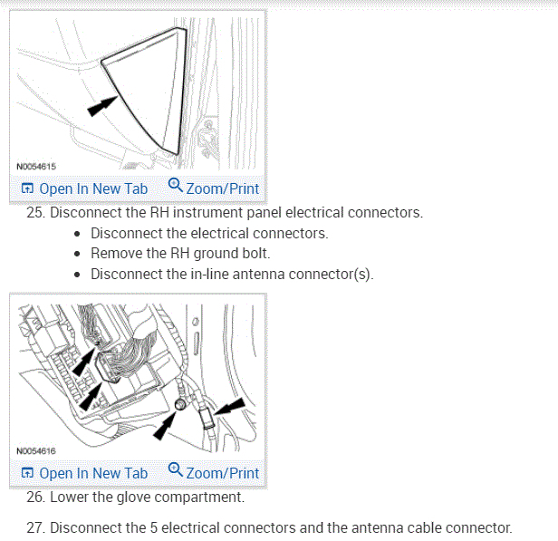

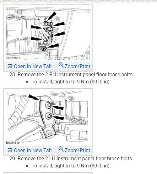

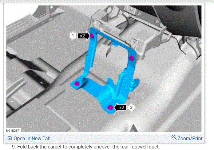

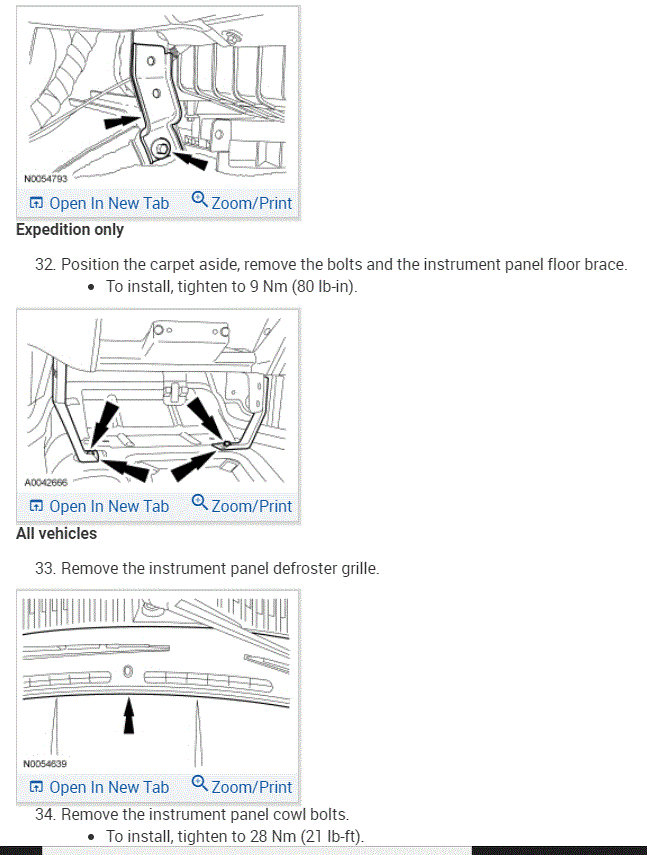

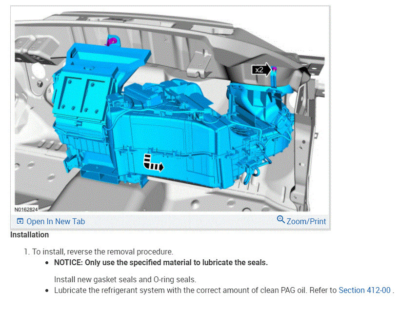

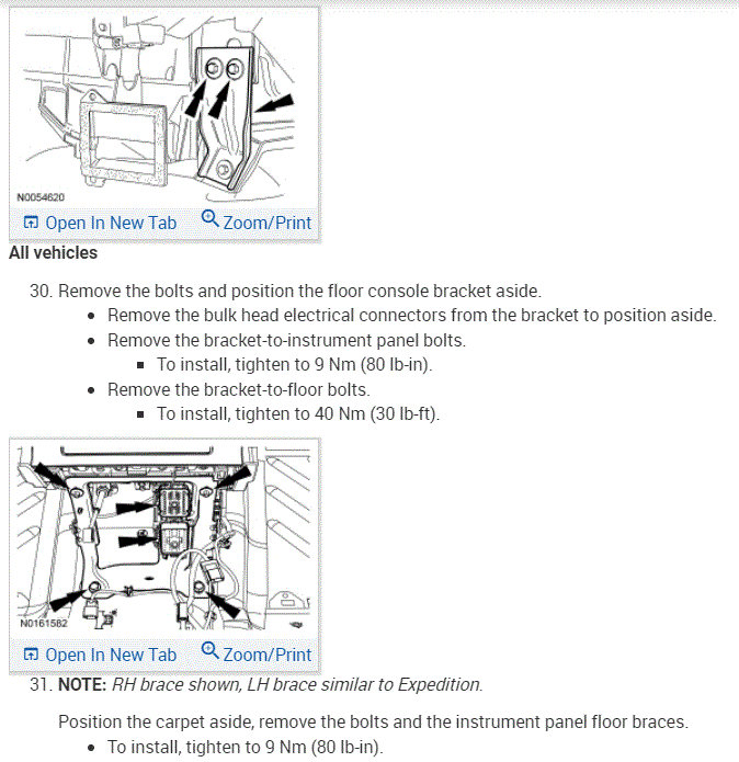

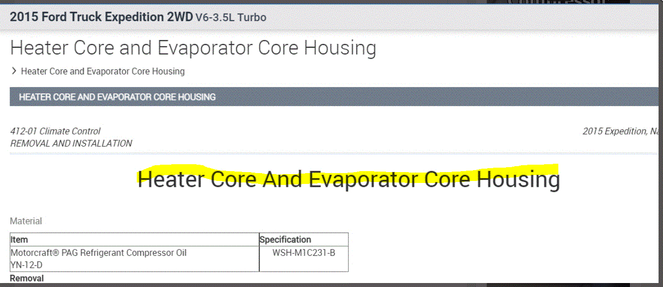

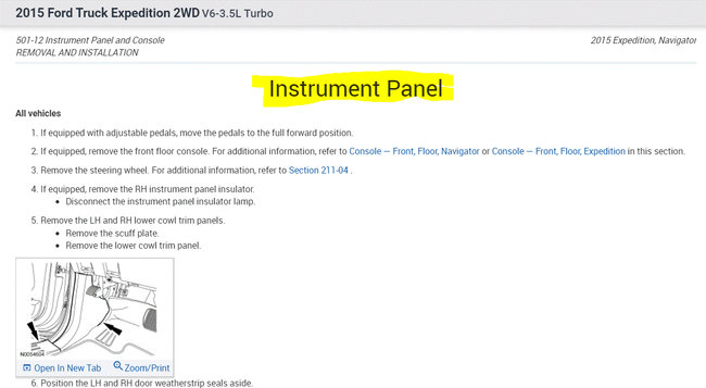

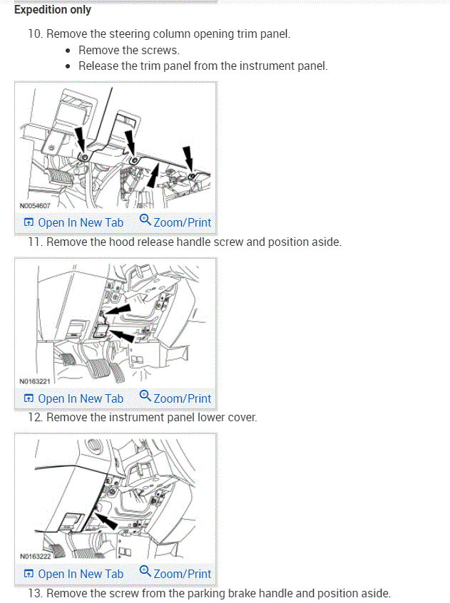

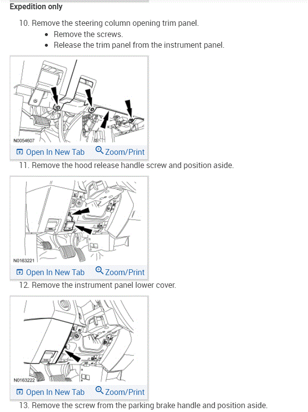

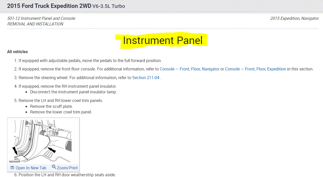

I looked up the directions for the driver's side blend air door actuator. I feel bad giving you the directions. LOL, I have no idea why things get designed like this but do me a favor. Look at the first three pics, specifically pic 2. Note what I highlighted.

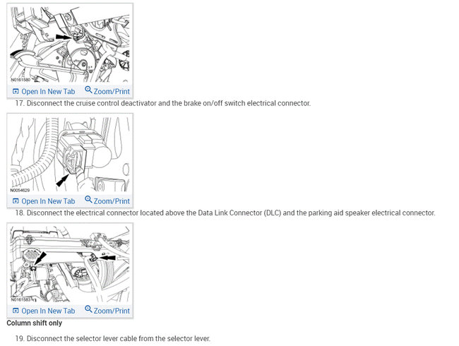

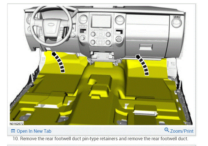

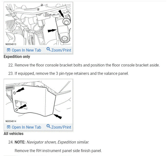

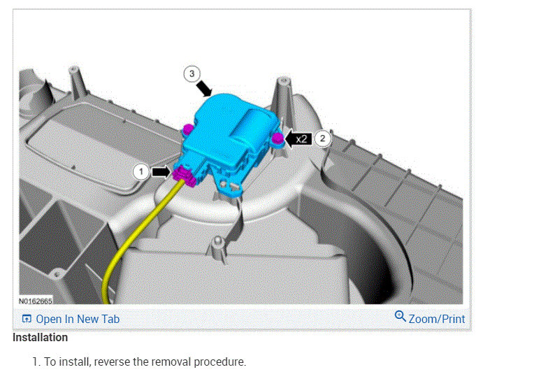

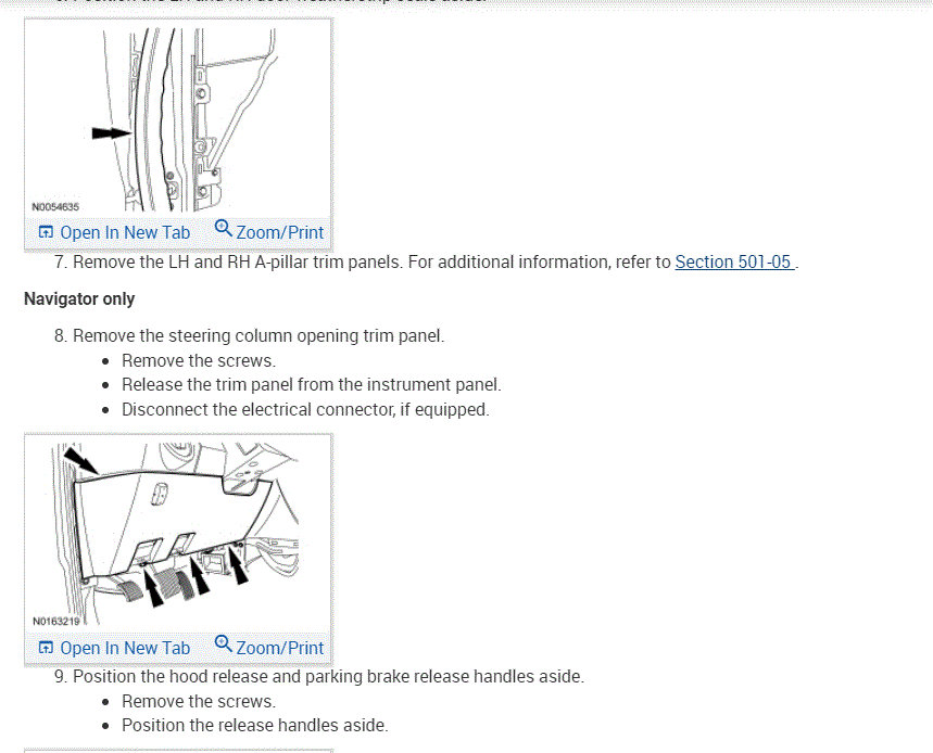

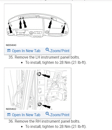

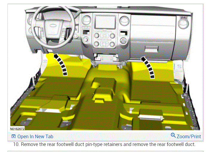

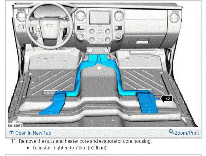

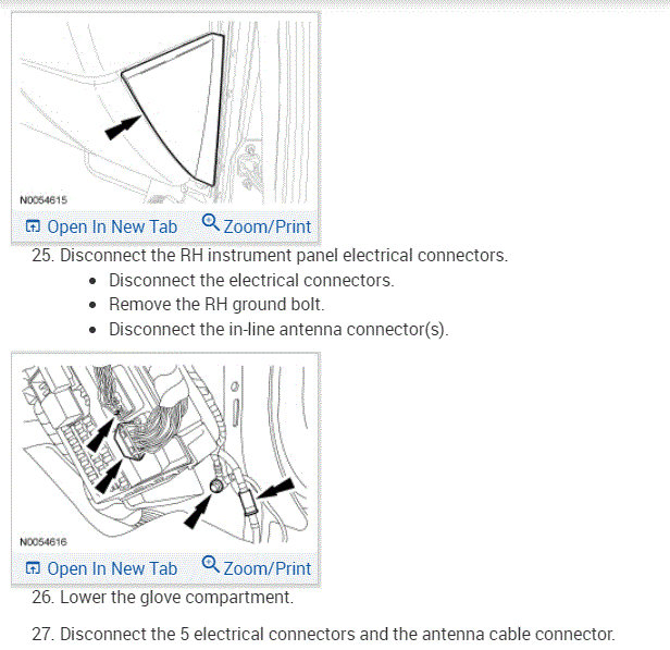

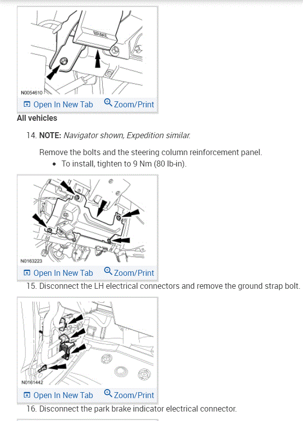

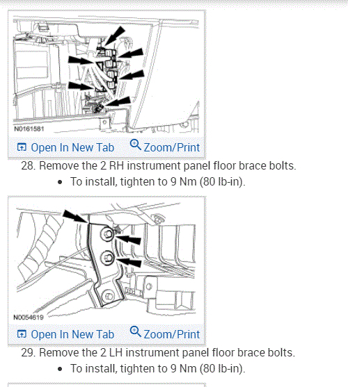

With that, pics 1. 2. and 3 are the directions for actuator replacement. The remaining pics are for gaining access to the actuator. You will need to drain the coolant and recover Freon from the A/C system, remove the front seats, and the dash.
I personally haven't done one on a 2015, but I would be looking for an easier way to access it.
Let me know if you have questions or anything I can do to help.

Thank you. It appears it is not as easy as the online videos saying to take the dash out and change the $50.00 part out.
