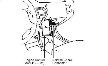

When engine cuts of, was it easy to restart?
Since CEL had showed, there should be a Diagnostic Trouble Code stored in the ECM. Bridge the SCS connector and turn ignition switch ON. Count the blinks of the CEL and let me know what you find.
Long delay flash = 10.
Quick blinks = 1.
https://www.2carpros.com/forum/automotive_pictures/192750_SCS95Integra_2.jpg
