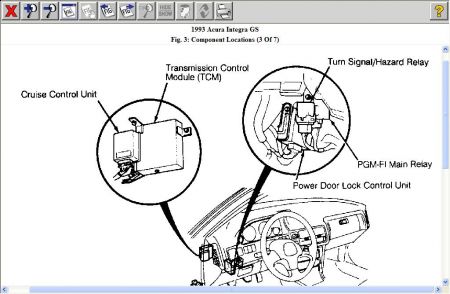

after sitting for 8 or so hours, my car will try to start then die suddenly. It will not start, but will turn over. I have to spray starting fluid in it to get it to start, once it starts, it runs beatifully, what causes this?

Seems you have a fuel problem and the symptoms described usually are caused by a bad PGM-FI main relay.
https://www.2carpros.com/forum/automotive_pictures/192750_PGMFIRelay93Integra_4.jpg
Remove the relay and check the circuit board for cracked solders at joints, resoldering them should colve the problem.
If the Check Engine Light does not go off after 2 seconds, then it could be the relay or the ECM. If the relay does not solve the problem then you would be looking at a rebuild of the ECM or a replacement part.
