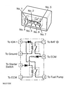

Okay, so I now have power in my main relay. Slot 3 (ECU 12, 15) on the main relay only has five volts though all other read 12. Xx. With the key on. With the key off slot three reads negative.3.
I also checked power in the fuses under my hood all have twelve volts. None are blown. But for some reason my pump is still getting no power. What would be the next step? Would I have to check my ECU wiring? Also I had an extra main relay so I jumped 5-7 together. Ignition and fuel pump with solder. Still no power with that. I have a jumper fuse hooked to my radio on my kick panel and I jumped a thirty amp fuse to my fuel pump straight wire and it comes on.
Tuesday, January 24th, 2017 AT 8:27 PM
KHLOW2008
  • 41,814 POSTS
Hi 77593DA,
Here is the schematic of the main relay. I would like you to use it to describe what you have and do not have.
https://www.2carpros.com/forum/automotive_pictures/192750_MainRelayHonda_1.jpg
With ignition switch turned on, the Fuel pump supply will only be for two seconds.
With ignition switch turned to "on", grounding Terminal one should have power to fuel pump, if none, the relay is bad.
