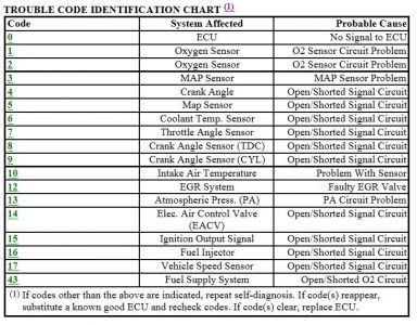

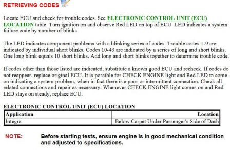

You can read the codes from the ECU.
https://www.2carpros.com/forum/automotive_pictures/192750_Code90Integra01_1.jpg
https://www.2carpros.com/forum/automotive_pictures/192750_DTC90Integra_1.jpg
Tuesday, March 31st, 2009 AT 8:16 AM

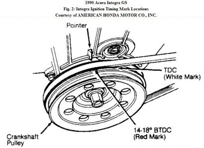

The water in the exhaust was just condensation, and it was brown due to the rust inside of the pipes. I did a compression test and it showed 145 in cyl 1 and 2 and 135 in cyl 3 and 4. How much should I have? I know I have to do a valve adjustment, but im gonna do that after I finish the timing. I just figured out what made the car run bad when it warmed up. It was the ignition timing. I rotated the dist. While it was running rough and it jumped right back up to idle. I have a timing light and tried to set the timing. I can not find the marks on the crankshaft pulley. I might have rubbed them off by trying to use a chain wrench to pull the pulley off a while back. The chain wrench broke, so I ordered the special tool to take it off. My question is how do I set the ignition timing without marks on the crankshaft pulley. Or what do you think I should do.
Wednesday, April 15th, 2009 AT 8:53 AM
KHLOW2008
  • 41,814 POSTS
Without any marks, it would be impossible to get the correct timing.
Recheck the pulley, the timing marks were edged onto the rims and should not be erased unless you have ground them off.
Next best thing is to turn 1st cylinder to TDC and mark on the pulley yourself. This would not be 100 % but at least it would get you as near to the timing as possible.
Wednesday, April 15th, 2009 AT 9:08 AM
JSL129
  • 23 POSTS

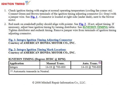

If I can find the marks, what mark or deg should I set it at? I am told that there are a few different marks. And an arrow that points to the mark I am currently at. Where is the arrow?
Wednesday, April 15th, 2009 AT 9:28 AM
KHLOW2008
  • 41,814 POSTS

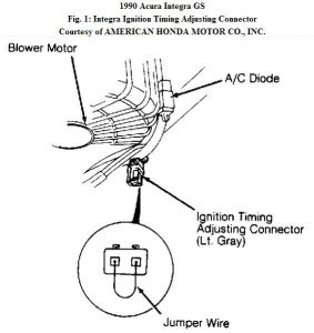

Here are the Ignition timing marks and adjusting procedures.
https://www.2carpros.com/forum/automotive_pictures/192750_IgnitionTiming90Integra_1.jpg
https://www.2carpros.com/forum/automotive_pictures/192750_TimingAdjusting90Integra_1.jpg
https://www.2carpros.com/forum/automotive_pictures/192750_TimingMark90Integra_1.jpg
-1
Wednesday, April 15th, 2009 AT 10:02 AM
JSL129
  • 23 POSTS
What is the point of the jumper wire? What does it do? Can you do adjust the timing without using a jumper wire?
Wednesday, April 15th, 2009 AT 10:16 AM
KHLOW2008
  • 41,814 POSTS
The jumper would prevent the ECU from readjusting the idling speed which would cause inaccurate timing. Without it you need to stop and restart engine each time you make an adjustment.
Wednesday, April 15th, 2009 AT 10:44 AM

What does the mark signifly on the crankshaft pulley? Is it when cyl#1 is at TDC? My mark has rubbed off and I am having trouble timing my car. Can I put the crankshaft pulley at TDC for cyl#1 and then replace the mark on the crankshaft pulley? Or what do you reccomend?
Tuesday, April 28th, 2009 AT 10:39 AM
KHLOW2008
  • 41,814 POSTS
If you can get the TDC for # 1 cylinder, mark it as TDC at the timing cover pointer.
With an adjustable timing light, set it at 16 degrees and when engine is running, the correct timing is achieved when it shows at the pointer. Adjust accordingly.
Tuesday, April 28th, 2009 AT 12:27 PM
