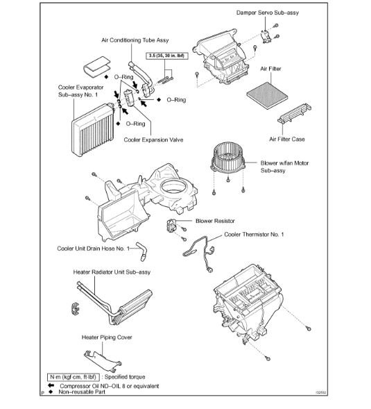

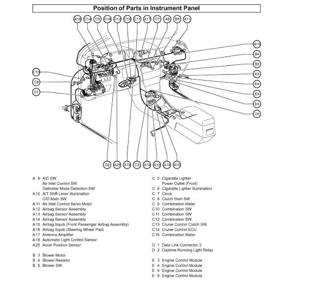

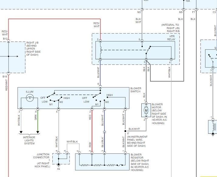

I bought this car used in the winter. The heat was working fine but slowly it became more difficult to get it to come on by turning the fan knob. Come spring the air conditioning was working great very cold lots of air coming through the vents all the sudden the fan speed knob only worked on low until it eventually stopped working. The AC button only lit up green sometimes now it does not light up at all. The other day I turned it on and it worked for like ten minutes then it just cut off now nothing. I changed the resistor and I changed the climate control module in the dash. Same problem fan speed knob doesn't work the re-circulation button lights up but not the AC button does not. I switched the relay with the horn to check the relay that was not it. I am at my wit's end trying to figure out what is causing this not to work. If anybody could help me I would appreciate it. I am trying to avoid the high cost of going to Toyota. Also, my friend checked the blower motor and it started running. Thanks

I would suspect the blower resistor as the seconday failure and the blower motor as the primary failure.
Too much current flow will damage and fail the blower resistor.

Yes, it could work that way but the motor may be drawing more current than the resistor can handle to make it operate. it can still work but be bad. you could replace the resistor and it may fail again in a very short period of time.

First, I would verify your fuses are good and there is power to the blower resistor.
If all that is good, then I would replace the blower motor and the resistor as an assembly.
The blower motor itself causes the high draw in the system.
