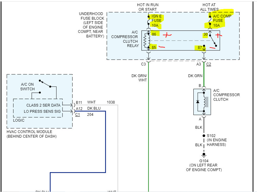

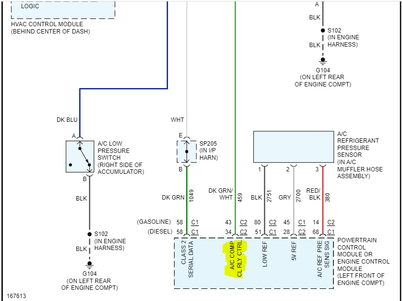

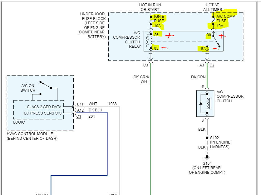

I attached the compressor clutch wiring schematic for you below. Yes, the solid dark green wire is the power supply to the clutch.
If you look at the relay, each of the 4 pins is numbered. Pin 30 should have power at all times. Pin 86 should only have power with the key in the run position. Pin 85 is what provides a ground path to complete the primary side circuit which actuates the secondary. When that happens, the dark green wire should power the compressor clutch.
Let me know if you have checked it that way. Also, here is a link that explains how to test a relay and its circuit:

When I’m doing all the electrical checks should the system be charged? I’m checking it without a charge. With key on engine off A/C button on all A/C fuses good but have no ground from PCM to relay. If system is charged will PCM ground relay? I also noticed the green/white striped wire for PCM ground was pulled out a bit from the black connector underneath engine compartment fuse box.
Please let me know if ac needs to be charged to see if PCM grounds relay.
Also, with key on engine off A/C button pressed I have ground at ac plug on black wire no power on green wire but have ground on green wire.
