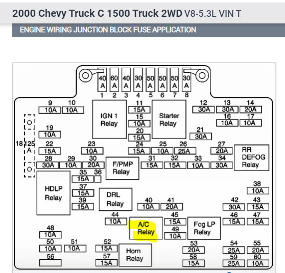

My husband started the truck and started smelling something hot/burning. He immediately shut it off and opened the hood to see smoke coming up from over by the ac compressor. He turned it off and let it cool back down and tried to start it up again with the fan on but the A/C off. He started hearing the ac compressor trying to kick back on even with the ac switch off. If we turn the whole fan off the problem seems to disappear. Also, it kind of looked like the headlights might have flickered. We are thinking it may be a problem with the A/C relay, but we don't have the tool to pull the relay out to check it. Would a bad A/C relay cause this problem?

The idea that the compressor was engaging with the A/C off is interesting and could be a relay issue. However, that wouldn't cause it to smoke. When you tried turning the A/C off and the compressor still tried to engage, could you have had the system set to the defrost setting? I ask because in the defrost mode, the compressor is actuated to dehumidify the air entering the vehicle. Try turning the heater on and the airflow fully on the floor setting to see if the same thing happens.
Next, when you saw smoke, did it smell like it could be something rubber burning? I ask because the compressor clutch, or compressor may be locking up and causing the belt to melt/smoke and smell like something is burning.
As far as the A/C relay is concerned, no special tools will be needed to remove it. It is located in the under-hood fuse box. I attached a pic below showing its location. Simply pull straight up on the relay and it will come out. If there is a different relay with the same part number, switch them to see if it makes a difference. If there isn't,

I question if the relay is the issue because if it was sticking on, the compressor would be engaged regardless of if the HVAC system is on or off. You indicated with the fan off, it didn't engage. That's what makes me question it. I think the belt was burning on a pulley that had excessive resistance or was locked. However, anything is possible.
See pic below.
