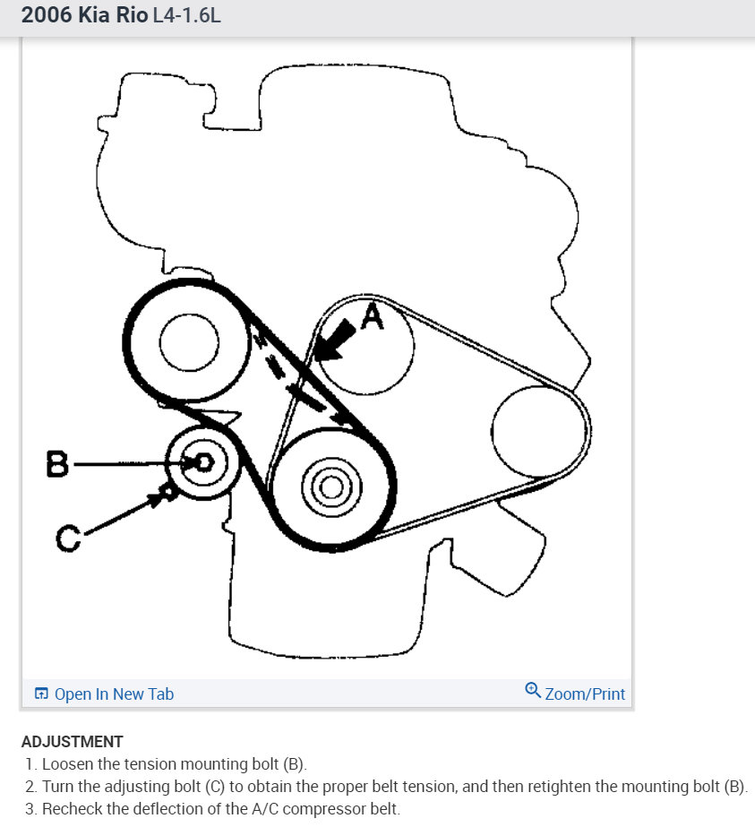

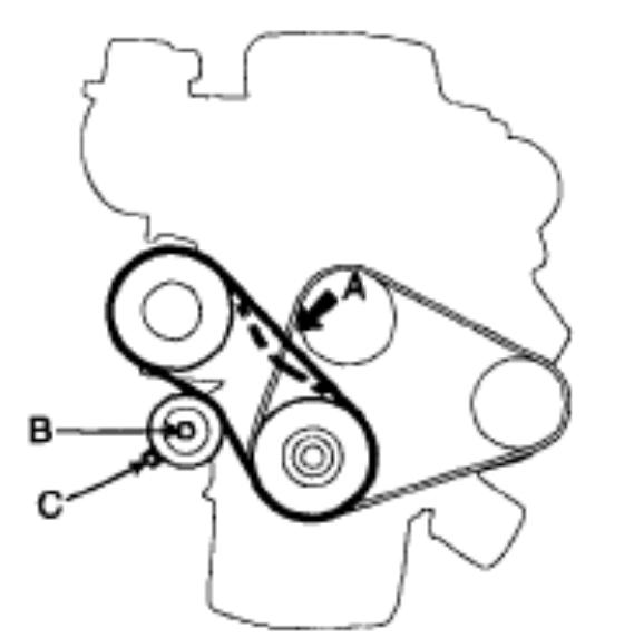

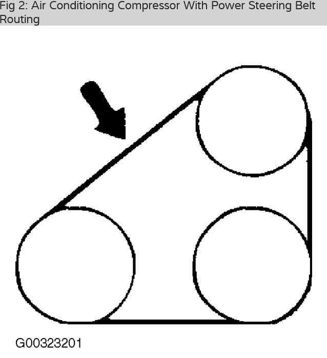

Hello SHAWNTAYAJ,

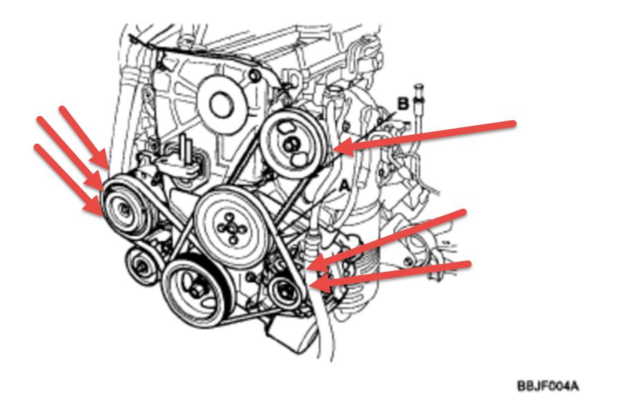

Please can you check the routing of the drive belts check fig1?
Let us know what happens with you. Check out the diagrams (Below). Please let us know if you need anything else to get the problem fixed.

The power steering belt is loose and worn. When the wheel is turned either way it squeals and seems to slip or jerk. How do I change this belt? Thank you.
+2
Friday, October 16th, 2020 AT 12:00 PM (Merged)
HMAC300
  • 48,601 POSTS
Which belt 1 arrow 2 arrow or 3 arrow or all of them? Check out the diagrams (Below).
+2
CGARCIA850
The arrows weren't numbered when I clicked on the picture but its the top right belt.
+2

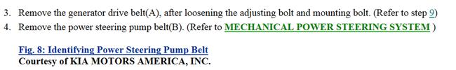

HMAC300
  • 48,601 POSTS

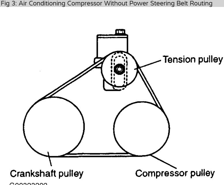

You will have to remove a/c belt first then generator belt see pics. Then look for an adjuster for the power steering as that is the one you want to change. Check out the diagrams (Below). Please let us know if you need anything else to get the problem fixed.

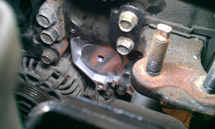

SCYALATA
  • 2005 KIA RIO
  • 106,000 MILES

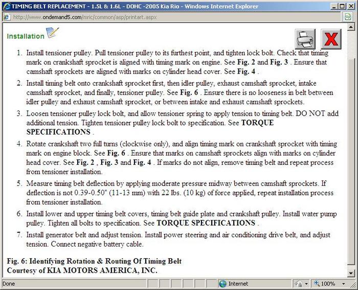

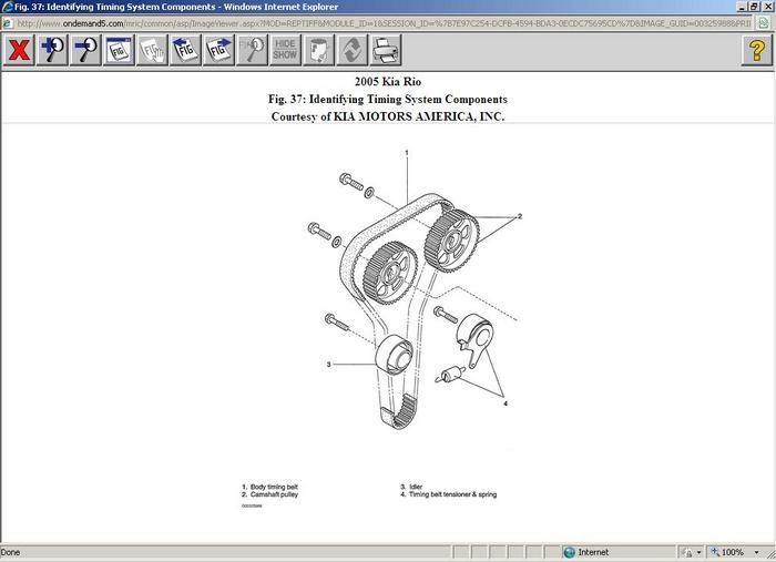

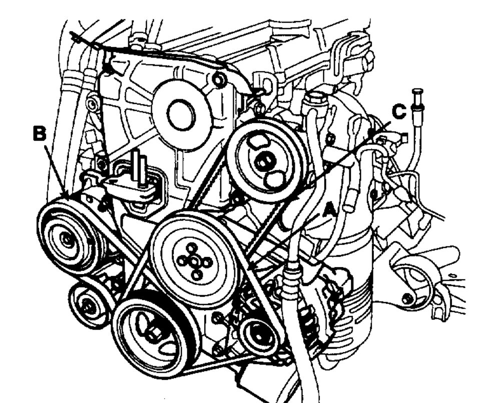

I bought this car and it needs a timing belt. I have replaced the water pump and I am currently trying to put everything back together. The tensioner pulley was off the car when I got it and I am not sure how to put the spring back on.
SATURNTECH9
  • 30,869 POSTS
I posted a diagram it goes from the hole on the arm of the tenisor to most likely the other side of the spring goes to a pin sticking up that is screwed into the engine. If you could post a pic that would be great.
SCYALATA
The only pin I see is the one coming out of the body of the water pump.
SATURNTECH9
  • 30,869 POSTS
Does that pin have a groove cut towards the end of it?Also does it line up with tenisor spring like I showed in the diagram I posted?

The pin in the picture doesnt have a groove, but I found the right pin. Does the spring go on before or after I put the timing belt on?
Friday, October 16th, 2020 AT 12:01 PM (Merged)
SATURNTECH9
  • 30,869 POSTS
I would just put the spring on and leave it on then repalce the belt. Glad to hear you got it all figured out If the spring makes the tenisor get in the way I pull the tenisor pulley out of the way and use the nut or bolt on the tenisor pulley to hold it in palce.

Im still having problems. If I put the spring on and pull the pulley out of the way as far as I can, then try to put the timing belt on I cant get it over the tensioner pulley.
HMAC300
  • 48,601 POSTS
Here is a guide to show you how to change all belts.

I posted how mitchell ondemand says to install the belt.

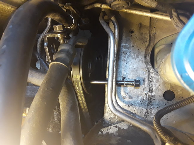

RFMEADOR
  • 5 POSTS
  • 2004 KIA RIO
  • 4 CYL
  • 2WD
  • 146,909 MILES

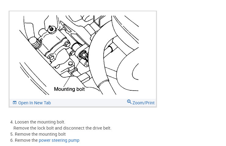

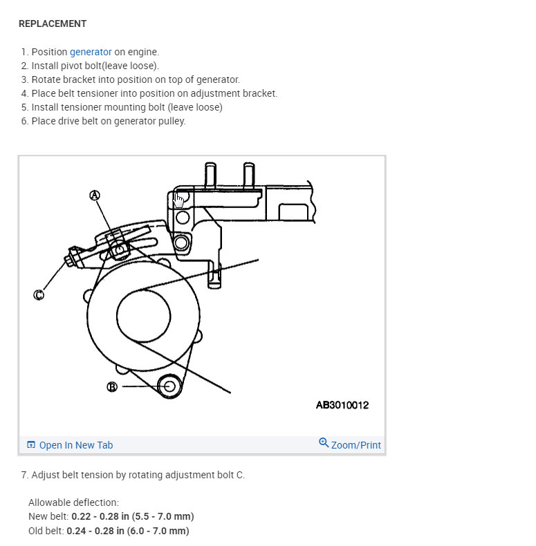

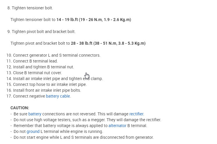

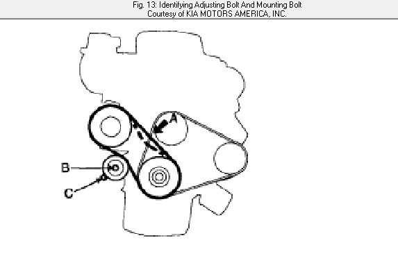

Need to replace broken alternator belt. Started to remove power steering belt first. Loosened tensioner completely but belt is still tight. Do I need to loosen the bolt behind the power steering pump pulley? When I get that belt off, will I have any steps on the alternator besides the tensioner? Thanks in advance.
That is correct. I attached the first attachment which shows the mounting bolt that you need to loosen and should be able to slip the belt off.
The next couple attachments show how to reinstall the new belt. Let me know if you have questions. Thanks

RFMEADOR
  • 5 POSTS
Thank you! Now, is there a secret on how to get the power steering bolt back in?
