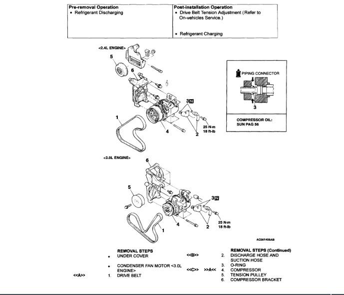

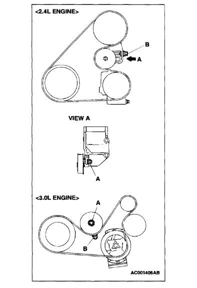

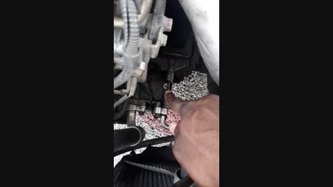

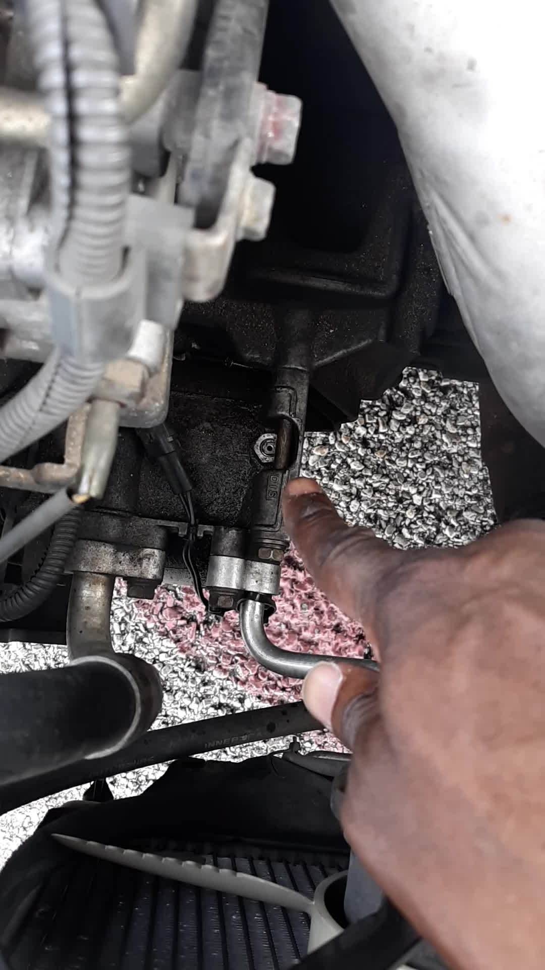

Freon is leaking from the top of the compressor from a tiny hole.
Jun 26, 2019 at 4:39 AM
Good afternoon,
That is the pressure relief valve for the compressor.
You need to replace the compressor.
https://www.2carpros.com/articles/replace-air-conditioner-compressor
