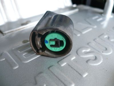

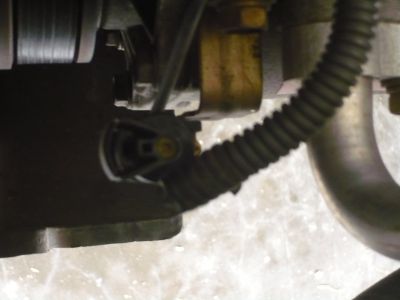

Thanks for your quick answer, it is very detailed and I appreciate that! The ground wire is separated from the proprietary plug that connects it to the clutch... I would believe that a manufacturing defect placed too much strain on the wire so that after 10 years of heat and cold the plastic coating became brittle and cracked causing the wire to pop out of the connector. Like some sort of stress fracture type thing. Yes, the entire system literally just didn't cool air one day, and I was thinking it was due to the fact that all of the original refrigerant is still in the system (there was no need for a recharge or anything it worked like new) and I am glad that you do not think the whole system is broken, and I am attaching a picture of the part to see what you would call it. How exactly would I be able to get ahold of that part? Would a salvage center allow me to cut it from the main harness, or could I potentially be able to order the part from my dealership? Let me know!
Thanks!
https://www.2carpros.com/forum/automotive_pictures/548797_P1030104_1.jpg
where the wire separated from the connector (right above the compressor)
https://www.2carpros.com/forum/automotive_pictures/548797_P1030105_1.jpg
view of the connector
https://www.2carpros.com/forum/automotive_pictures/548797_P1030106_1.jpg
the wire broke off inside the connector, ruling out the idea of a splice?
What to do now is the question XP

Yes and yes to the question of being able to get the part from the dealer and or salvage. Salvage yards dont care about stuff like that, they may not even charge anything. But it has to be the kind of yard that allows the customers to remove their own parts, as they will not keep nothing like that in their inventory. I believe its called, compressor signal plug. (Not too good with names of the electronic parts).

Ok I think it is the magnetic clutch connector
