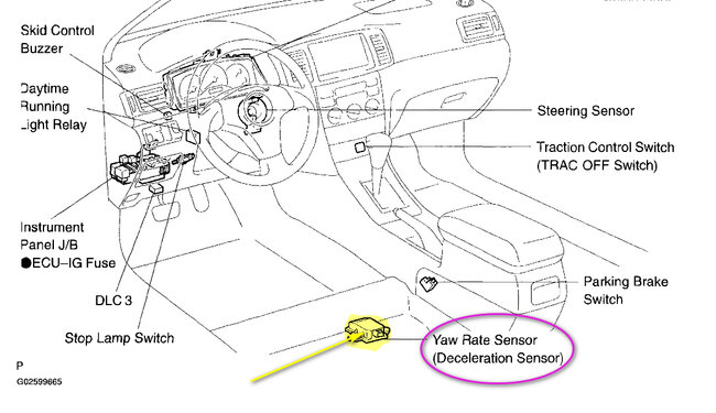

Changed skid control unit, the ABS light came on. I found code C1418 after diagnosis, but can't locate the deceleration sensor.

The deceleration sensor is located under the driver's seat, see image 1 below.

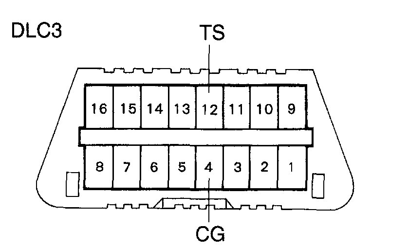

The DLC3 is the OBD port where you connect the diagnostic tool.
For a layout of the DLC see image 2 below

Using SST, connect and disconnect terminals TS and CG of the DLC3 4 times or more within 8 seconds., for a lay out see image
